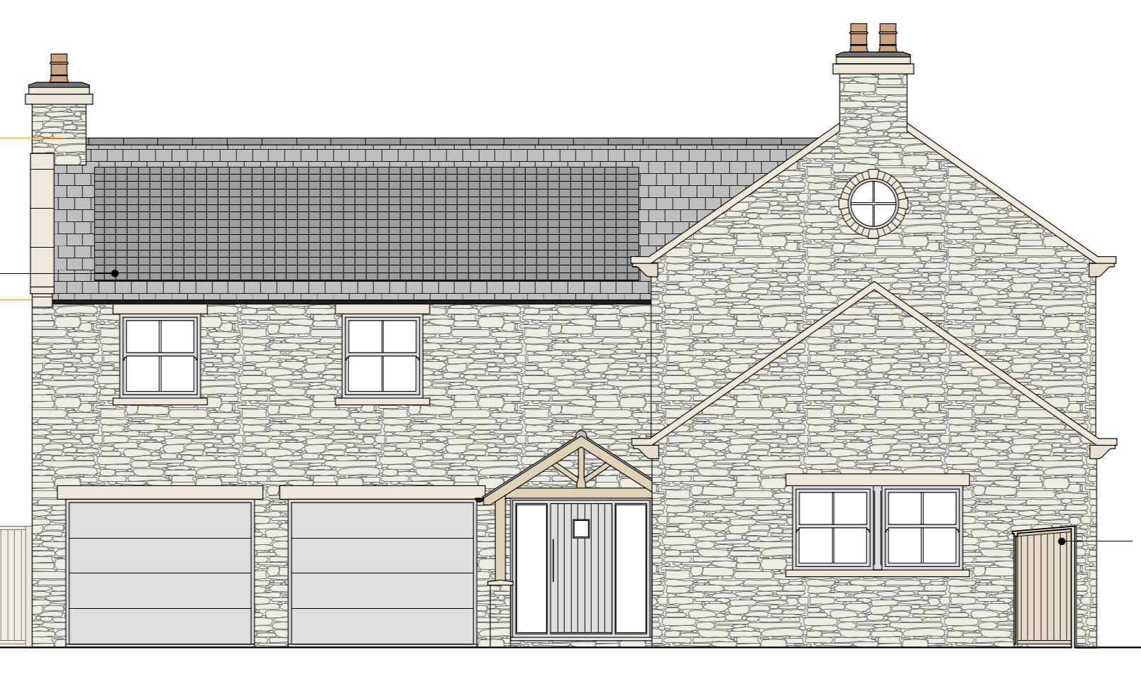

Here are some of my details to get you a bit further on in your thoughts. Remember though each job is different, copy blindly at your own risk! There is a lot behind these details, they are weaved into my SE design. Your hit an miss should work with the same detail with a bit of a teak to the breathable membrane. Anyway have a look and have fun, if they help you it will float my boat! Often design is about ruling things out, thus if the details below don't fly for you, then at least you know what you don't want! You're on a learning curve, it's ok now and always to be critical! It picks up what @JpManning is explaining, bot or not the points made are justifiable, language is very polished to say the least, but the English used comes straight out of a computer, make me wary! Setting @JpManning. Main things are the backward sloping bevel on the batten and as @JpManning says if you have gap in the boards to make sure it's black and UV proof. Also take note of the fire protection This is something that AI will end up dropping you in a pile of dung if you are not very careful, beware! Make sure if you have open cladding your detail lets water run out the bottom! The key to this is to make sure your builder does what it says on the tin! Do not cut corners! Expect to stand over them and make sure you are getting what you are paying for! This is just one of my details from a job of mine, other parts of the design cover other bits not shown here, so again, exercise caution. Sometime my details appear over and above what's initially perceived as required, or below the regs..I often design from first principles, thus if something falls a little short of the standard building regs I often make up elsewhere to make things buildable and more cost effective. Designers such as myself are allowed to propose other solutions, so long as they are equal / or better to the building regs and we can prove it! Then all is good. @Tony K I see in the photo you maybe like the idea of transitioning between timber and render board. Like this perhaps? Here is a timber to render board transition detail for you to mull over. Always make sure you have a good render system and if using render boards, say Knauf Aqua Panel, always follow their install layout and fixing details as and around openings etc. You can get bad cracking is you don't follow the instructions. Some ideas: I design projects all over the UK, the higher value, big projects tend to be down south, but Jockland is not that far away you southerners! For vapour barriers have a look at Proctor in Blairgowrie,up my neck of the woods in Scotland. They also offer design support and are chatty! Give them a call, you have nothing to lose! proctorgroup.com I did a self build more than 30 years ago and they supplied my roof breathable membrane, they are not new to the industry. For a bit of timber cladding porn, again up my way, have a look a https://www.russwood.co.uk/?gad_source=1&gad_campaignid=21179112121&gclid=CjwKCAiAt6_YBhA7EiwAeGntHGD2heGkbFiyG5NKW20gDL6xQiG8c5ZR9jwWMWgaW9uRGhzuQoQoSxoCLJ8QAvD_BwE Again I have phoned them up for advice when doing my day job, massively helpful. If you want to go the whole hog, or just want to look at high end timber finishes later in your house then I have bought stuff from the below more than once and they do a great service, product and take a lot of care to ensure it does not get damaged during delivery. https://www.britishhardwoods.co.uk/ Ok, I have gone a bit off piste, but have fun folks and enjoy your design process. As always, @Tony K any questions you have about my drawing details posted above, just ask and I'll try and answer. All the best, like your ideas!
