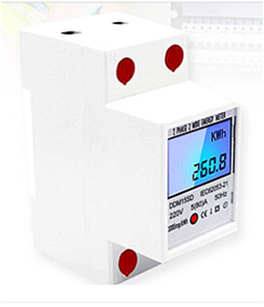

A shop bought energy meter
https://www.ebay.co.uk/itm/354118466147
I used this purely to test the power, 1 pulse per Wh, same as my main meter.  I will, as I bought 3 of them, use them on my 3 ‘night circuits’ once I have finished playing.

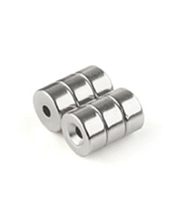

Some magnets with holes in the middle
https://www.ebay.co.uk/itm/184928442876
These are to hold the light dependant LED onto the meter.  A suitably sized metal washer was super glued in place.

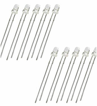

Some photodiodes to sense the red flashing light on the meter.
https://www.ebay.co.uk/itm/232690475106
This is the real magic, just wired in between a GPIO pin, 22 in my case and ground.  The important thing is to wire it in the ‘wrong way around’.  So the anode, the longer leg on the diode, is wired to ground, and the cathode, the short leg, is wired to pin 22.

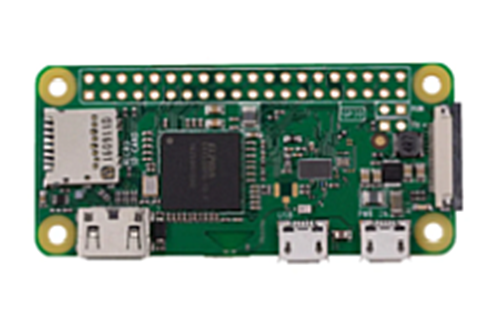

A Raspberry Pi ZeroW
https://thepihut.com/products/raspberry-pi-zero-w
Just a bog standard RPi ZeroW

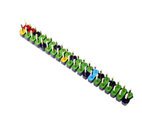

A header
 https://thepihut.com/products/colour-coded-gpio-headers
Are useful, and I think you can buy the RPi ZeroW with them already soldered in place.  You need it to easily fit the RTC on.

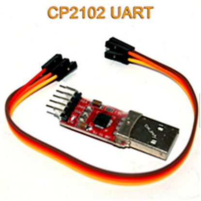

A USB to TTL Serial adaptor
 https://www.ebay.co.uk/itm/203604196200
Useful when setting up a ‘headless’ RPi.  Just make sure to change the /boot/config.txt to inclide the line
enable_uart=1
