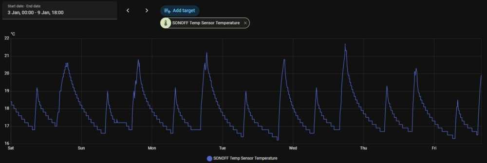

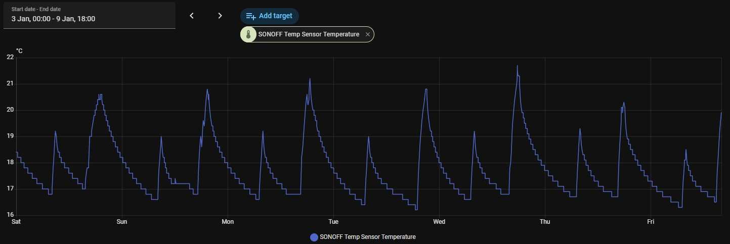

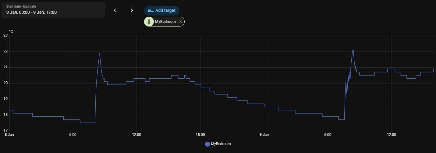

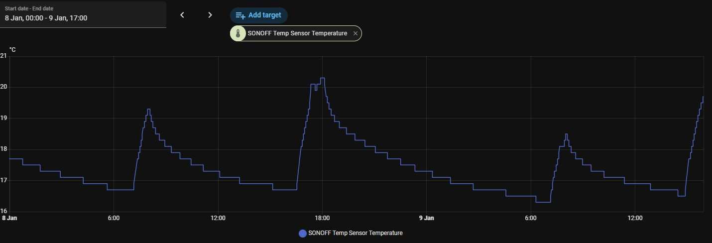

I've a split Air to Air Heat Pump system to heat my house. There's a header in each bedroom and one for the open plan living/dining area. I've had the unit on a timer for an hour in the morning for the open plan area only and I'll sometimes top up my bedroom in the morning when I'm working from home. I top up the heat for 1-2 hours in the evening manually in the open plan room. I'm not heating the upstairs currently and am still finishing the internal house so there's an open internal window to the open plan area to contend with still which loses heat to the landing/hallway and upstairs although I keep those doors closed which helps. This is the open plan area: Same Space - Longer Period: My Bedroom: Just wanted to ask should I be running the A2A more like underfloor and leave it set to 21/22 & on constantly or just on a timer? I'm treating it like a gas boiler at the moment!! I've a separate hot water heat pump cylinder I leave on all the time so it's always @ 55oC so hot water isn't a factor with the space heating. Interested in advice / ideas / experiences others have with a similar system? Thanks.
