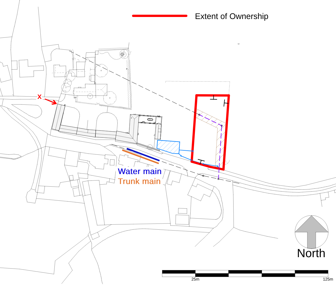

#1 - water meter
The Transferee covenants with the Transferor and his successors in title, for the benefit of the Retained Land and each and every part of it, with the intention of binding the Property and each and every part of it, to:
pay without any deduction set off or counterclaim to the Transferor on demand such charges for the water used by the Property as recorded by the Water Meter as the Transferor may from time-to-time demand on the basis of charges 30% above the charges for domestic water supplies made from time to time by the local water supply company (including any standing charges) being at the date of this transfer Yorkshire Water Limited;
As per the definitions, it seems like the water meter will be placed near where the red "x" is on the attached image. Compare that to our plot location outlined in red.
Context for this:
We're buying this as a serviced plot, and that's definitely reflected in the price. It's a surprise to us that the water meter would apparently not be on our property at all, and that we'd be billed for water by the sellers directly (+30%). In the image I've also drawn in roughly where the water main supposedly is as per the searches we got back. So it seems like it's quite close to us from the south, and weird that instead of directly connecting there the sellers are connecting from the west.
1. Is this a weird arrangement?
2. Is it worth us just sorting out water ourselves since it seems to be close by? Annoyingly Yorkshire Water requires a £500+ application fee to even get a quote, so not sure how much it would cost to connect ourselves.
Can you? You'd probably need to ask your sol'r since, by doing so, you would be fettering their 'funding stream'. What about water disposal? What are the drainage arrangements? Are they seeking to get you to pay +30% on top of disposal as well as supply? (Or is drainage private?).

Most water companies won't allow sub metering, you'll need your own supply.
That's interesting. Haven't had a chance to talk to our solicitor in detail about this stuff yet. Wonder if that's something they would know.
i agree with this, normally if there was 5 barn conversions on a site you would see 5 new covers with 5 meters, in a new patch of tarmac outside the site.

Surely their wanting to bill you for water supply would come with responsibilities on their part.  In effect aren’t they setting themselves up as a water supplier?  That must come with responsibilities  as regards quality of supply etc.
Ofwat has something to say about that : Anybody who resells water or sewerage services must charge no more than the amount they are charged by the water company. They are also allowed to charge a reasonable administration charge. The administration charge is set to cover administration costs and the maintenance of meters. It can only be charged if it is not recovered by any other arrangement, such as through the rent or mobile home pitch fee. Resellers can recover around £5 each year for those without a meter and £10 for those with a meter. The administration charge applies to each purchaser and not to each occupant...  ...If your reseller charges you more than the maximum resale price, you can refuse to pay the extra amount. You can take legal action against them in the civil courts to recover any overpayment. You can also recover interest on that amount.
https://www.ofwat.gov.uk/households/your-water-bill/waterresale/
Thanks we did manage to get the water thing completely kicked!
