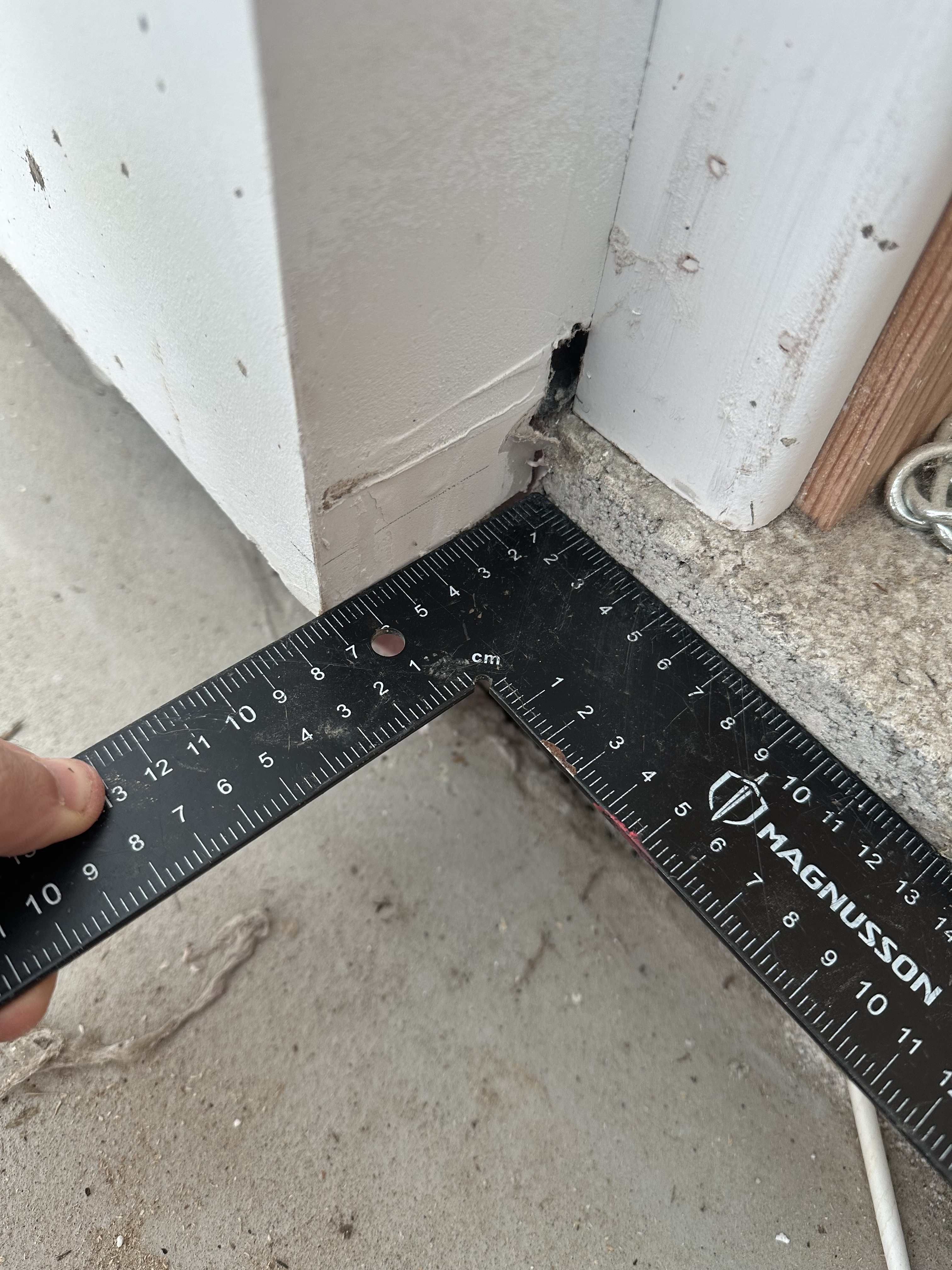

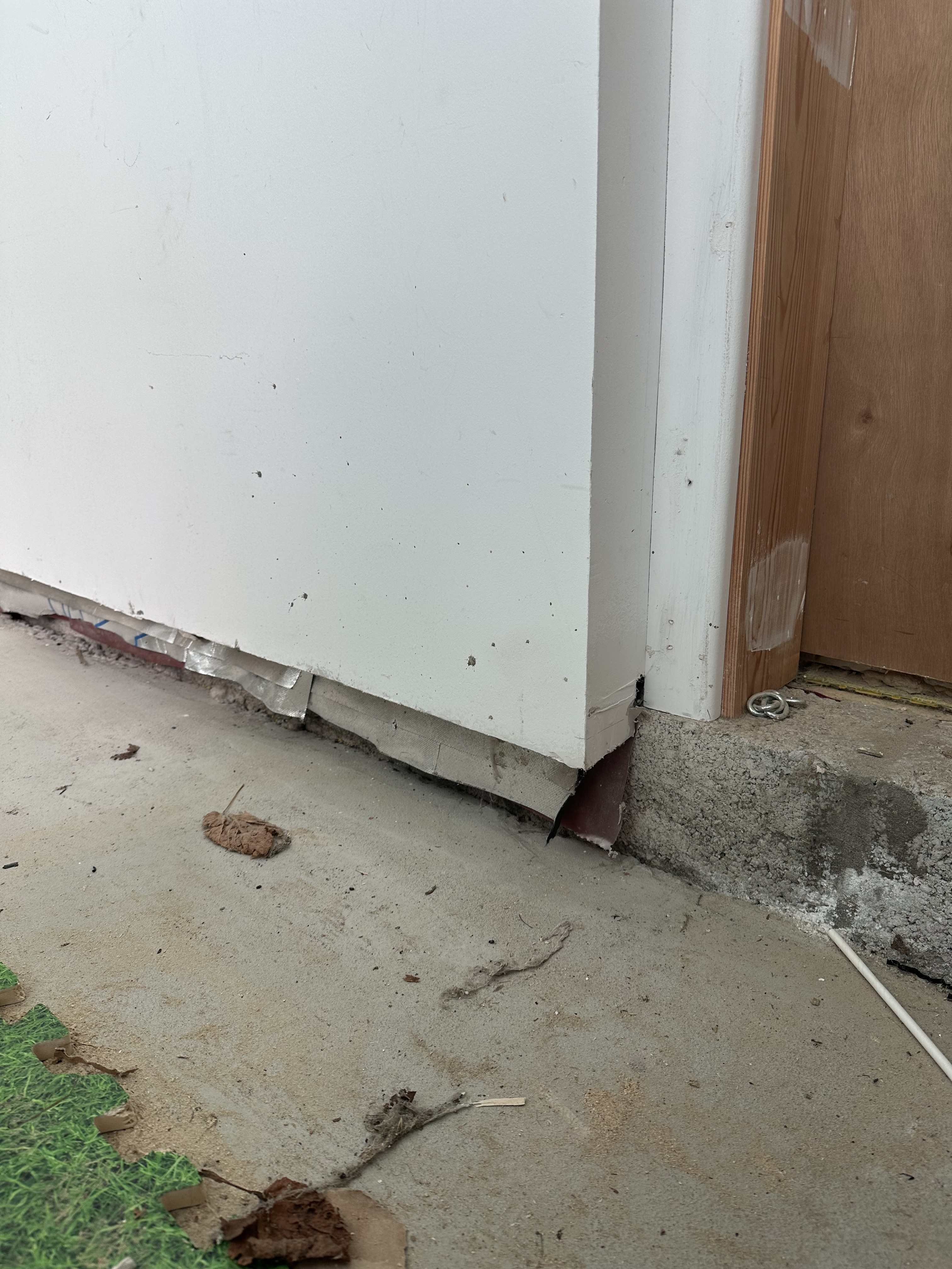

Hi, im about to start converting my garage into a gym. The walls are already insulated and plasterboard to the same spec at the rest of the house. The floor is concrete. I plan on creating a timber frame floor 100mm in depth using 2x4 with 100mm PIR in the cavities. 22mm caber deck T&G on top of the frame.

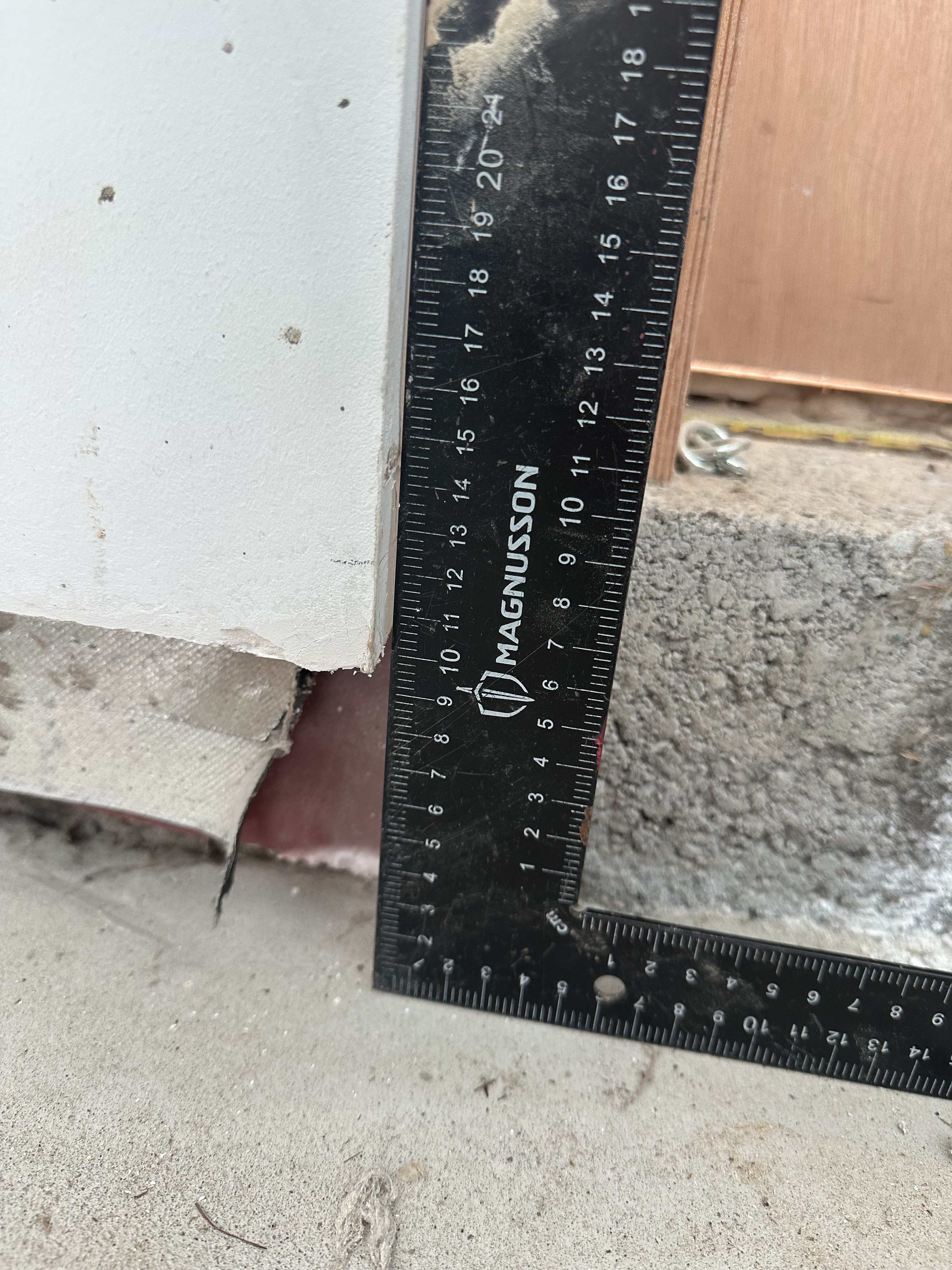

I have read that the new floor frame should be 10mm away from the existing garage walls and 10mm away from the bottom of the plasterboard. I did plan on putting the new floor underneath the existing plasterboard, however that would mean trimming the bottom of the plasterboard and it will make it more awkward fitting the T&G boards.
My question is should the frame be 10mm horizontally away from the existing wall (blocks) or could it be 10mm away from the plasterboard.
Thanks in advance for any assistance.
