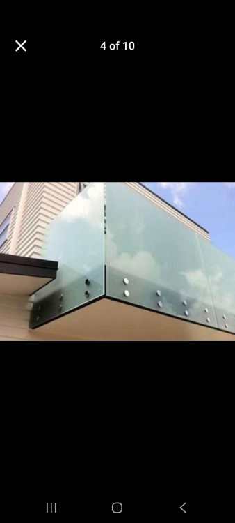

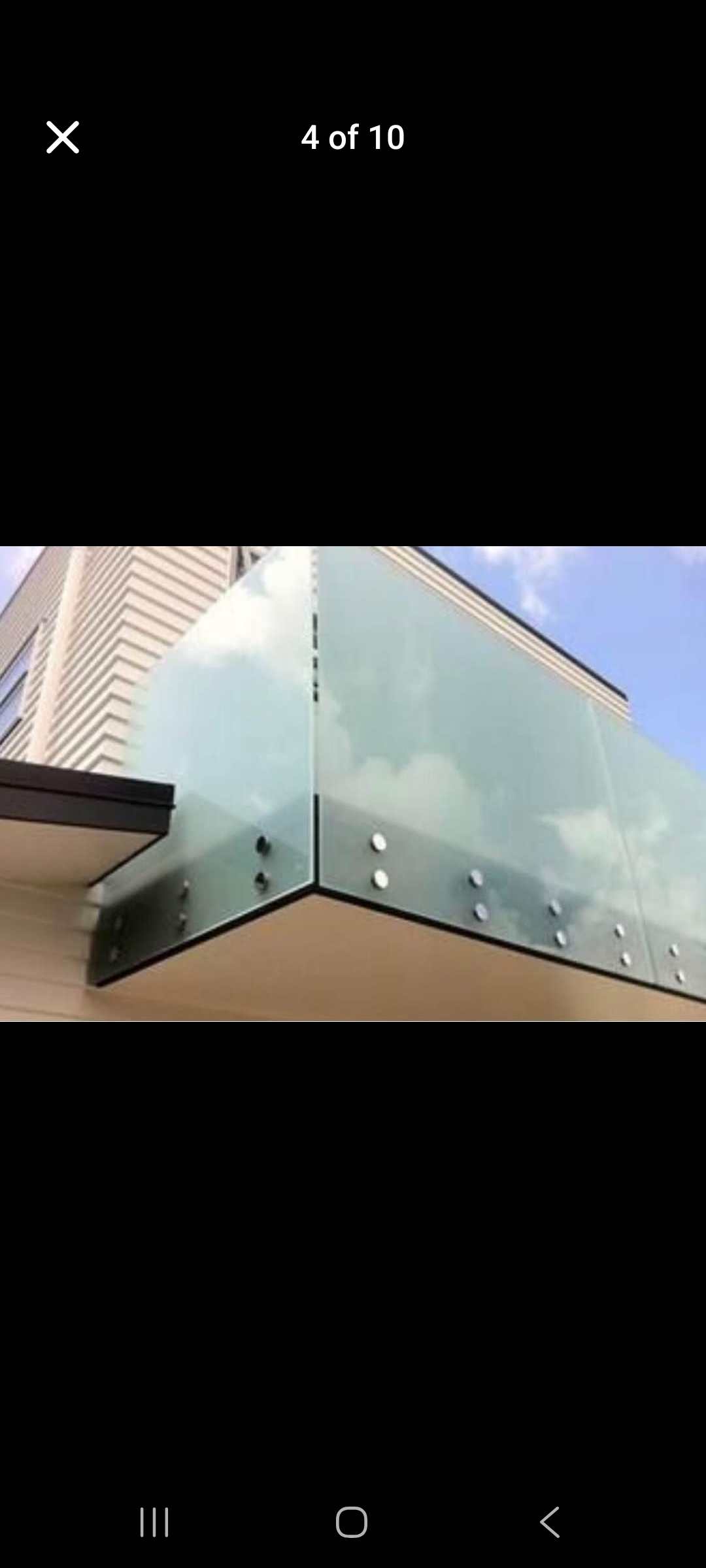

July 6, 20251 yr We're looking for reasonably priced versions of this style of balustrade (clear, not frosted). It will be fitted to the glulam beam in the following pic Anyone know of anyone, preferably in the South West, but willing to source elsewhere if delivery is reasonable.

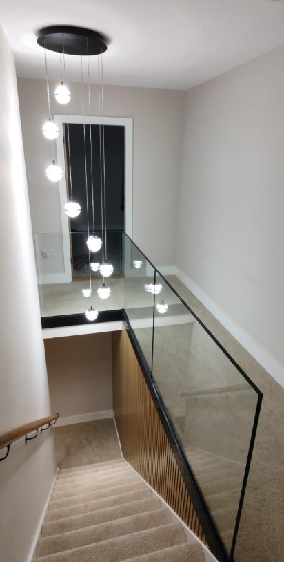

July 6, 20251 yr 2 hours ago, Thorfun said: We used these guys https://www.wpshandrails.com who were very good. for completeness it was supply only. We fitted all our balustrades ourselves.
July 6, 20251 yr I think it is these https://www.fhbrundle.co.uk/products/1806455M__Glass_Connector_-_O/D_50mm_x_20mm_With_M10_Threads_-_Grade_316_Mirror you want. I would try Cornwall glass for making the glass panels as I think are quite local to you. You can template the hole positions before you get them made.
July 6, 20251 yr I bought glass as well as hardware from F.H. Brundle for a balustrade. Their glass was a good price.

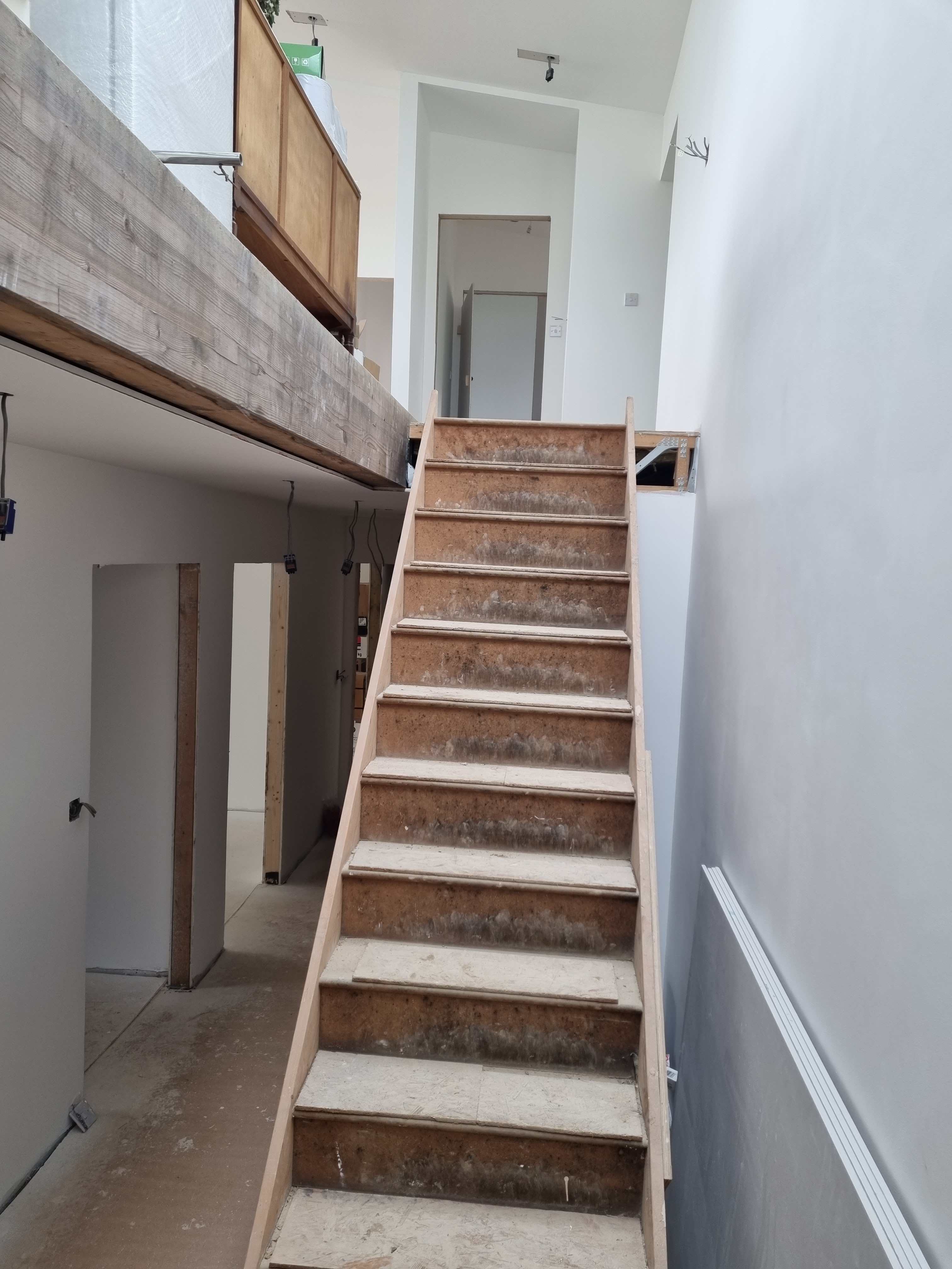

July 8, 20251 yr Author On 06/07/2025 at 20:57, MPH243 said: I think it is these https://www.fhbrundle.co.uk/products/1806455M__Glass_Connector_-_O/D_50mm_x_20mm_With_M10_Threads_-_Grade_316_Mirror you want Yes. Only problem is have with that is having to remove the ceiling the other side of the glulam beam to put the M10 nut and a washer into 🙂 Now looking for M10 tube inserts of a suitable length ((50mm?) for the glulam beam. Edited July 8, 20251 yr by BotusBuild Change last para
July 8, 20251 yr 4 minutes ago, BotusBuild said: Yes. Only problem is have with that is having to remove the ceiling the other side of the glulam beam to put the M10 nut and a washer into 🙂 Now looking for M10 tube inserts of a suitable length ((50mm?) for the glulam beam. Things masively depend on the glulam beam construction and what's behind it but it looks like you have two options: Either some HD through bolts like these: https://www.fixingswarehouse.co.uk/products/toggler-snaptoggle-heavy-duty-toggle-bolts-bm10-25pk Or some M10/12 screws straight into the glulam - are there any load recommendations Regards Tet
July 8, 20251 yr Author FYI - the glulam beam is wood, of course, 300 x 150 mm, 6m long. On the now hidden side are some web joist every 400mm. And various wires, vent ducting and insulation. Murphy will have placed a joist in the way of at ones set of screws, nuts etc 😁 Edited July 8, 20251 yr by BotusBuild
July 8, 20251 yr Author 8 hours ago, Tetrarch said: are there any load recommendations I don't have any, but treating it as if a first floor balcony

July 9, 20251 yr 12 hours ago, MPH243 said: I just messaged a mate who had the glass balustrades to Gulam like you want. He used these https://www.tcfixings.co.uk/category/wood-to-metal-dowels/945 but could not remember the size. You would then need the glass clamps. You don't need these. For a standoff in a glulam (is there a better screw substrate?) you could use a regular coach screws - the biggest that you can safely insert Regards Tet
July 9, 20251 yr Author 18 hours ago, MPH243 said: He used these https://www.tcfixings.co.uk/category/wood-to-metal-dowels/945 but could not remember the size. You would then need the glass clamps Brilliant, that'll do the job
July 9, 20251 yr Author 5 hours ago, Tetrarch said: regular coach screws Which require a nut on the other end? Is there another type? I don't want to have to get to the "hidden" side of the glulam beam
July 9, 20251 yr 12 minutes ago, BotusBuild said: Which require a nut on the other end? Is there another type? I don't want to have to get to the "hidden" side of the glulam beam Coach screws do not require a nut on the end. coach bolts do.
July 9, 20251 yr I would not fancy holding up the glass while winding in the coach screw. The others are already in the gulams and just need to fit the glass, clamp and nut with less chance of slipping. Unless the clamp bit is bolted to the gulams before the glass is fitted but I am not sure on that bit?
July 9, 20251 yr With the right kind of standoffs you secure the standoffs to the beam and then fit the glass to the standoffs in an entirely separate process. I found this on youtube to give you an idea: Just to note I have NOT installed these, but just came across this when doing my reseaach Regards Tet
