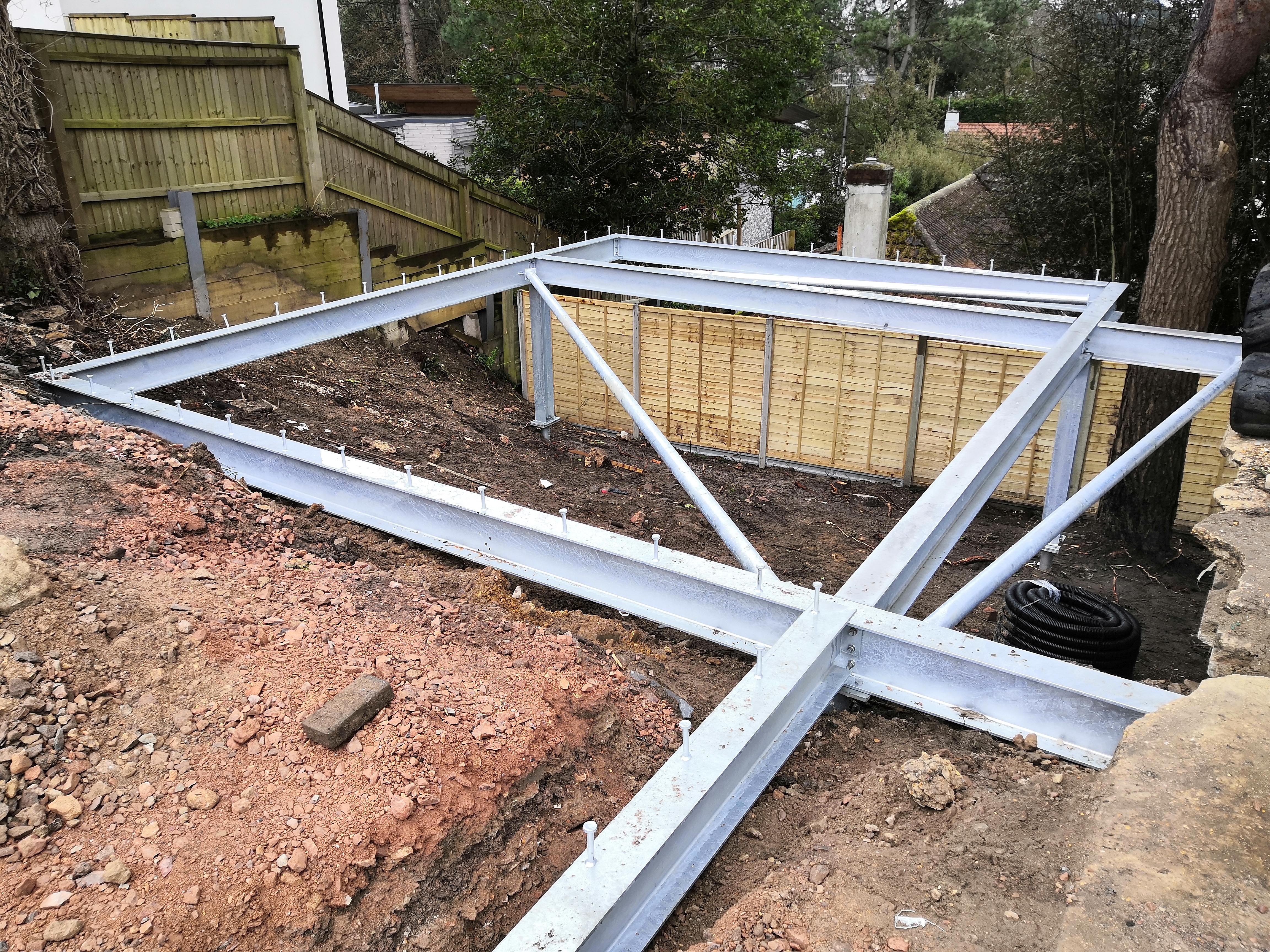

Following the screw pile install this week we had the steel framework installed. Lovely job. Only 1 issue where 1 beam which is below current ground level was blocked by a large concrete slab that we didn't expect - solution was to fit it about 50mm higher than the rest which will be fine if we cover in concrete.    Now that's in, we can order the beam and block. Just waiting on SE to confirm a slight change to that. So probably 2-3 weeks until the area is ready for storage etc but gre

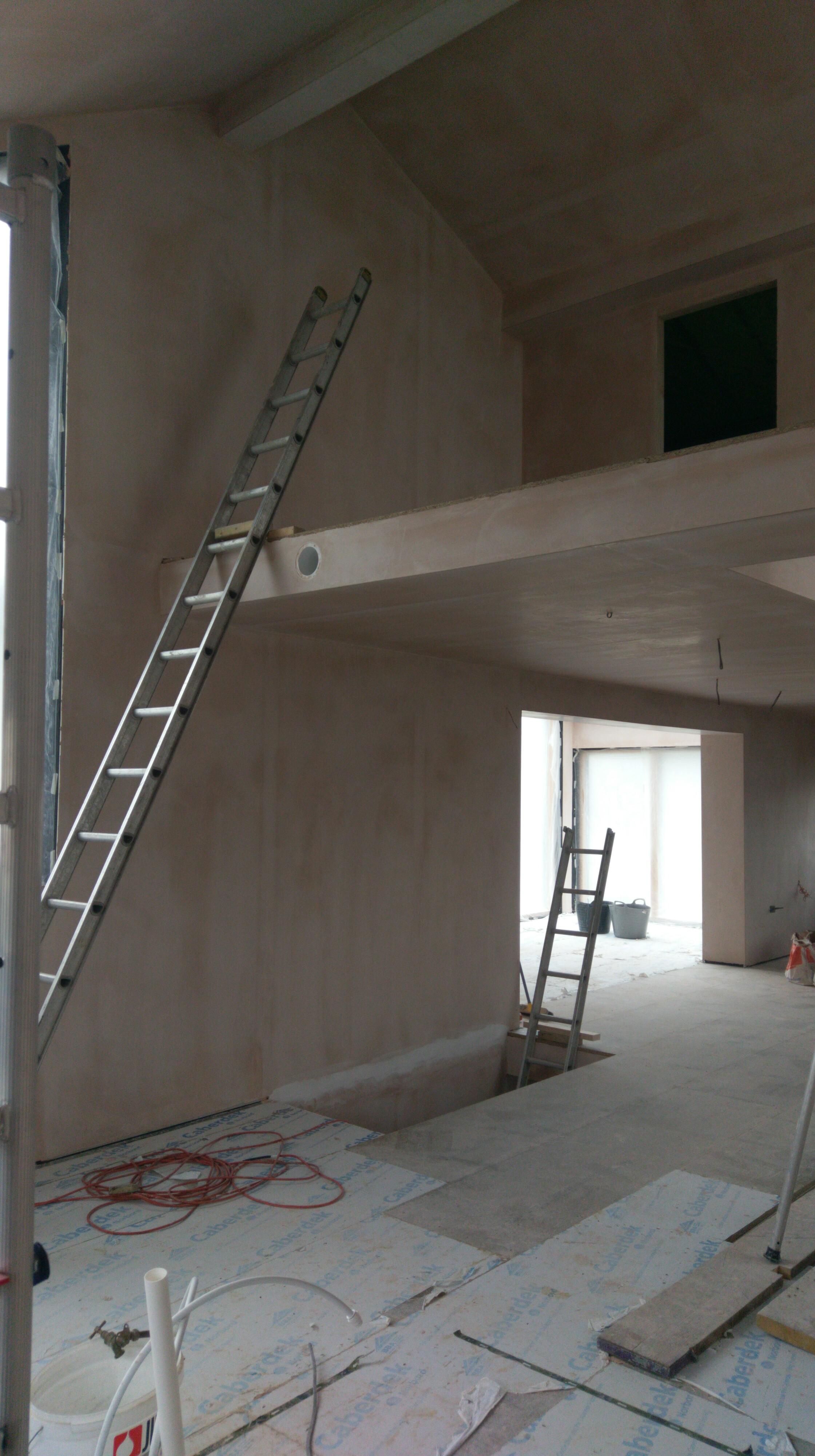

Well it’s been an exhausting and rewarding three weeks. The plastering work started on the 25th February and finished today the 18th March. Keeping ahead of Shaun our plasterer has been a real challenge and has meant we have not had a day off.  Our internal doors arrived from Germany intact which was a welcome diversion, we've stored them safely in the garage until we get the painting done.   The heat and humidity that goes with plastering has been interesting to say the least in

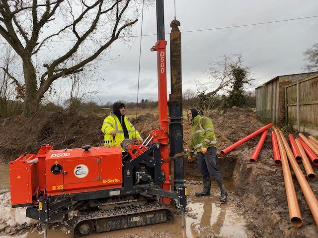

The piling crew phoned me early on Monday morning. Can we come to site on Thursday? We're going to be done earlier than planned and we don't want to waste money on the ferry. Fair enough I think - the ferries are silly money if you're moving equipment. It left me a little problem though - the site wasn't graded to the right level and I had no piling mats. They were on my weekend list so they would be ready for Monday when I was originally expecting the piling team.   So a few phone cal

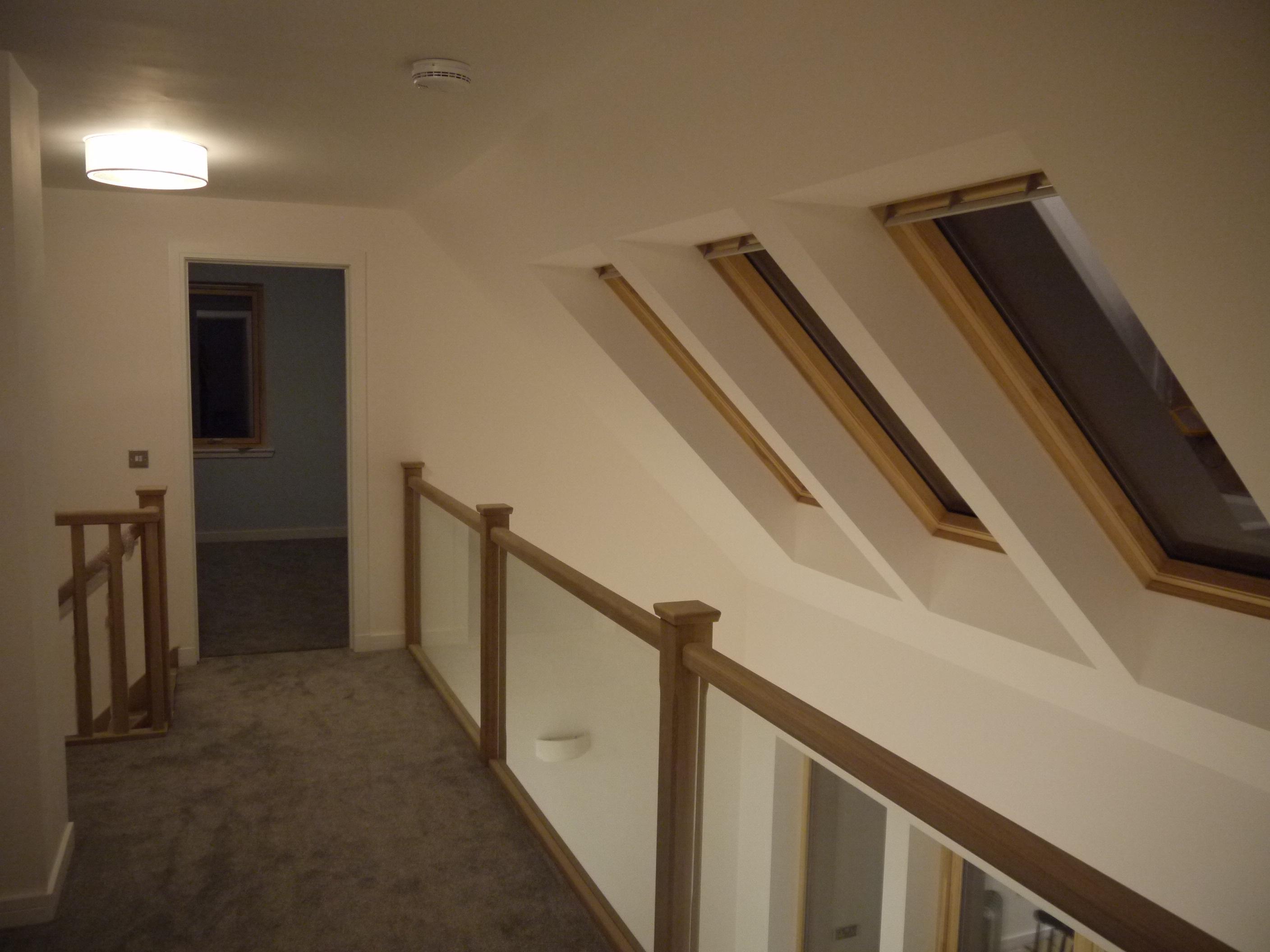

Since the last entry we have completed the upstairs. This area consists of two bedrooms and an open plan play area landing.   Carpets were fitted after the Christmas break.     Lights, switches, sockets and fire alarms have now been installed.     My wife is working her way through the rooms downstairs. Painting, caulking and tidy up plastering work. We are really happy with how this is coming together.     The temporary su

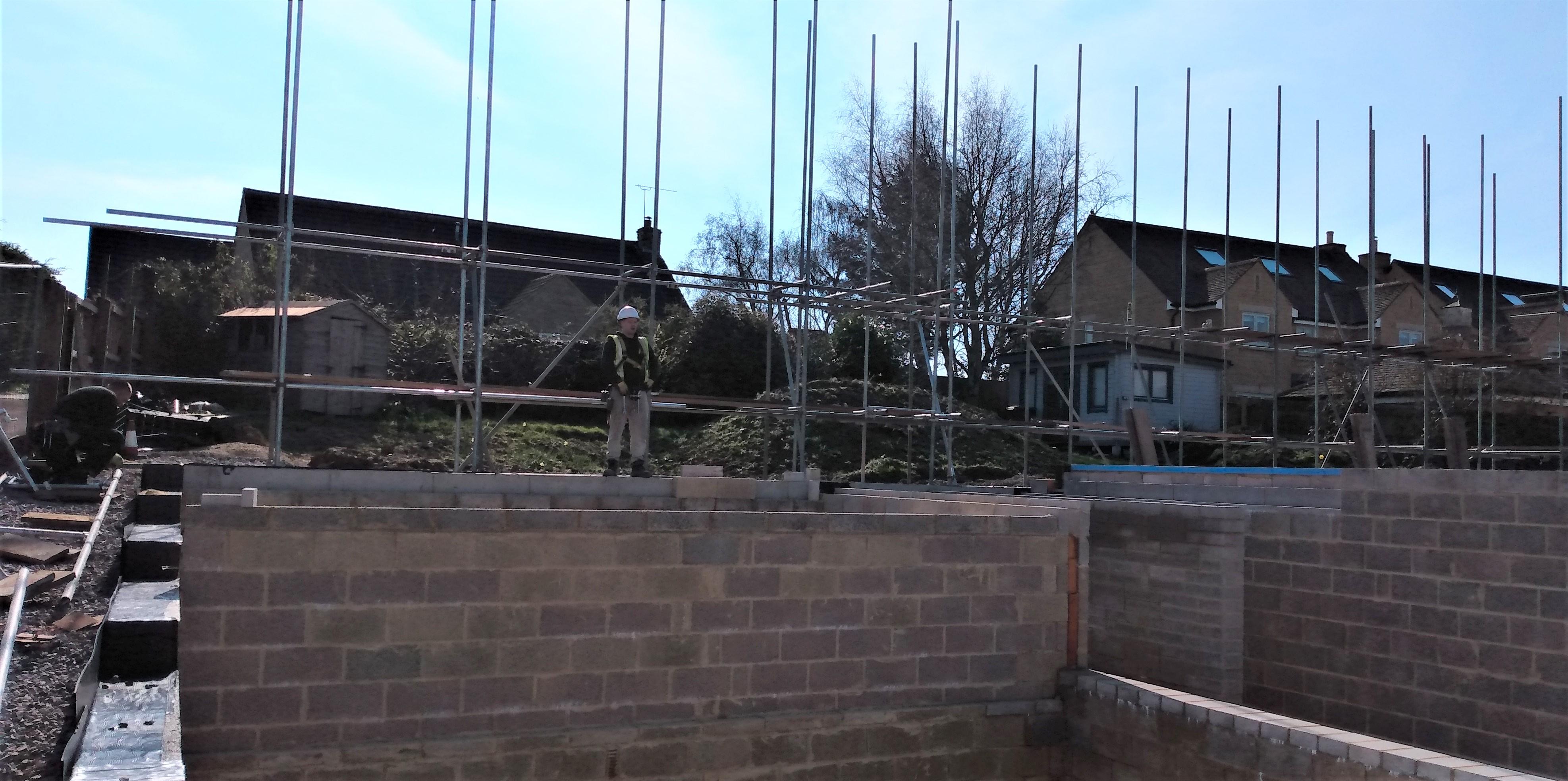

As you can see there has been some progress on site and things are looking good - not all plain sailing but as we keep telling ourselves - we are getting there. Blockwork walls are going in and we can finally get a real feel for the basement rooms and the layout. Lots of back and forth on waterproofing and insulation/ thermal break under the walls and real problems locating 100mm high Marmox blocks - these are specialist lightweight composite insulating blocks that help prevent thermal bridges a
