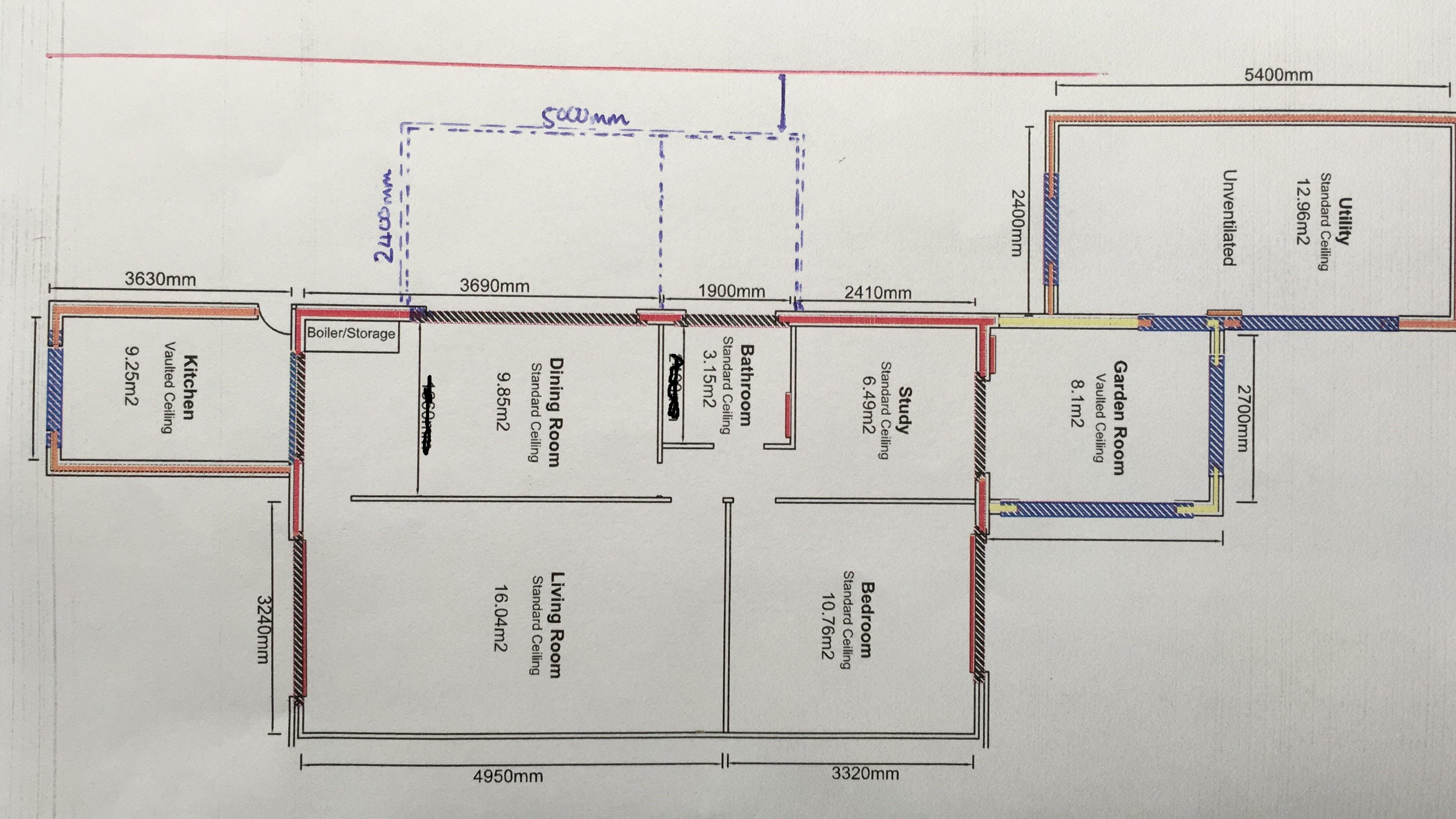

I've done a rough 'fag packet' drawing at the moment, just to have a think about different things:
So the intention is to make a larger dining room, and bathroom, and creating a courtyard infront of the utility for things like bins, water storage, and the inevitable ASHP equipment, which will keep it all out of sight. Making use of the already ample openings, will save any major structural work, however the roof timbers on the extension (which is going to be a mono-pitch lean-to style roof) will likely have to sit on a steel lintel, as the bathroom window opening has no lintel on the outside brick layer, the dining room opening has an angle iron, but who knows if its strong enough to hold a load of concrete tiles and a triple glazed roof window, I will be putting all this through a structural engineer to get a final decision on this. Having the side extension also fulfils another thing which is to prevent overheating. That side of the house faces south, but in winter doesn't get hardly any sun as its shielded by the house next door, so having the side extension with only roof windows facing south (which can be covered with awnings), should prevent a lot of overheating which was become very common on the hotter days.
Construction is going to be block and brick cavity, but going with Xtratherm CT/PIR full fill PIR insulation in order to achieve sub 0.16U on the walls, and this is a true self build, as per my other extensions, even the foundations i'll be digging by hand, as where its situated is where all of the foul water drains are, which all need unpicking and re-routing, about time I had some exercise! lol. Going with a large roof window in dining room, and a small one in bathroom, with large window in dining facing to the left hand side (which is the road side), and no further windows in the bathroom, unless planning say i've got to, roof window should give enough light in there.
As I've already used my 1 free pass for permitted development, this one requires planning permission, so my next task is to draw up some plans, and submit them at some point this year, QCAD being my tool of choice. I used to use draftsight, which I was hoping to do again, and just build on what I had, but turns out they've revoked the free version, and the files it generates don't open in anything else annoyingly, so its a start from scratch job!
Would love to hear any opinions on if you would do anything differently, always like considering different ideas. Will post the plans for both planning and building control when completed, to show an idea of what is required to get approval (which may take several goes, its been a few years since i've done any plans!)

AdamSee
Good to hear that your getting back on it.
Just an idea, but as your doing a flat roof on the extension, would you be able to join it up to your utility room? I like the idea of having a courtyard area to house your bins and the external services that you want to keep out of sight. But personally I hate having to take out the rubbish when its raining or cold and I having a partially undercover area seems appealing.

it’s going to be a pitched roof, lean to, angle could be tricky though as the roof tiles which match state minimum 30 degree pitch, I need to work out where that will end up, I’m hoping reasonably high as another reason for the EWI was to hide some damaged brickwork from a porch which was on the house before we bought it. I’ll have a think about the courtyard, utility has an apex roof and the junction between that the garden room and the house was quite awkward when I did it, I think as you said only a flat roof would be able to link in, but I don’t want a flat roof for the extension as I don’t think it will fit in well with the rest of the house. Will ponder that one though! I often find ideas come out while drawing the plans too

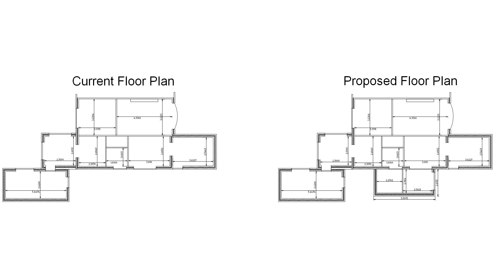

Had a little free time this afternoon, and a new laser measure turned up that i ordered, so decided to crack on with the floor plans, all fully measured and scaled.
The keen eyed of you may notice that its grown slightly too, just seemed to sit better with an extra half a meter length. Next job is the elevations!
