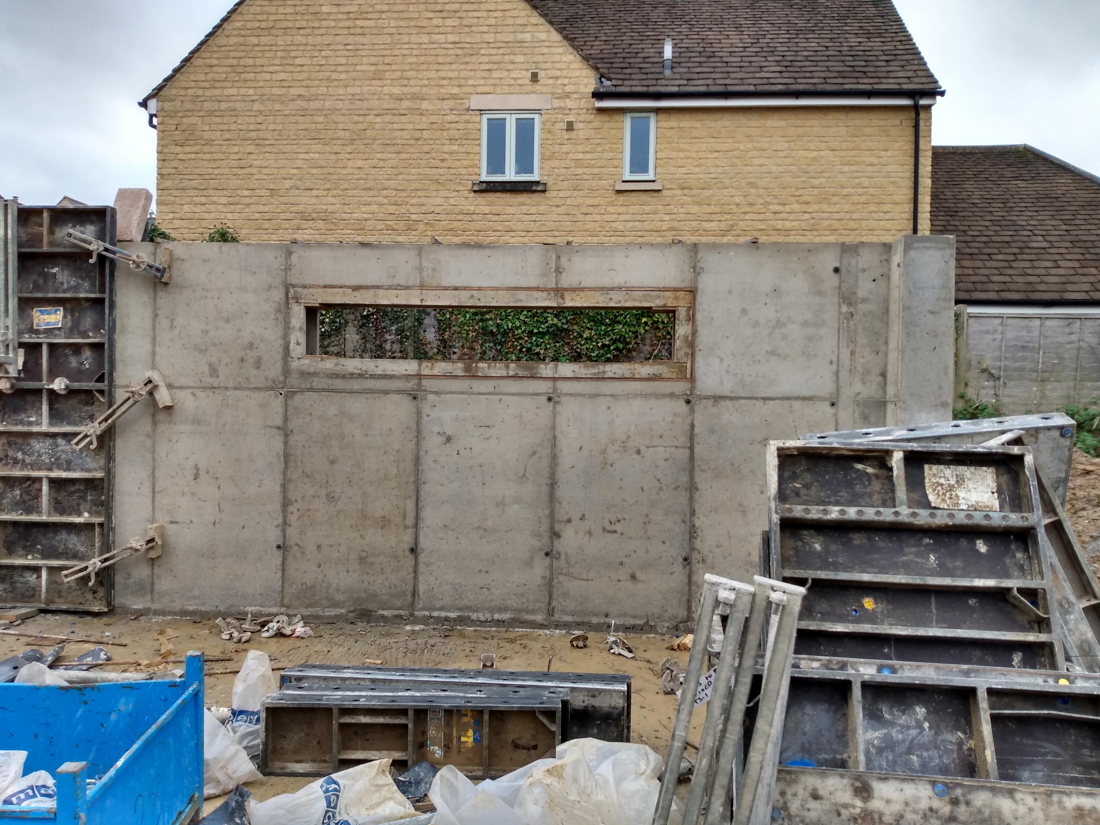

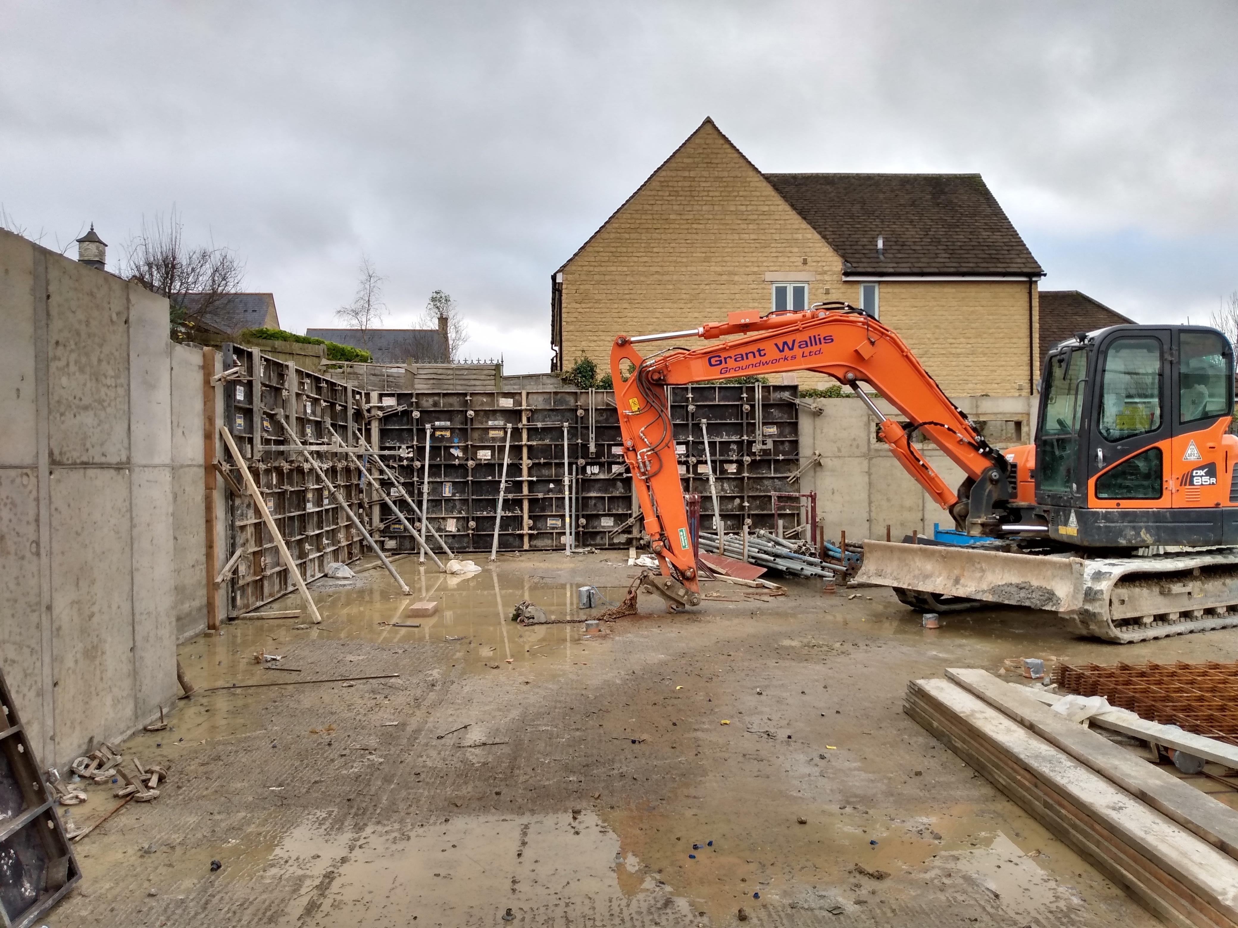

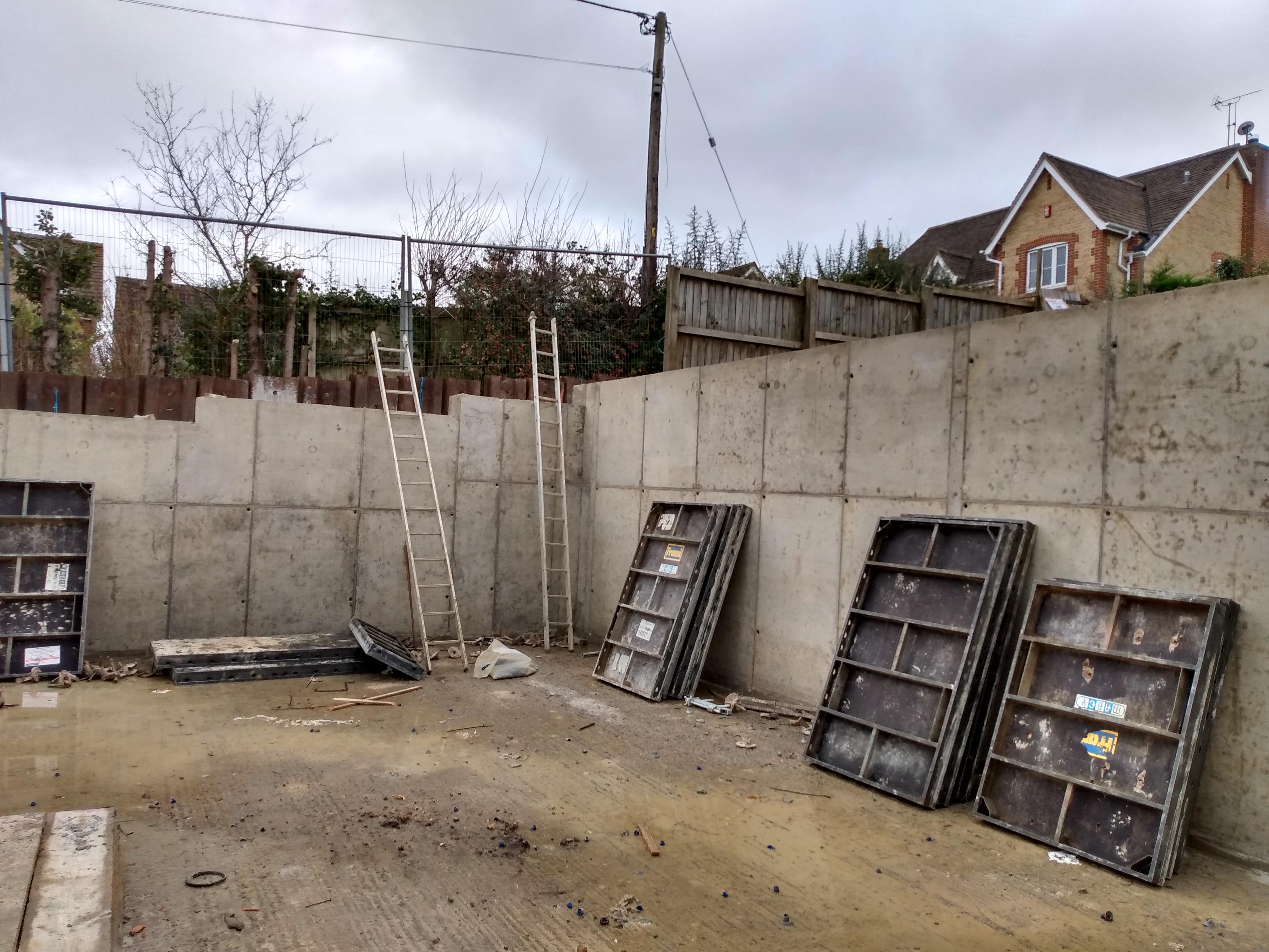

The weather was really cold this week but the guys cracked on and removed the shuttering from the first pour of the walls and moved it ready for the second pour. Luckily the weather warmed up and they were able to pour the final structural walls on Friday so this should be the last of the  waterproof concrete. As you can see where the shuttering has come off we are left with really neat concrete with just the shutter panel marks. The waterproofing guy inspected these and was really happy: in his words 'near perfect'! He will do a detailed inspection when all the shuttering is off and if there are any cracks (and he couldn't see any so far) they will get filled and sealed with some sort of waterproof compound. The next step will be to remove all the shuttering and then we will see the real space for the basement and houses . Its odd how sometimes the space seems huge and at other times it gets much smaller. Following the clean-up its external tanking/waterproofing and backfill and internal masonry walls. Also you can see the opening for the garage window which has been pre-cast, its the only opening we can actually measure before we order the windows which is a scary thought!IMG_20191207_123838517_HDR.thumb.jpg.35ad71b899e3b9d899032ddb853f22a6.jpgIMG_20191207_123924757_HDR.thumb.jpg.9c560bec524e39ca4fa6b51eb900e4fb.jpgIMG_20191207_124014823_HDR.thumb.jpg.07be71dd54269070cf01c1c1d9d55229.jpg
