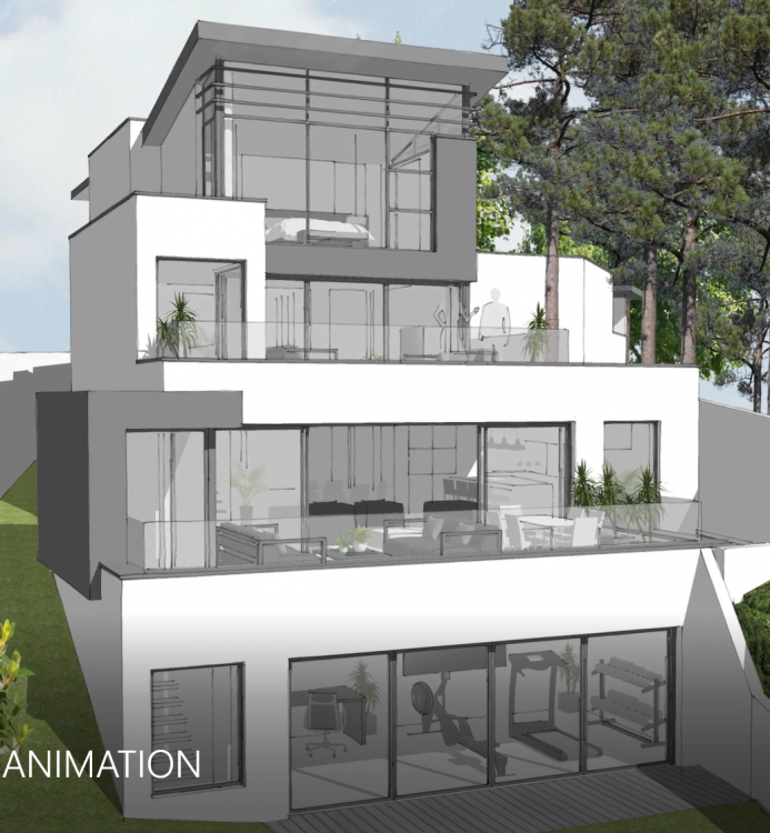

Rebuild of a house on a hill. My wife describes it is a wedding cake!
The image here is the concept, yes I know solar gain....may grow vegetables :-)
