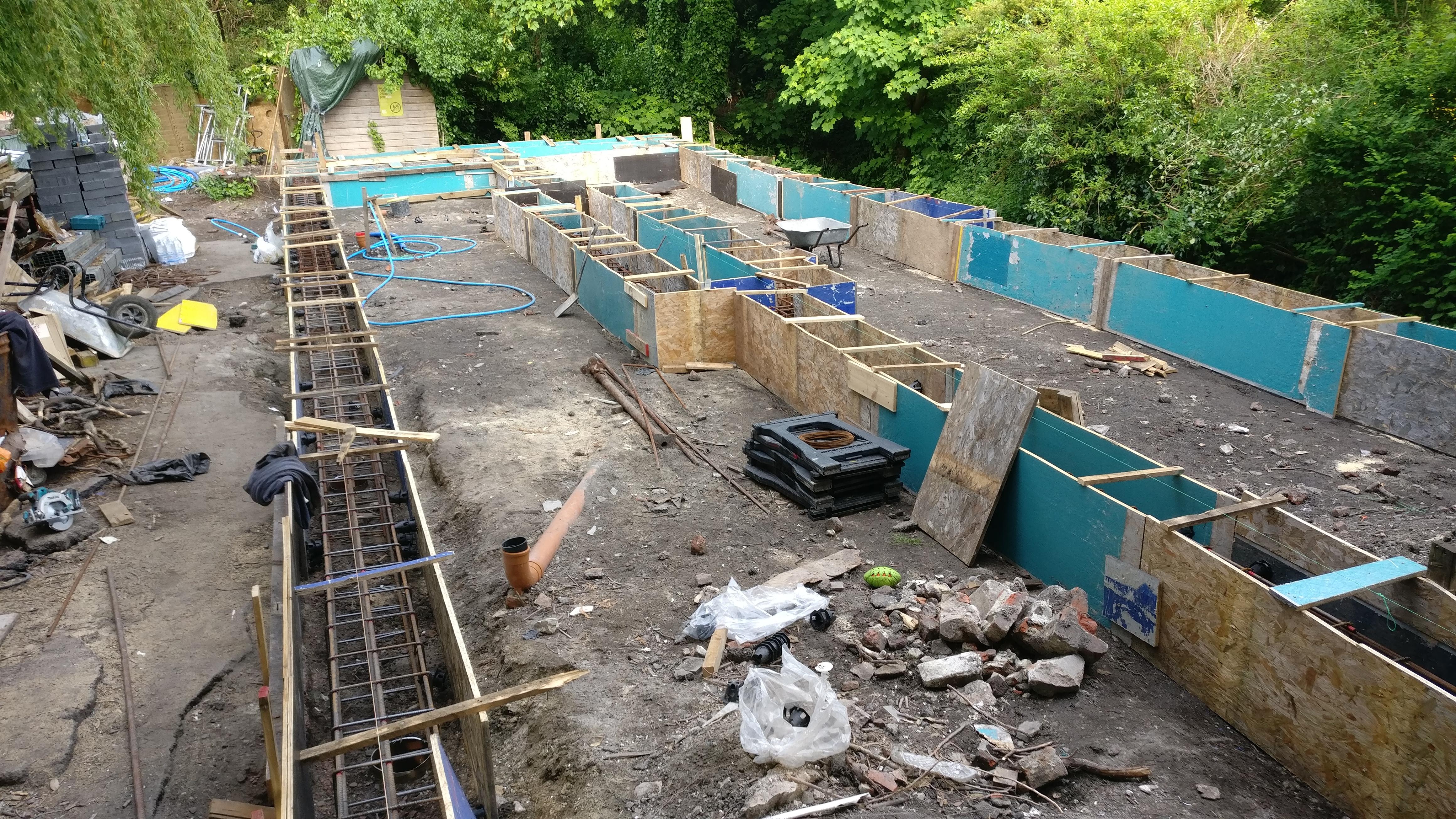

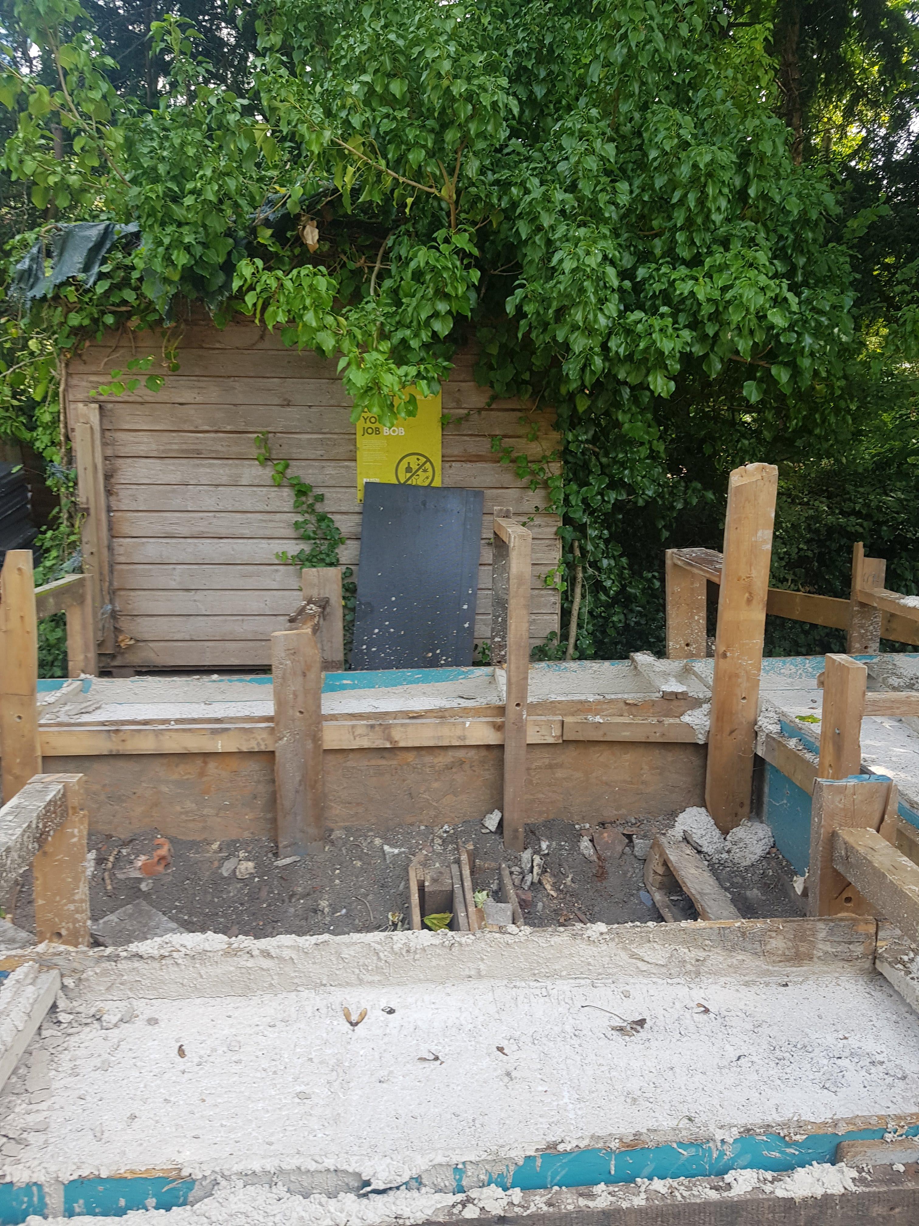

Pooring concrete . Above Ground Ringbeam . Shuttering Burst . Concrete Explodes .
Been a while. Had no time. Contrary to the rest of the world, i did not have a minute of rest in 2020 and even 2021 looks similar so far. Finally managed to update the blog... https://tintabernacle.blogspot.com/2021/03/the-ringbeam-is-in-or-above.html   Clickbaity headline , but i promise... Shuttering DID burst (even though nothing fatal) and Concrete DID explode (again , nothing fatal)   More in the blog . Cheers ?   P.S.: @Jeremy Harris , i am sti

above ground ringbeam . Underground Drainage and shuttering.
So finally managed to update the blog. Seems like nothing happened , but a bit of progress still.   Now just have to get this monstrosity past Building Control . Challenging task but I will manage. As always. I can tell I will not become a Groundworker in this life . Or the next.   http://tintabernacle.blogspot.com/2020/05/rc-beam-or-ringbeam-preparation.html     Here are some entertaining pics from this : Above ground shuttering takes a bit of timbe
