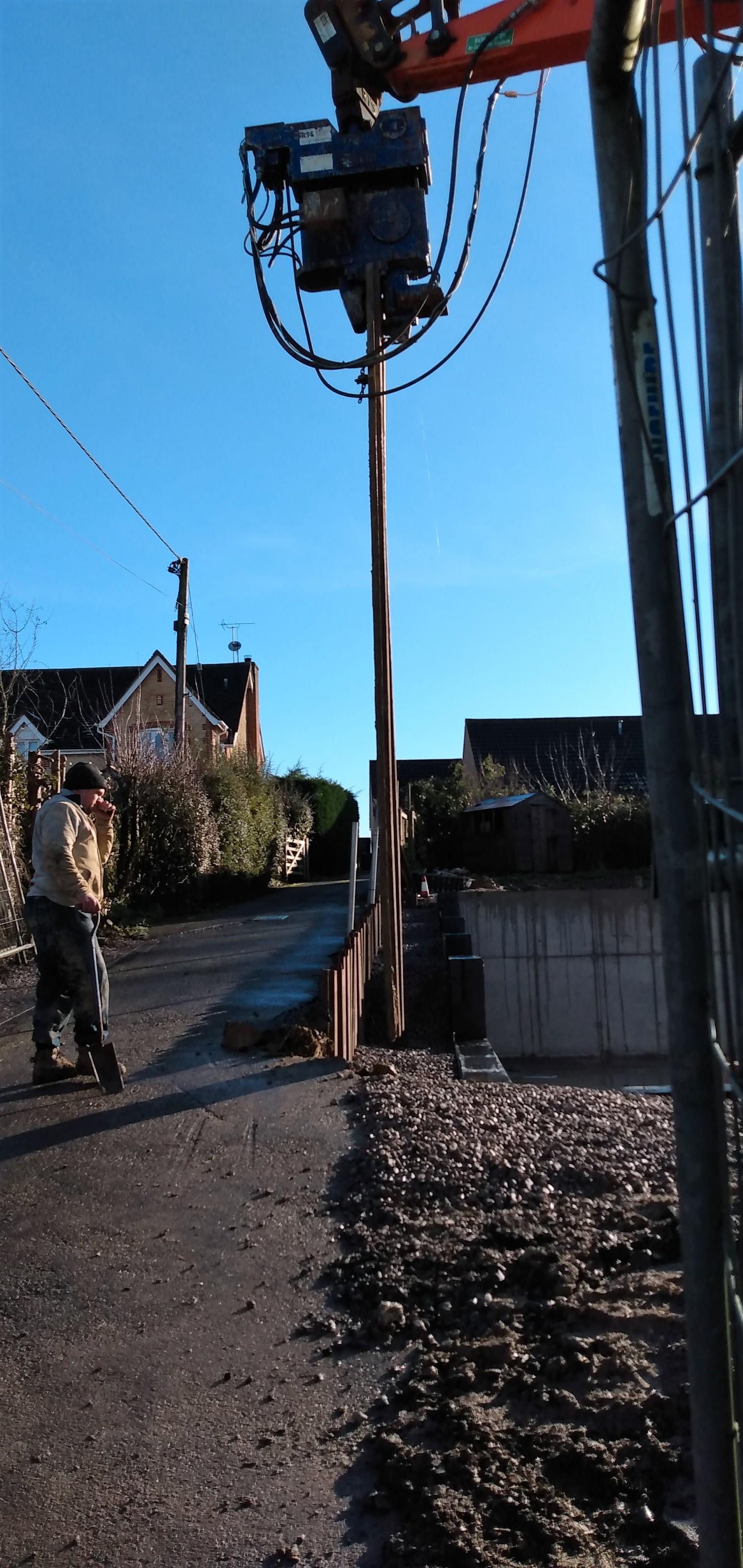

When the guys came back it was dry so they cracked on with more black tanking, external sheathing  and backfill - which is what the video shows. They built a French drain around the outside which is a big black perforated pipe laid in gravel, covered with geotextile membrane which allow water through, but not the clay fines. Then lots of free flowing clean stone up towards the top of the wall. Finally we can get around the outside of the wall without walking in clay, and you begin to see where the ground level will come.
Now the backfill is in place they can start to take out the sheet piles as the clay is held back by the walls and the backfill - surprisingly the clean stone doesn't seem to need compacting - but there is a lot of it! Removing the piles is more work than it was putting them in as the clay has stuck to them and even with the high frequency vibration hammer and the big digger its a slow process. They get really hot and steam as they come out - and I am told that they can friction weld to each other if you dont have lots of wet clay to cool them down. You can see just how tall they are with Ian stood next to one as it comes out.
