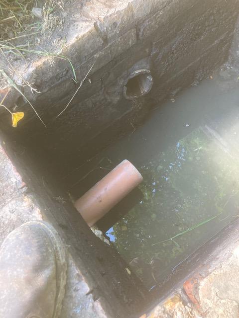

I ended up replacing the whole pipe that goes from tank to this chamber. Probably for the best as it wasn’t in the best state! Thanks for all the advice
It is an overflow chamber for the septic tank. I’ve replaced a failed pipe with the plastic. Previous pipe came out from the very bottom of the chamber and my new one comes in just above it. the whole chamber has been buried under a fair bit of earth so would require a fair bit of landscaping or raising if it was to become an inspection chamber.
