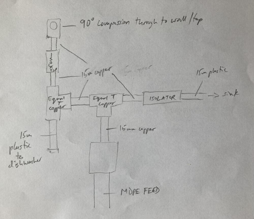

  12. Sorry last question - are you saying that I can put copper into that push fit isolator and plastic out? Or do I still need a converter before it?
  13. I feel like I’m back at school!
  14. Is it ok to have copper going into a compression isolator and then plastic coming out? thinking like this........
  15. Also - would it be ok to put an equal t where the first 90 degree is and branch right for sink tap and put the outside tap feed on the left (before the dishwasher)? Or should the internal pipe work all follow after the outside tap?

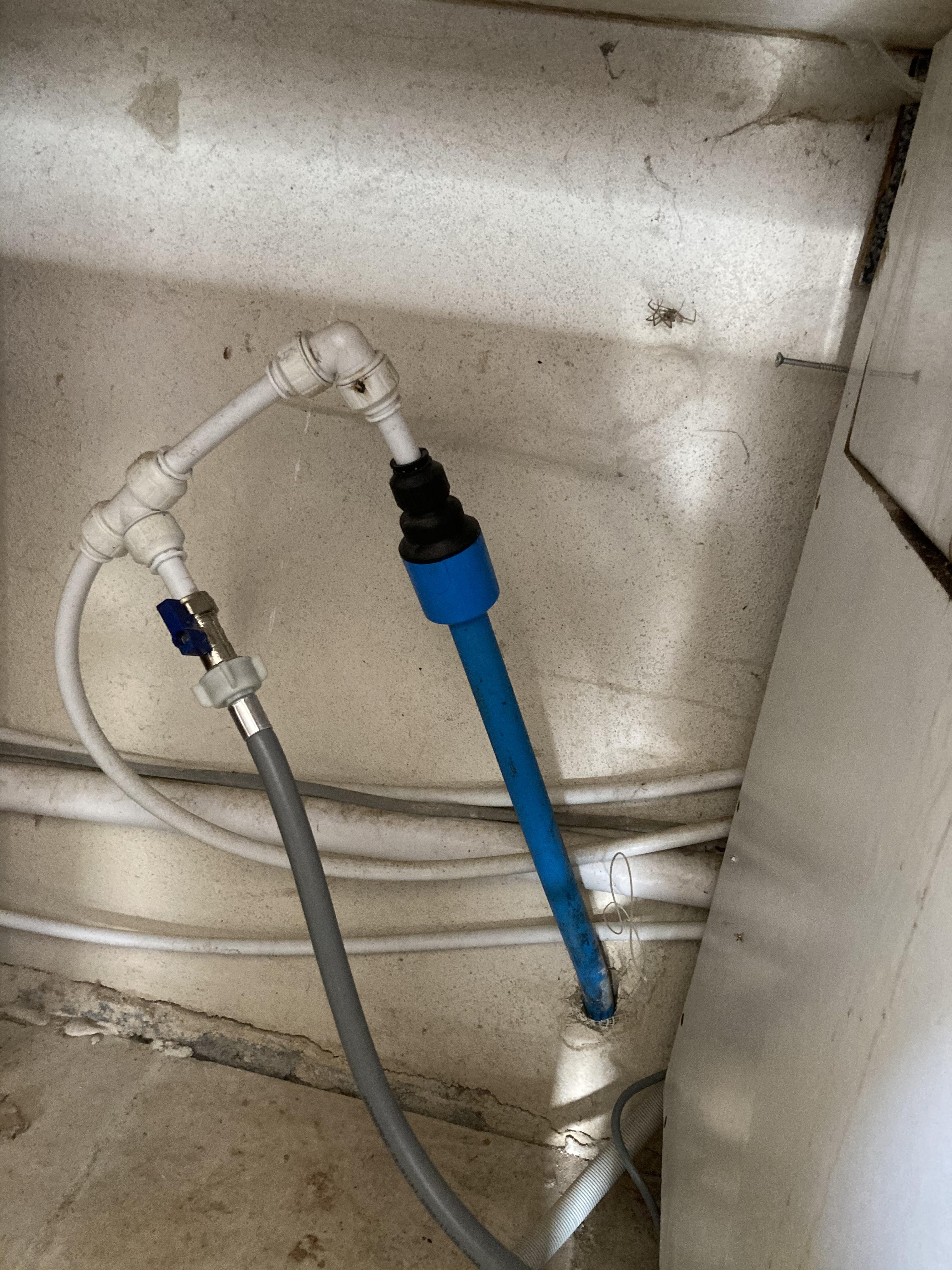

  16. Yes it isn’t great! And one of the reasons I want to sort it out. I’m also getting rid of the waste pipe behind as it is for a sink that was never used - should make it easier. Should I use copper pipe from outside all the way to the isolator and then plastic from there?
  17. As the title suggests I am going to fit an outside tap. The mains comes into a separate boiler room (with pressure restrict or) and then splits to 3 feeds into the house (all with isolators in the boiler room). One of the feeds comes in under the kitchen sink as shown in the picture. Plan is to branch off the incoming 15mm just after the first 90 degree bend and before anything else. I understand I need a double check valve before it goes through the wall. Is it necessary to put an isolator in as well given that I can easily isolate this supply in the boiler room? anything else relevant? Does it matter if the pipe through the wall is level/sloping up or down? any major difference between outside taps?
