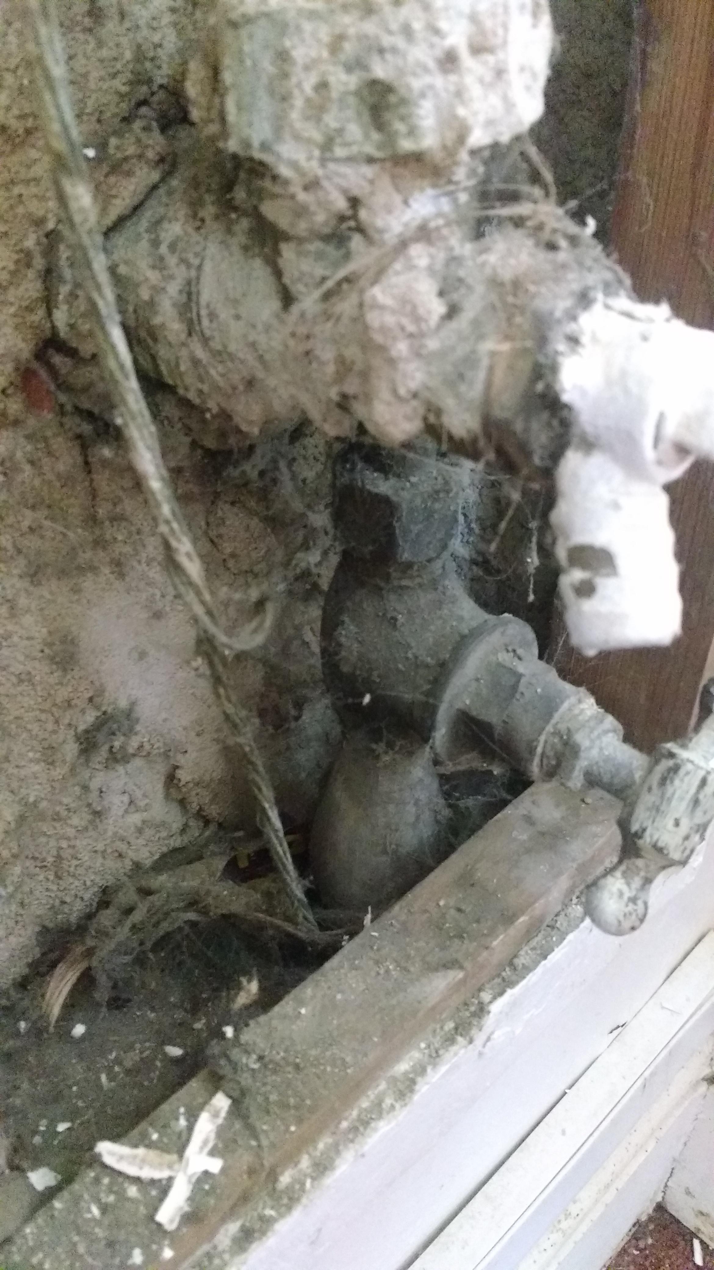

Thanks for all the input. I managed to get the stopcock working (almost - it still doesn't shut it off completely though) enough to do the job. Regarding the incoming mains - Thames Water say they don't do anything beyond their external stopcock. All pipes from the external to internal stopcock are the responsibility of the homeowner. I wonder if that has always been like that.
Thanks dave I will try that. Yes I think it is lead pipe below so I will take care. And yes I did check with the neighbours and the water was still flowing!
So I find out that the internal stopcock has seized. Go outside to the Thames Water stopcock that feeds 2 properties. Tell the neighbours I'm going to turn it off for a bit. Stick my arm in and twist right until it is all the way off. Lo and behold the water keeps flowing in the house. Seems weird as the tap seems to move ok so don't see how it isn't working but it doesn't seem to be. Phone the glorious company that is Thames Water to see if they can come and mend the outside stopcock - apparently they have a new policy involving not doing 'routine' maintenance and the gentleman on the phone says that they won't come out to mend something like that as he says you need to use the internal stopcock. I calmly suggest that it won't make changing the internal stopcock very easy and so surely they have to mend the outside one. He suggests a plumber to come out and freeze/crimp the existing internal stopcock so that it can be changed (sounds a bit beyond me). Has anyone heard of that before that they won't sort out an external stopcock? Is that even legal/ allowed by the regulator? Going back to trying to unseize the internal stopcock - a quick look at youtube suggests loosening the gland a little and then forcing the tap back and forth if possible until it works. If I try that and force it too much so that the handle breaks I presume that won't cause a leak at the stopcock - is that true?
