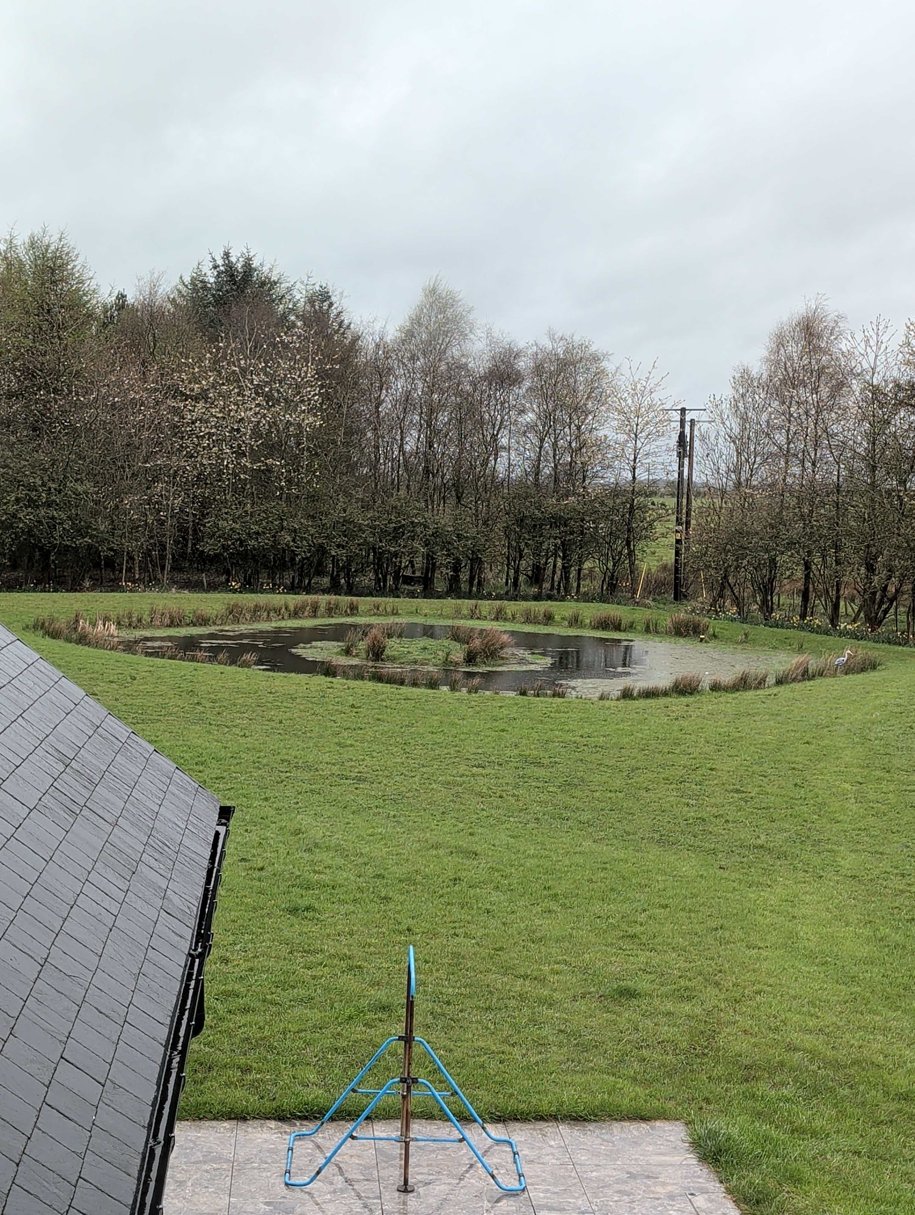

Show me your pond!
SuperJohnG replied to canalsiderenovation's topic in Landscaping, Decking & Patios
This is ours.. Bought fish, two times now. Just Goldfish, the second batch got about 200mm long last year , then one day the otter cam and that was that. We have had ducklings the last few years raised here. Pretty much there's always a Heron comes by, ducks usually there had geese. My son loves it in the summer, wife goes dipping in the winter ( we all done it Xmas day had to break the ice) . It's just a hole dug with diggers inflow from run off and outflow to the burn. The Clay keeps the level from not changing. It's great. -
