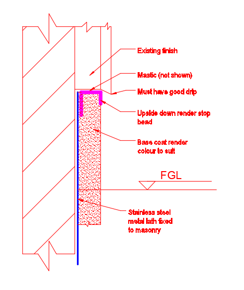

  5. It's not a metal plate..metal lath.. it is a lightweight mesh, easliy cut, bent and fixed. We often use this on base courses where there is a risk of frost and wet masonry below DPC level, proven to work, no significant bridging of DPC etc. Anyway, glad you have ruled it out. Often part of the design process is identifying what you don't want and this makes it easier to narrow the field. Let us know what you go for at the end of the day as interested.

  8. Much will depend on the amount the finish above overhangs the base course. Will something like this suit you?
