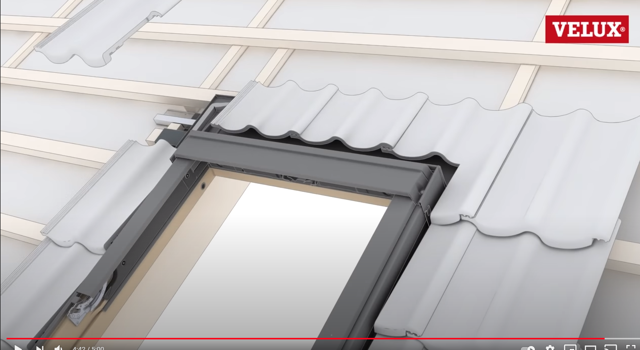

if the lead is not sealed under the window, water will find its way in as there doesn't look to be a cill on it ? if you watch the Velux install video i posted earlier you can see exactly how the tiles should sit, they need to grind off the nibbs at the back of the tiles so they sit flat. it wont help you with the small cuts though unless you move the Velux so that it works to the bond of the tiles. The job needs to be thought out from the start to take account of these as they are hard to fix after as you are finding. Its the difference between a competent builder and a not so competent one.- 45 replies
