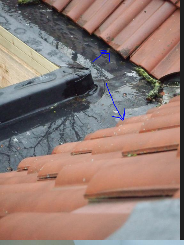

couple questions, what is the flat roof make up. is it warm or cold ? Did they lap the rubber up and under the bottom row of tiles all the way round ? Water will be 100% overflowing under those tiles and dropping into the roof. It's not great, id be inclined to get a professional in to re-do the lantern upstand and insulate it, pull down the plasterboard and see what state its in. If its a cold roof then there is no ventilation that I can see and if it was a warm roof the vapour barrier isn't up to much. so annoying the amount of cowboys there are out there.
is it a warm or cold roof underneath? Rubber all day long over fibreglass.
