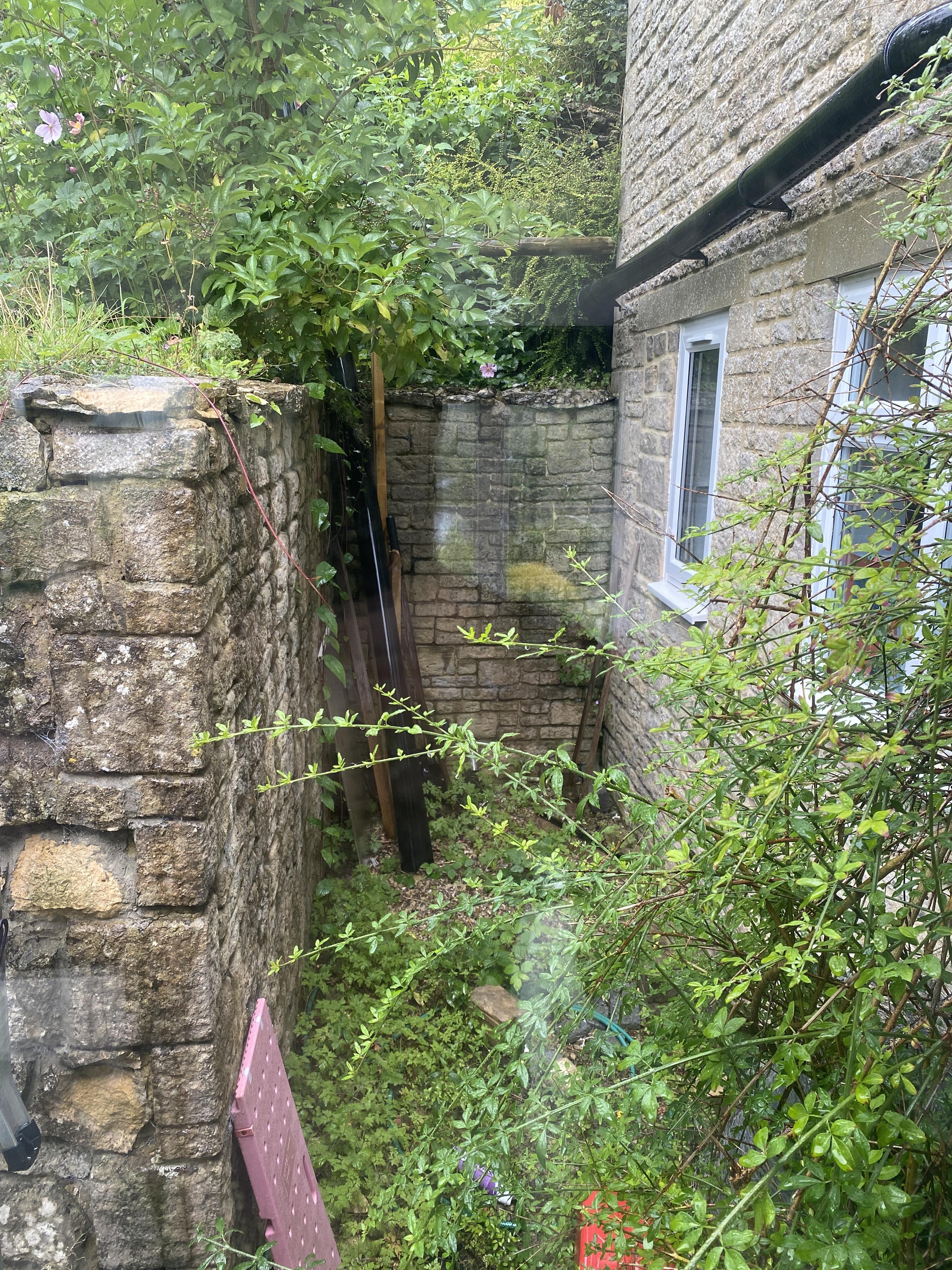

Filling in awkward space
CotswoldDoItUpper replied to CotswoldDoItUpper's topic in House Extensions & Conservatories
We definitely want it dry and not damp. Happy to not add any heating and it just take heat from the rest of the house - aga is the other side of the wall. Will have a door instead of the bigger window and the small window will be blocked up. will also be putting another fridge/freezer in there for overflow storage. thinking roof with a couple of small roof lights and then walls/floor of some sort to connect to existing kitchen. any advice on drainage for the retaining wall or if building control will need to sign off on it etc etc… -
We have an odd void outside our kitchen windows which we’d like to extend into to create a large walk in larder/pantry/prep kitchen/booze vault…. Can anyone give me an idea of what I need to do to use the existing retaining wall as the new wall of the extension? Obv a membrane/drainage system etc. but how do I determine if it’s structurally safe and or conforms to building regs.? as is it’s about 1.4m x 3.5m thanks!
