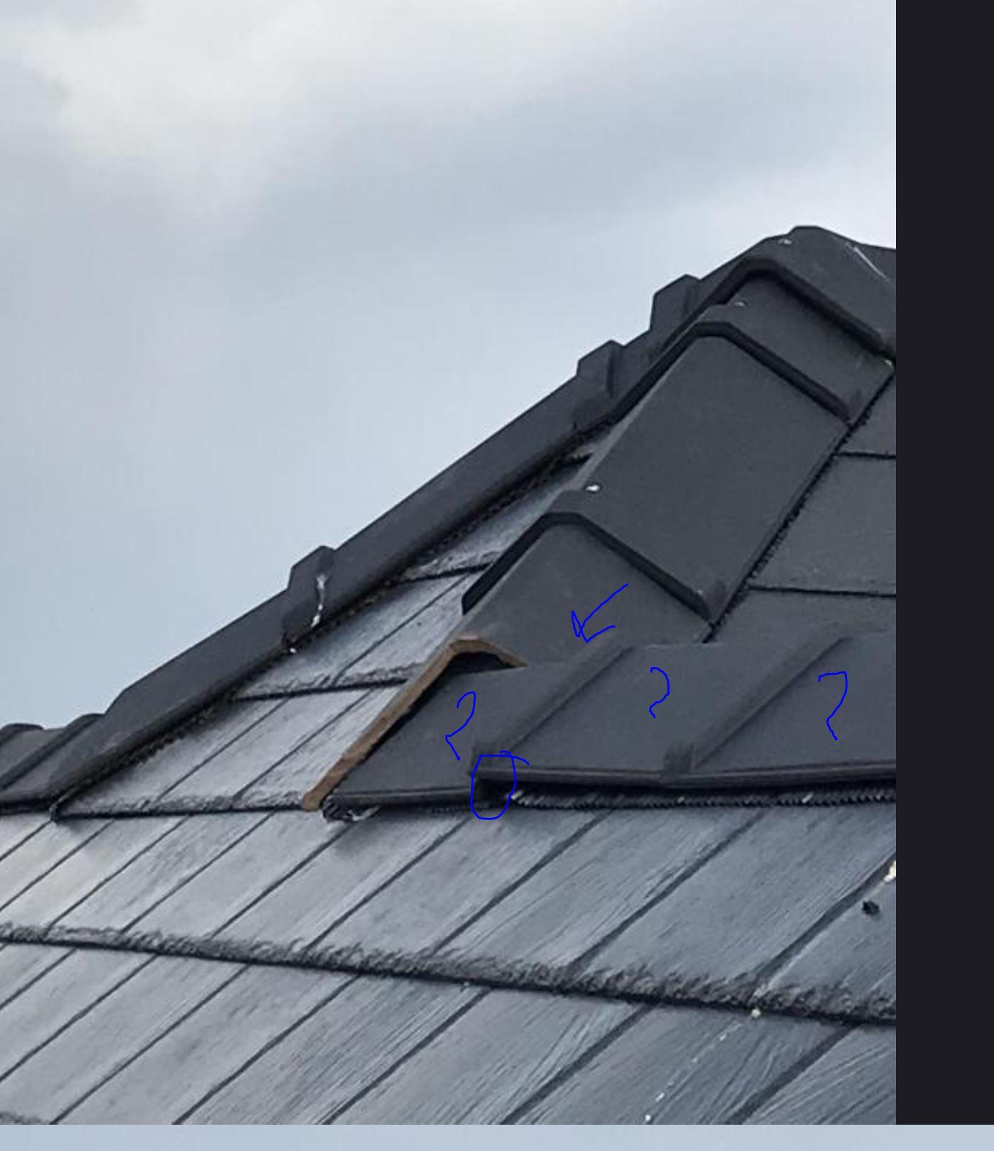

would a genuine builder have not foreseen the need for there to be room for the roof ? Can't help but think there is more to this than meets the eye. -
multiple problems here. Why have different ridge tiles been used ? The roof is slate/fake slate by the looks and they have then used conc ridge tiles that are totally out of character.? The junction from hip to ridge needs a lead soaker and then dressing to look decent. The ridge cut square above with a lead apron to dress it would look much better. https://www.roofingsuperstore.co.uk/product/tapco-synthetic-hip-and-ridge.html sorry but that is dog rough.
