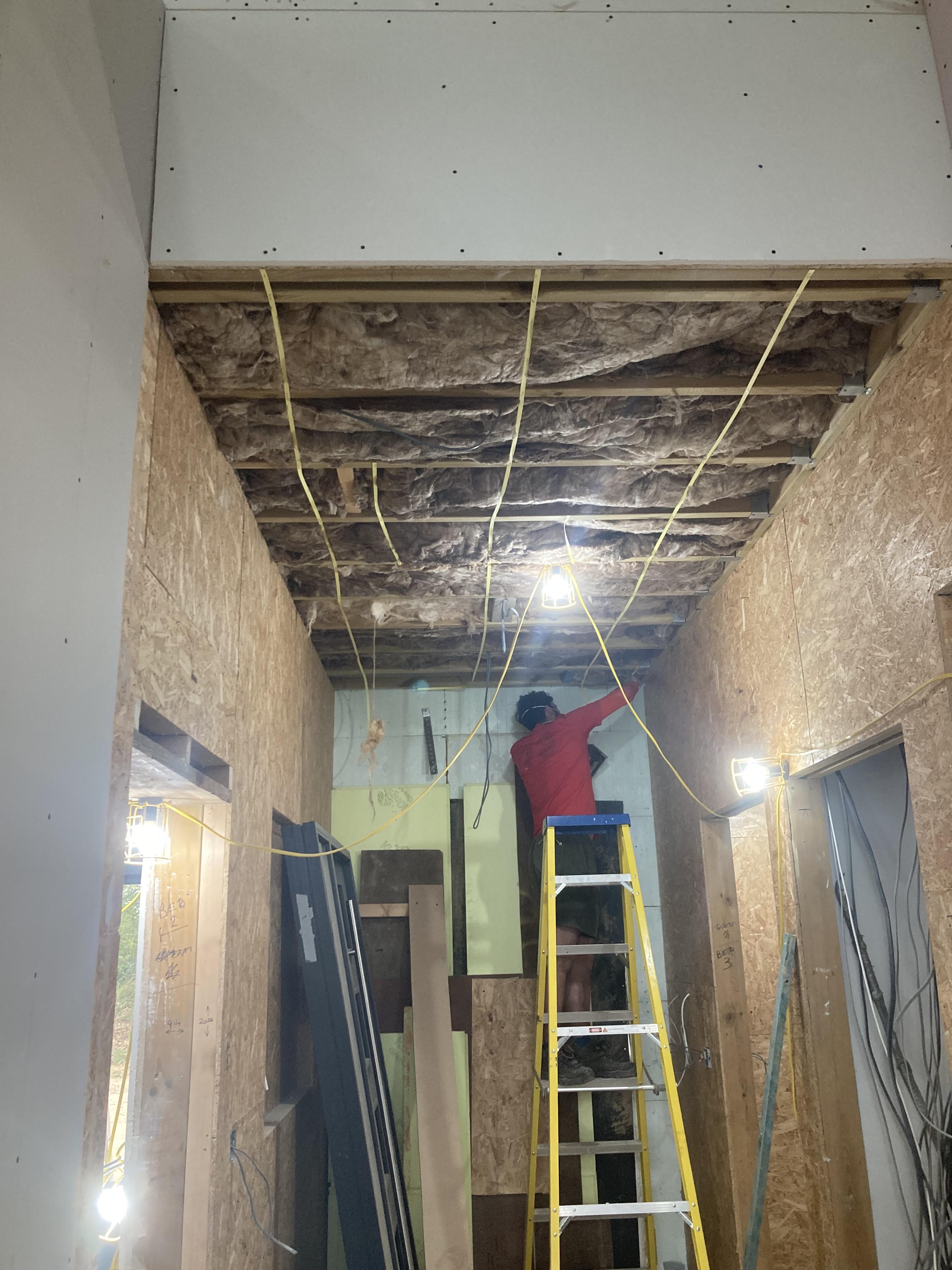

I think you are looking at something poorly done and think it’s all like that. why can you see through the wooden cladding ? Obviously it must be an open joint system, in which case they have obviously used an incorrectly specified membrane. do you want open joint cladding? Icf can be covered in what ever you want, you then just use the correct mounting system. there should be no reason you can see a reflective membrane under it and I hope for their sake it was all taped up or they will have all manor of creatures living in it. pic is timber on Icf.
