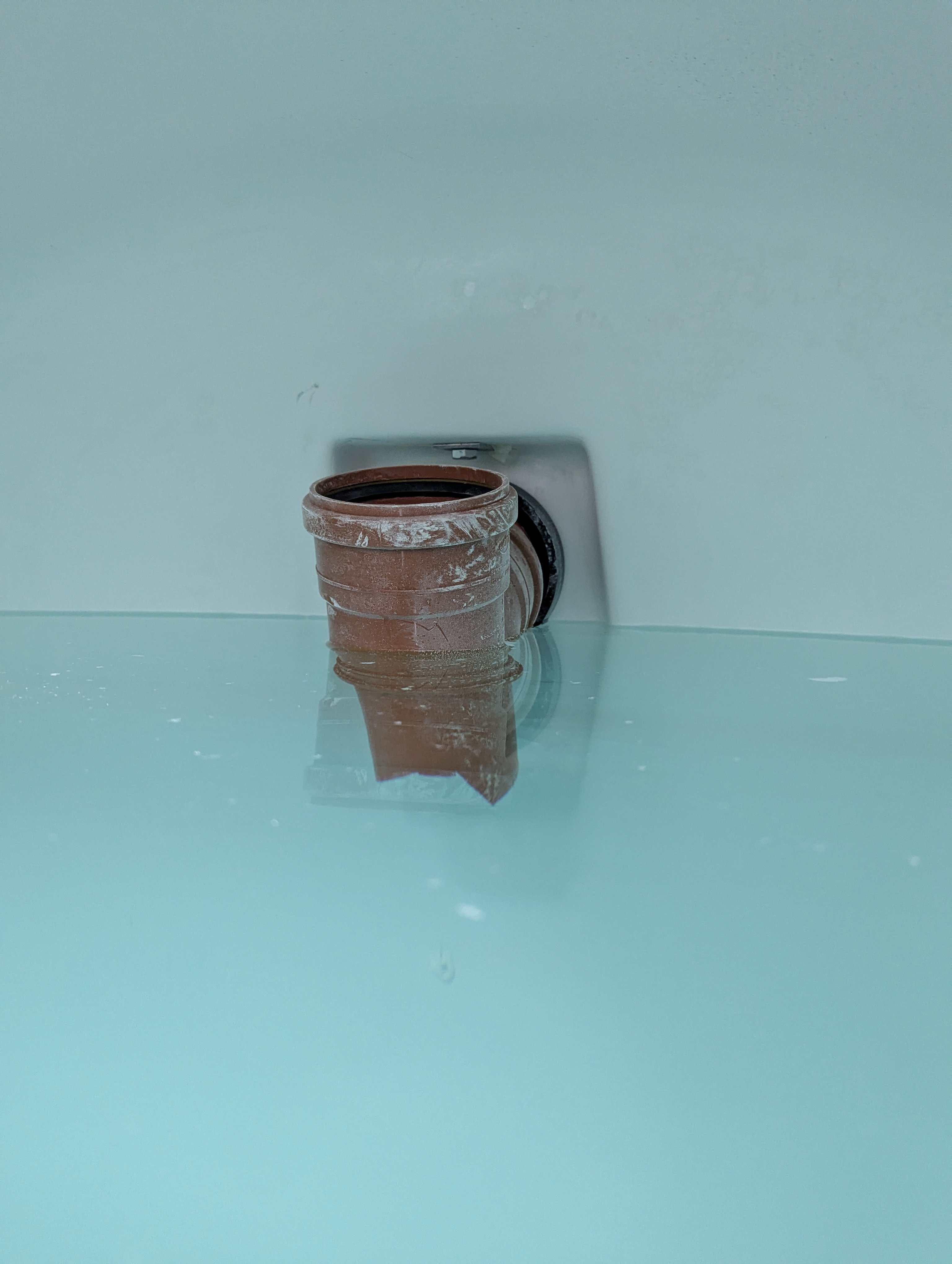

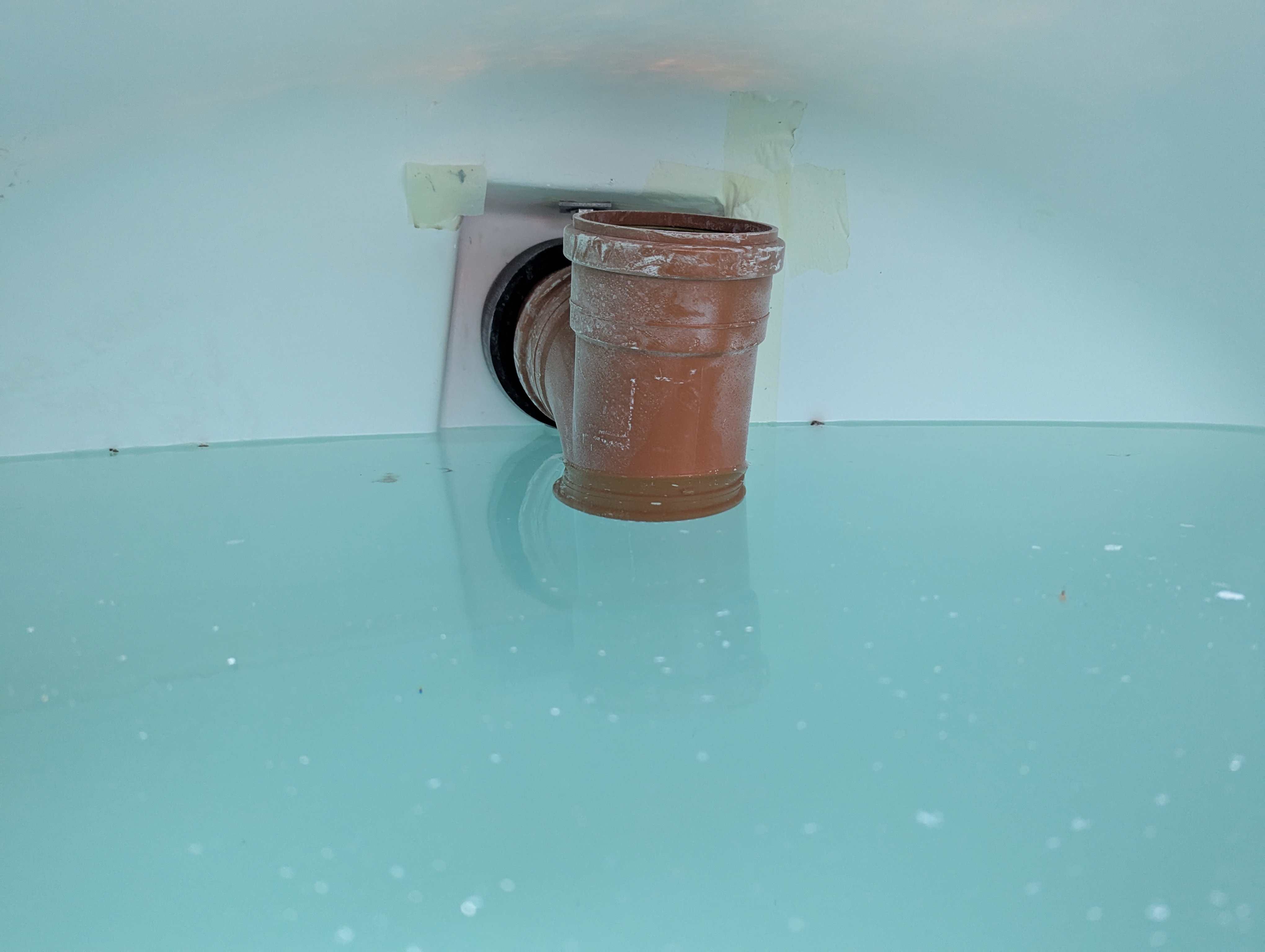

  12. This is the outlet yes it flows out fine! Thanks @nod
  13. Just concreted in treatment plant (marsh), and looked inside. The inlet T is below the waterline. It's filled with water and flows between chamber and to outlet fine. But I was just curious about this. Is this how it should be possibly to airlock/gases(?) In my head I was concerned about anything coming down having to be pushed down into the liquid below or it could cause a backup. Ok most stuff should sink, but was just not sure. Thanks!
