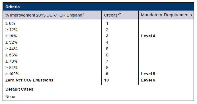

@Nelliekins I often see planning conditions asking for DER 10% (seems to be their favourite number) better than TER and/or DFEE 10% better than FEE. I suppose it depends how exactly the planners have worded this condition - if it states DER/TER equivalent to Code Level 4 (or similar wording) then its probably enforceable. It does however show a complete lack of understanding of the CfSH - Code Level 4 is a world away from Code Level 6 as table below from the last version of CfSH in May 2014; Getting a 19% improvement of the DER over the TER will be tough and probably not possible with fabric (insulation, glazing, air infiltration etc) upgrades alone. You will probably need to look at high efficiency heating (heat pump?) and/or renewables such as solar PV. I suggest that you clarify the exact requirement of this conditions (perhaps post extract here) and have your SAP assessor look at it asap - it will be tough and potentially expensive this far into the build. -
