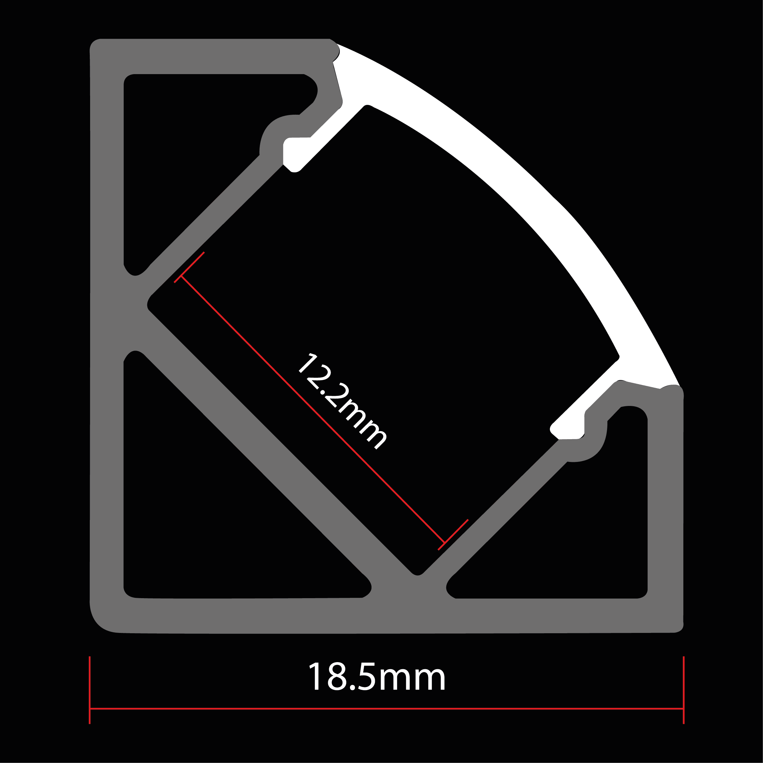

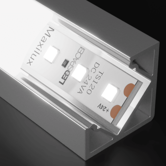

Take a look at this page.. https://www.ledspace.co.uk/pages/led-strip-kit-builders Their "kit builder" works out what you need to make complete mains powered light(s) including the power supply. It works out which power supply you need based on the length of the light fitting and/or number of fittings. I don't think the power supply fits in the channel if that matters. I'm sure someone must make a similar ready assembled unit if you don't want to build one.
There are also things like this.. https://www.ledspace.co.uk/products/flat-corner-led-profile?currency=GBP&utm_medium=cpc&utm_source=google&utm_campaign=Google Shopping&campaignid=14654411474&adgroupid=128524150738&keyword=&device=t&gclid=CjwKCAjwsJ6TBhAIEiwAfl4TWPewxg9PtEarXrFsksh6yetRWdh3Sep9GRwV_yek5PZFSSbY3XdcMxoCRaIQAvD_BwE
They look perfect if the heads fit the brackets. I would buy a few spares and drill holes in some scrap wood of same type to work out what pilot hole to use on the real thing. Don't want them to be so tight you shear off a head when in the wall.
