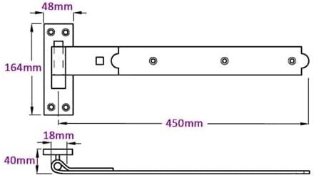

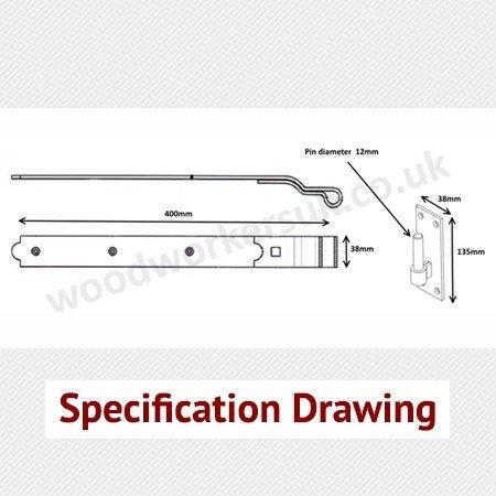

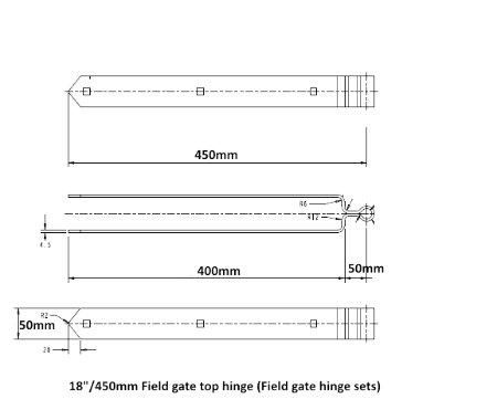

Are there marks on the other side? Was it a simple cranked hinge (19"?) or like a field gate that wrapped around the end (24"?)
