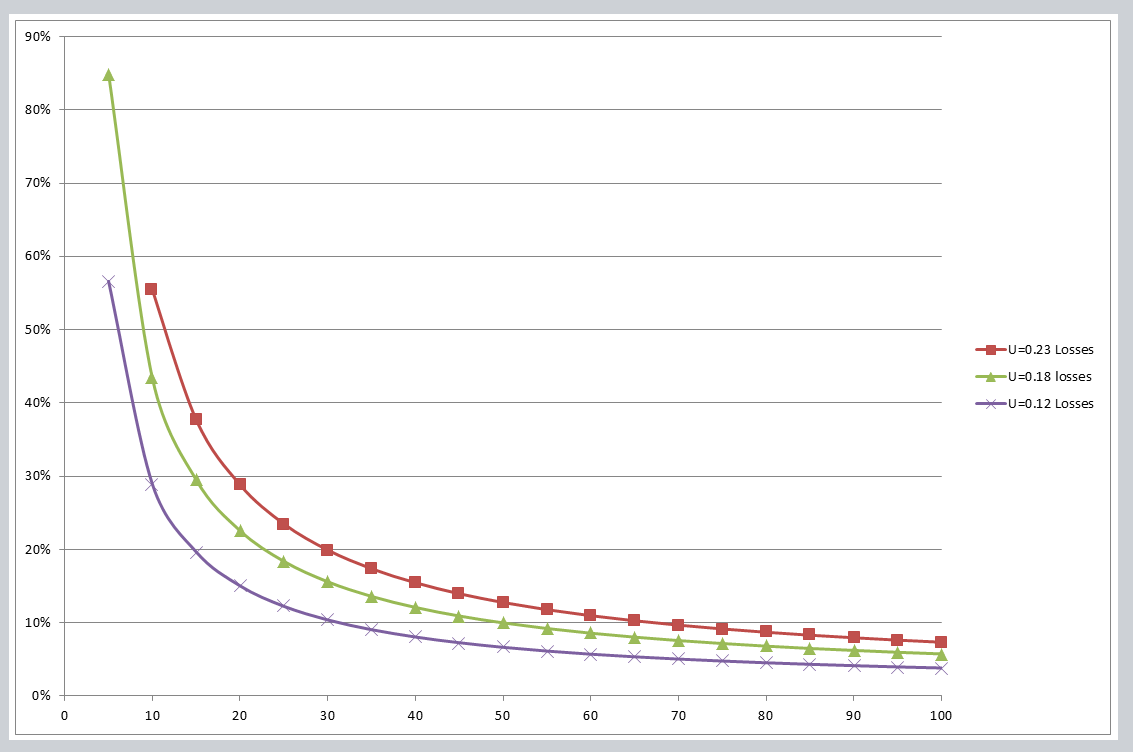

  24. I agree with the loss calculation, what I'm not so convinced by is the significance of it. What you're showing is that underfloor heating is a bit less efficient than radiators, when the radiators use water at the same temperature as the underfloor heating. That seems entirely reasonable to me, but it also doesn't seem like a very real-world situation - unless you're using fan coil type radiators then using the entire surface area of the floor as a heating surface is going to be pretty hard to equal. That isn't really a problem in a very well insulated house since the heating requirement is very low and "normal" sized radiators are now drastically oversized and will work just fine. It's a bit different in a less well insulated house, say at the 50W/m2 point. A smallish 10m2 room would need 500W - that puts the floor temperature 5C above ambient and the water temperature no more than 30C. A heat pump is operating at peak efficiency and a boiler will be fully condensing at this point - perfect. The correction factor seems to be about (air-water temperature difference/50)^1.344 - so to match the underfloor the radiator would have to be 8.7 times larger than the book value - i.e. sized for 4.3kW. That means specifying a triple panel 600 x 1800 radiator for a room 3m x 3m! Now realistically you don't need to match the low temperature of the underfloor heating to get all of the efficiency gains from the rest of the heating system, and that gets you away from ridiculously big radiators (at 40C you're down to a 1.7kW radiator for instance) - but there is clearly a risk that by optimising to reduce total heat losses from the building you're increasing rather than decreasing total energy demand, depending on how your heating system of choice reacts to varying output temperatures.
  25. Err... not convinced by that. Very crude spreadsheet model. X-axis is the heat provided to the whole house in W/m2. That is then used to work out floor surface temperatures and hence losses through the floor for three insulation levels, given as a percentage of the total heat loss for the house. For a well-insulated house, floor heat losses form a significant proportion of the total. As heat losses elsewhere become more important, however, the quality of the floor insulation becomes much less important as a fraction of the whole, and the heat loss impact of using underfloor heating becomes less significant. For a gas boiler you're probably better off using radiators still (just - the impact is small enough that you **might** get it back from improved condensing), but with a heat pump I think it's pretty clear that the lower flow temperatures and hence improved COP from the bigger emitter area would make underfloor heating helpful - although in a retrofit case I suspect it's unlikely to be economic.
