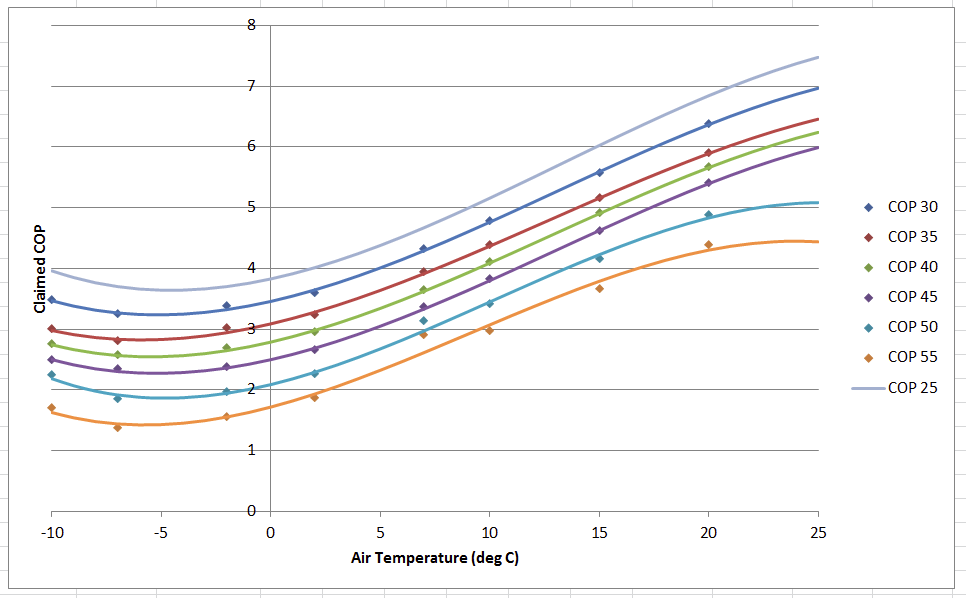

Actually, I think that's looking at the wrong problem, or rather installers tend not to understand the problem. Fundamentally, heat pumps are limited by the Carnot cycle - where the most critical parameter, temperature difference, is outside the control of the installer. This is taken from published Samsung ASHP data, with a 25°C line extrapolated since the pump can run with an output temperature of 25°C but no published data is available. It appears to be pretty representative for most modern heat pumps, but probably assumes perfectly dry air. This illustrates two key points: Performance - whether measured as SPFH2, COP or anything else is critically impacted by flow temperature. There is a lot of concentration on the heat pump behaviour, but the single most critical thing is improving the insulation and fitting a system which can provide heating with a very low flow temperature (both are required together, realistically). If put in at the design stage of the sort of house most people on here are looking to build, I think 25°C flow temperatures are entirely realistic. Higher flow temperatures or poorer insulation, and the maths is rather different. Even the COP at 55°C is really rather good in warmer air temperatures - and the UK is actually quite a warm place. Taking London as an example (yes, I know it has a heat island effect - but it also has an awful lot of people living there), you'd be spending 6 months of the year achieving a COP of nearly 4 on your hot water, dropping to 2 or so in December and January. The point is that the SPF value for hot water should be a lot better than the EST figures suggest, because they're mostly taken from people with big heating loads which are predominantly in cold weather - hot water use is spread out over the year, and so the average dT will be much lower than the SPF figures at 55°C would suggest. -
