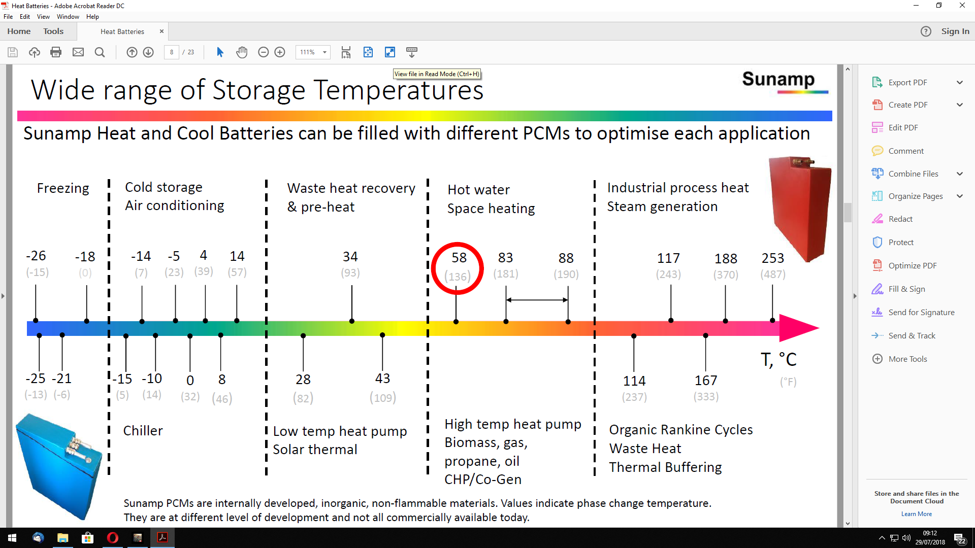

If you look at their promotional material they say that a number of different PCM operating temperatures are possible, with PCM34 and 58 currently being the focus. PCM43 is particularly interesting to me because it looks like it might be in the sweet spot for providing DHW from a heat pump - the output temperature should match nicely to the temperature downstream of a scald protection TMV, while the charging temperature should be within the temperature output capability of most heat pumps. I have a suspicion that they may be aiming it at the UniQ rHW device (integrated into a heat pump, with the refrigerant circuit being used directly to charge it). Unfortunately that will be an OEM-only option, and nothing has yet been released about when or if this will become available.
