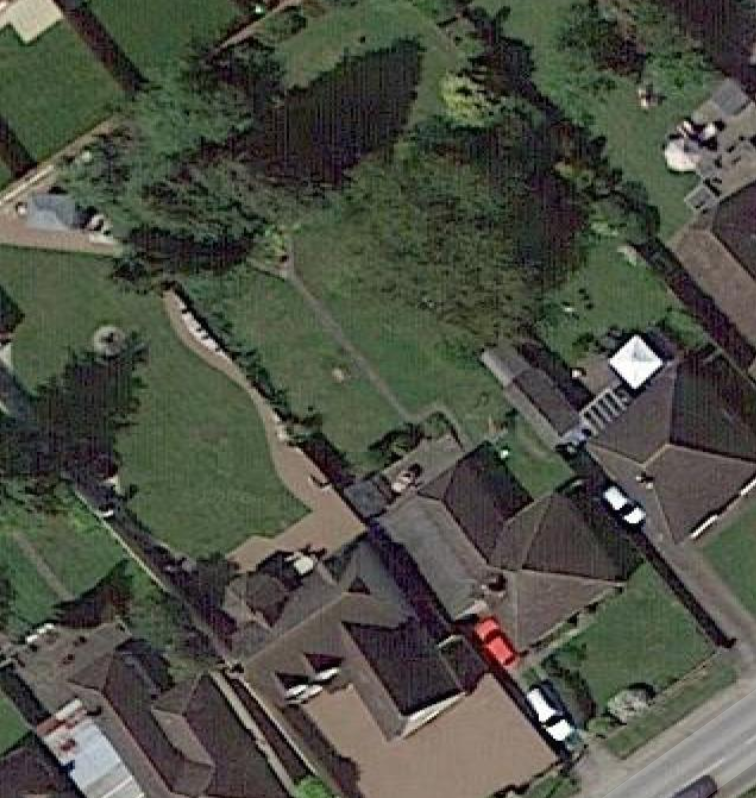

Current footprint is fairly small (136m2 including the garage on a 900m2 plot), the model I've got has a footprint of about 170m2 which doesn't feel unreasonable (19% of plot). The current shape factor is pretty poor, however, so the increased footprint doesn't really make a huge difference - it's mostly coming in otherwise awkwardly shaped bits of grass at the side. I've been wondering about fitting a bathroom to the second bedroom - it's an awkward shape so fitting one in wouldn't be a major drama. That tentatively would be the guest room, so would make the most sense (my in-laws live in South Carolina, are retiring in a few months and our children are their only grandchildren - so I would expect some extended visits in our future). The mixture of VAT and complication are what killed it last time - by the time we had sorted out the various problems we ended up with a relatively small house which was badly compromised and a handful of not very nice walls. The QS estimate was nearly £400k+VAT for a 160m2 house. At least one quote explicitly said that it would be cheaper to knock down and start again than extend. No asbestos survey done to date - for now I'm going to allow a provisional sum since it's safe if undisturbed but if we find something there is a risk that we'll have to deal with it and rectify even if we can't afford the build. It's a 1920 original extended in the 1970s so I need to assume that there is Asbestos present but I haven't spotted any of the usual suspects yet. Current assumption is a static caravan in the back garden, most likely scrapped in situ at the end because the cost of a very large crane to remove it would exceed the value of the caravan. Having services already available makes that a lot more tolerable. Certification is an open point, the quality control aspects of it are worth money in my mind but the standard itself is somewhat arbitrary. If (when) the budget gets tight that's something we would drop. It certainly isn't for money reasons. I'm pretty sure that an airtight door on a garage would be against the rules (carbon monoxide risk - would certainly have a CO alarm in there linked to the house fire alarm in any case). I'd only extend the underfloor to it (on a separate circuit) if it was really cheap to do so. The logic for having the garage there is that we want it to have a weather-protected link to the house and having it side-on completely eliminates any chance of having a semblance of a garden at the front (as next door has done). I've tried to value-engineer it where I can do so reasonably subtly - the shape is part of that, and I've done a few things like sizing the 180 degree turn on the staircase to be part of the frame so the staircase is cheap and simple. Until I start doing a cost model, I won't be able to really understand if I've got it about right however. Part of the logic for the downstairs shower was that it's a relatively cheap way to achieve an extra bathroom, with the benefit of helping future mobility-impaired people who visit. At the moment it has 3 bathrooms between 5 bedrooms, which isn't too bad. Adding an en-suite to Bed 2 does look like a logical change though. My dad has Parkinson's, which may or may not run in the family (his father and brother died of it, but he's been tested and doesn't have any known genetic risk factors). That means I may need it if we stay long-term, and putting it in now is relatively cheap and easy. I'm really not sure if there is any sensible way of adjusting the floorplan to give them some sort of private social space in 10 years time - then again I'd be quite happy hiding in my study (I'm somewhat outnumbered - we've got two girls and even the cat is female) and my wife will probably be as happy curling up in bed as anywhere else, so I think it's feasible to adapt. One of the headaches is that the garage means the ratio between upstairs and downstairs is wrong for us - we'd really like it a bit smaller upstairs relative to the downstairs volume, but I don't see an easy way around this. That's one of the things I want to go into in some proper detail - what we actually want is relatively austere, and there are quite a few things we wouldn't finish until some years later (only doing first fix on most of the bathrooms for instance with me doing second fix later) if it meant we could do the house. That way I can do the working out how bit a house we can afford and whether that's acceptable to us before we start paying professionals to tell us the same thing. Budget is probably a bit below £400k but not massively. Going much above that means it has to be a really special house however, as it would probably take us into needing to sell it at a premium if we ever move given what we bought the current house for.

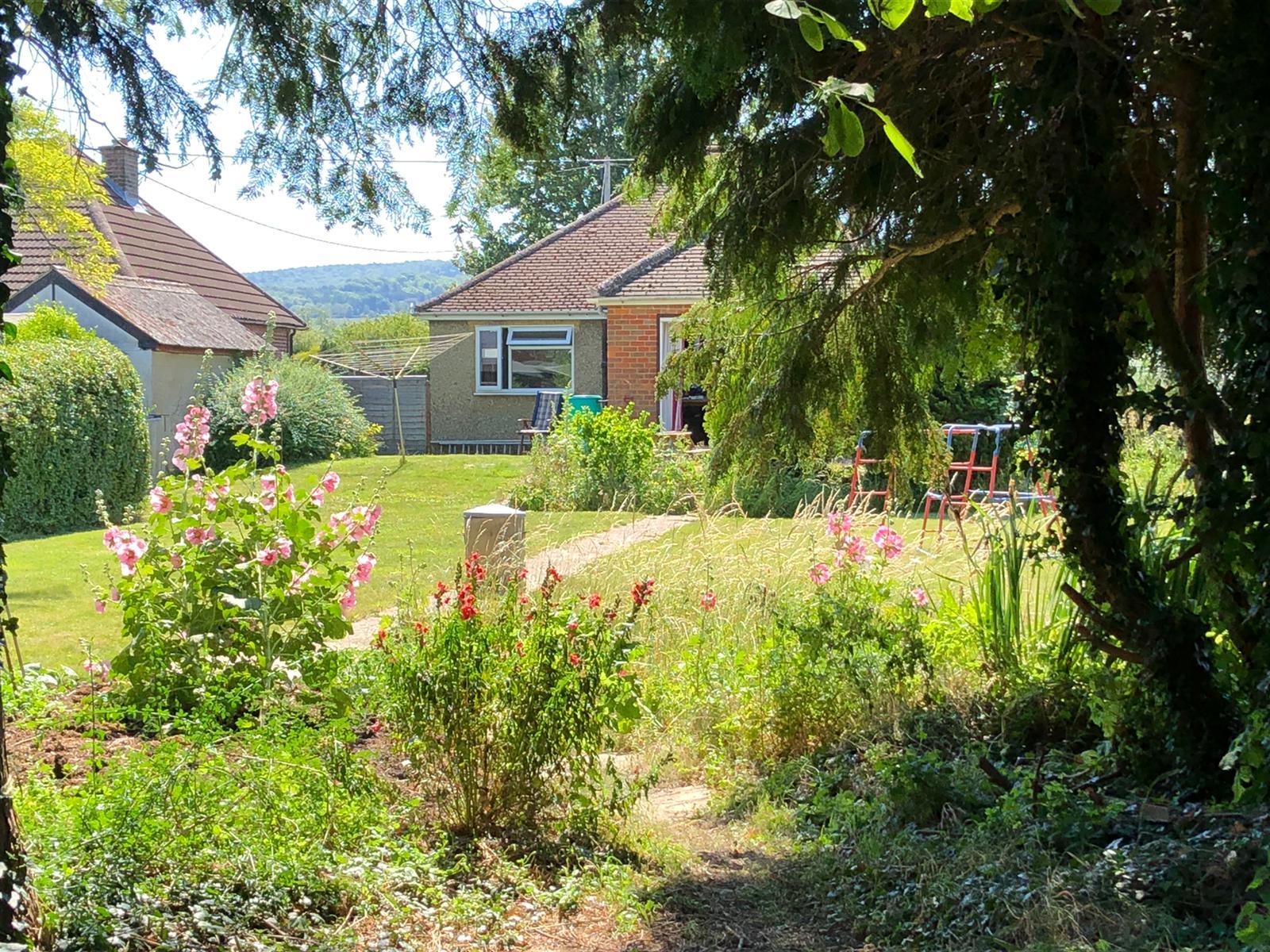

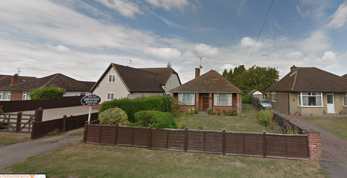

Having been stung last time around (emotionally at least - financially we stopped before we spent too much) when we started down the retrofit+extend route only to find out it just wasn't viable, I'm trying to be quite cautious with whether we can knock down and rebuild our current house. Can I please ask the buildhub hive-mind to take a look at the attached floorplans and comment if they make sense? The idea is if they aren't too far out I can try to build a cost model based on them with some level of confidence it will be accurate before going down the route of modelling it in detail, applying for planning permission, etc. We're both in our thirties, working full time with two young children and retired parents who might on occasion stay for extended periods of time. We're in a commuter village in Buckinghamshire, just outside the edge of the green belt. Target would be Passivhaus, probably certified (I'm an engineer and not properly validating it would really annoy me). Most of the model should be obvious. Stairs extend up to the loft (warm roof) with a Velux above them in the rear roof - my wife is a hoarder packrat and the only way to stop her leaving stuff everywhere is to make it really, really easy for her to store it somewhere I won't always be falling over it. I've also assumed dormers to the rear to bring the ridge line down without compromising the ground floor space too badly - it's currently ~1m taller than the house next door and without them starts to look a bit big. First Floor Model.pdf Ground Floor Model.pdf

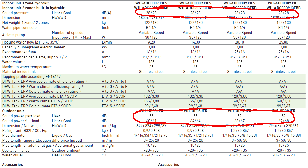

Spec sheet says otherwise - the internal unit is always 28dB(A), outside units are between 55 and 69 dB depending on size and load. Remember that fridge compressors are essentially inaudible in modern fridges - my fridge makes a weird squeaking noise (fancy expansion valve?) but that's it. A well balanced sealed compressor should be all but inaudible. -

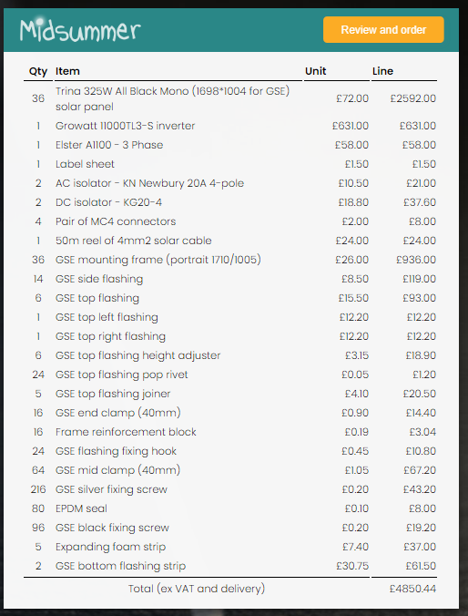

Trina 325W All Black Mono (1698*1004 for GSE) from Midsummer appears to be £72/panel from Midsummer Wholesale at trade price (assuming the values quoted by easy-PV are correct - it looks like a trade-oriented tool, but they might just be out of date), £100 at retail. Even at retail it isn't too bad at 32p/Watt, it's 22p/Watt if you get them for £72. Edit: while I think about it, easy_PV has a tool to let you model up flashings, spacings, etc, on the roof with GSE mounts.

That was part of our thinking too. Problem is, the same logic applies to new build - which is cheaper in both time and materials, so you're still better off starting again. Unless you keep the external works pretty minor, the house isn't going to be a lot more habitable while it's all happening either. That would make me nervous given what I know the neighbours found. Again, it depends what you're doing - a minor loft conversion probably won't change anything significant and you'll get away with it, the risk is that you're pushing towards the borderline of a world of pain - and you might not find out until you've done quite a bit of work.
