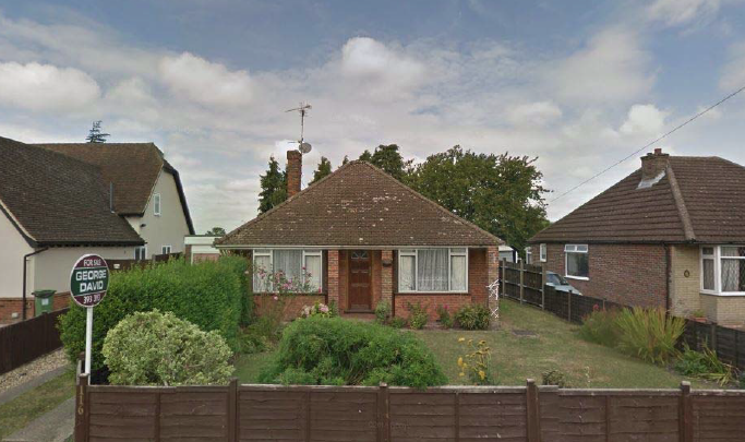

A little bit of background for you, we did a fairly comprehensive refurbishment of our last house (keeping the walls, roof, windows and not much else) which gave us a house we absolutely loved. 18 months or so ago I started a new job which was a hideous commute (particularly with two young children), so sold up and finally bought a new place over the summer. I'm a principal mechanical engineer working in the aerospace industry, so have a good grasp of the theory but realistically with two toddlers am not going to get any significant amount of hands-on work done myself. What we've ended up with is a 1920s bungalow in a nice (large) village, with a huge garden and a 1970s extension on the back. Location is great for us - halfway between where we both work, close to nursery and schools and the kids love the garden.The original plan was essentially a glorified loft conversion, with stub walls to expand the usable floor area a bit since the footprint of the original house isn't all that large (55m2 or so). Doing so would also give us a chance to sort out some of the issues with the existing building - solid walls and ventilated suspended floors mean it's pretty chilly/draughty at times. Found an architect we liked, who came up with a scheme which seems to work and which we should be able to get planning for (very similar to what the house next door did 10 years ago, and they're also building 50 similarly sized houses at the moment at the bottom of our garden). That got modelled up in PHPP and it looked like EnerPHit (which had been an aspiration for some time) might actually be possible. Then we got the quantity surveyor report on the expected price for everything we would like to do (phased over a number of years), and that's where the plan sort of fell to pieces. The value came back at ~£400k including contingencies and VAT for a 150m2 end result - nearly £3k/m2 and it also came back with several quotes from timber frame companies saying that they could knock it down and build from scratch for less than the cost of just putting a new floor on, with one noting that they should be able to reuse the existing foundations to save money. As I see it we've got 4 options at the moment: Find quite a bit more money than we were expecting to and go down the demolish/rebuild route. This isn't totally impossible but will be very tough and delay things substantially - our current mortgage has some fairly huge early repayment fees for the next 18 months, for instance, but my wife has just gone back to work so we could probably borrow quite a lot more when it comes up for renewal. Emotionally this is what we'd like to do but I really am worried that we can't afford to do it. We should break even on this option in the long term, but getting sufficient cash to do the work would be problematic. Scale the plans back seriously and do a simple loft conversion complying to building regulations. I don't think this will give us what we're looking for though - in particular we want our bedroom to be on the same floor as the kids (currently 1 and 3), which wouldn't be possible without raising the eaves, which takes us back to Plan A. It would also leave the house uncomfortably cold in winter. Get planning permission then try to sell it on to someone with a bigger budget than us. Unlikely to add much value but would at least potentially mean the work so far wasn't wasted. Live with the existing structure as it is, giving it a bit of a wash & brush up (getting rid of the geriatric wallpaper in the bathroom for instance) and move on in a few years. I'm guessing that quite a few of you guys will have gone through exactly this sort of experience before, so I'm wondering what if any comments you have on our options.
