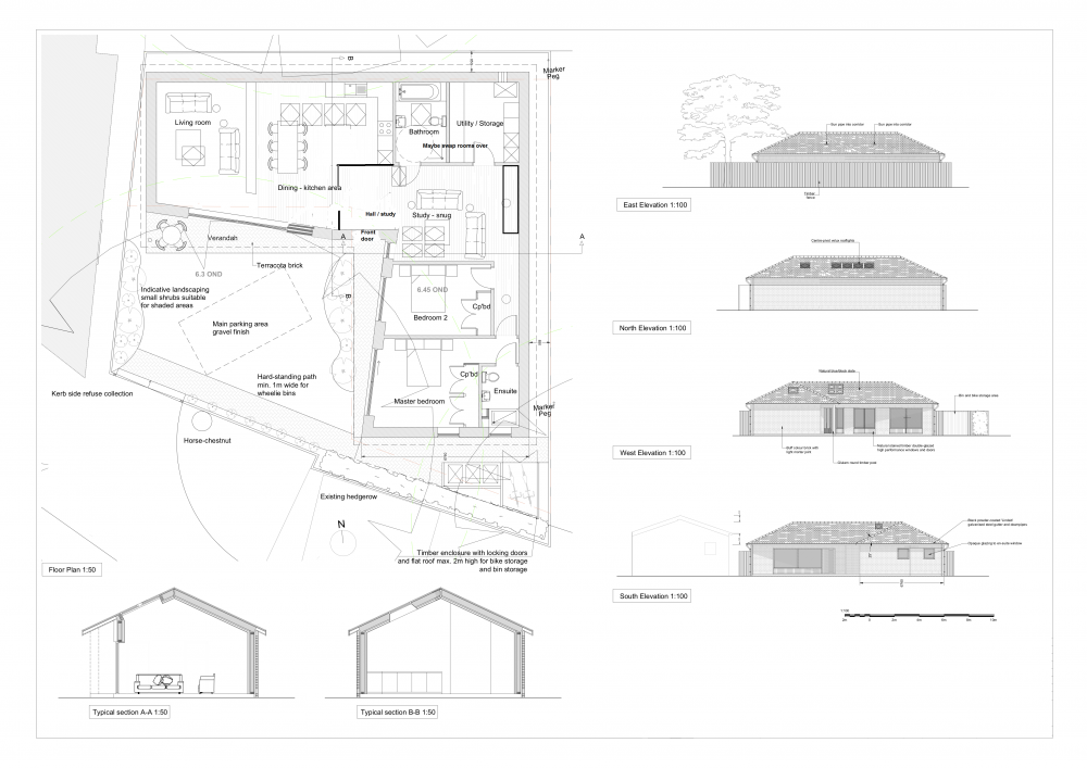

Floor plan — comments welcome
Mr Punter replied to Dreadnaught's topic in New House & Self Build Design
Not too keen on having the front door directly into the main living space. Did you see @AliG's plans for a bungalow? I thought you could do similar and incorporate the hall and study space by moving the front door. -

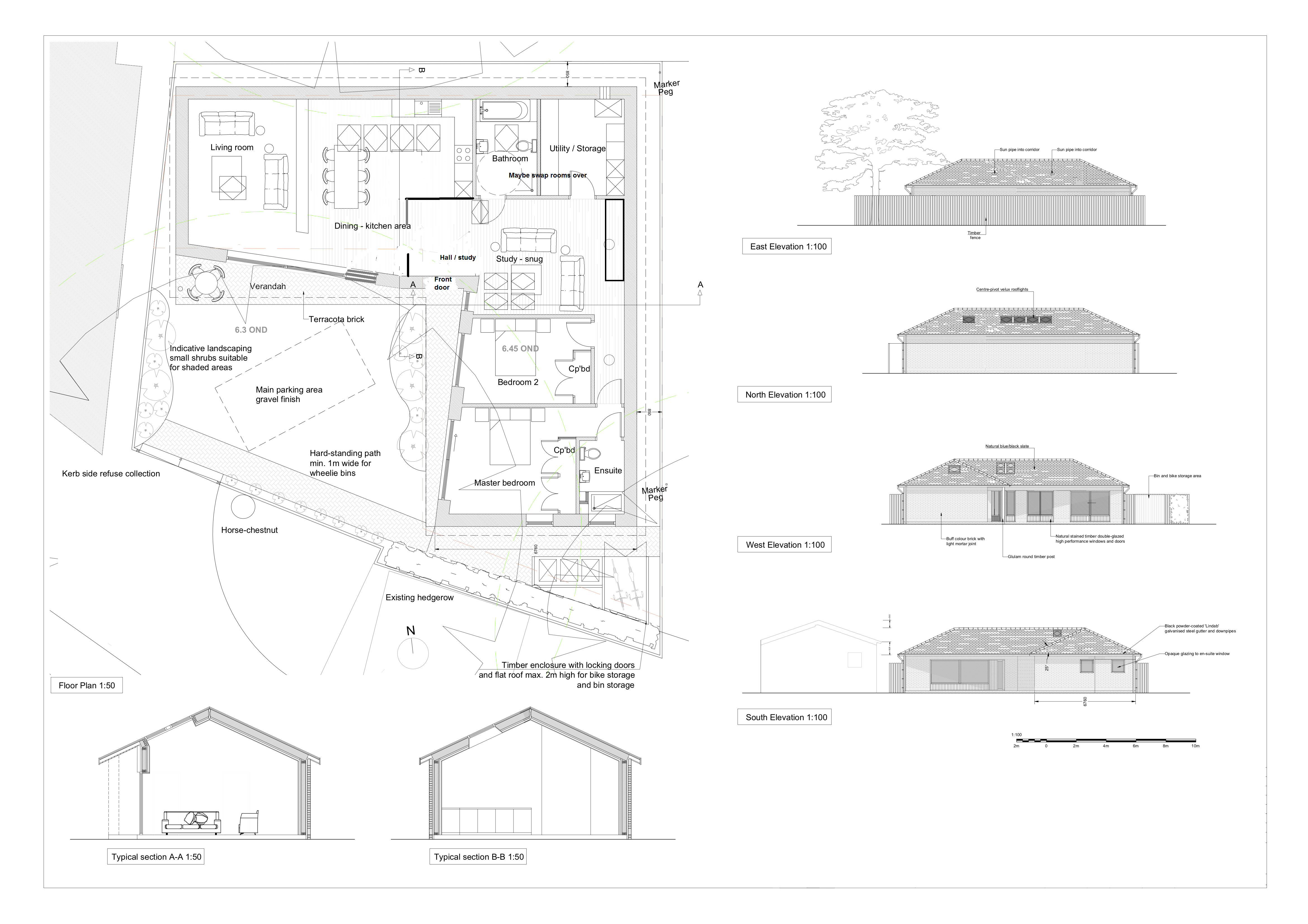

Floor plans (v5 and counting)
Mr Punter replied to Bored Shopper's topic in New House & Self Build Design
A shattaf! -
