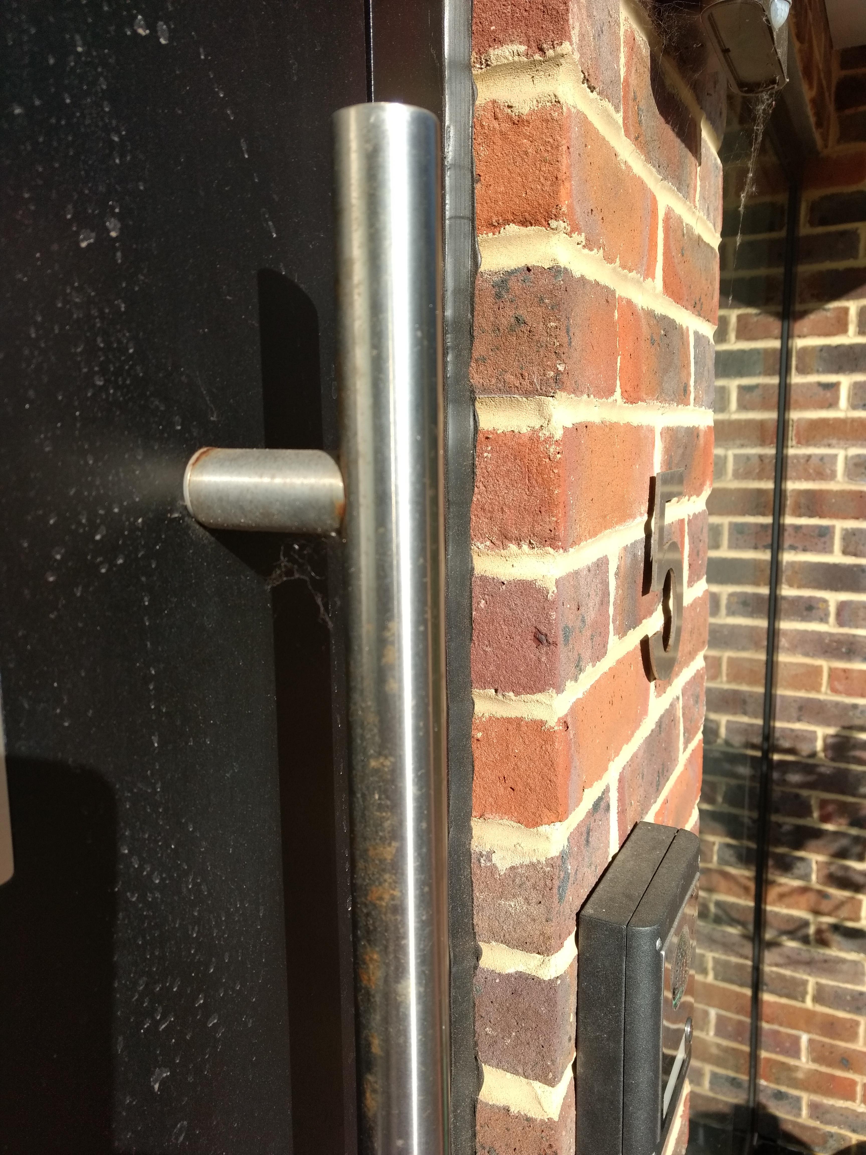

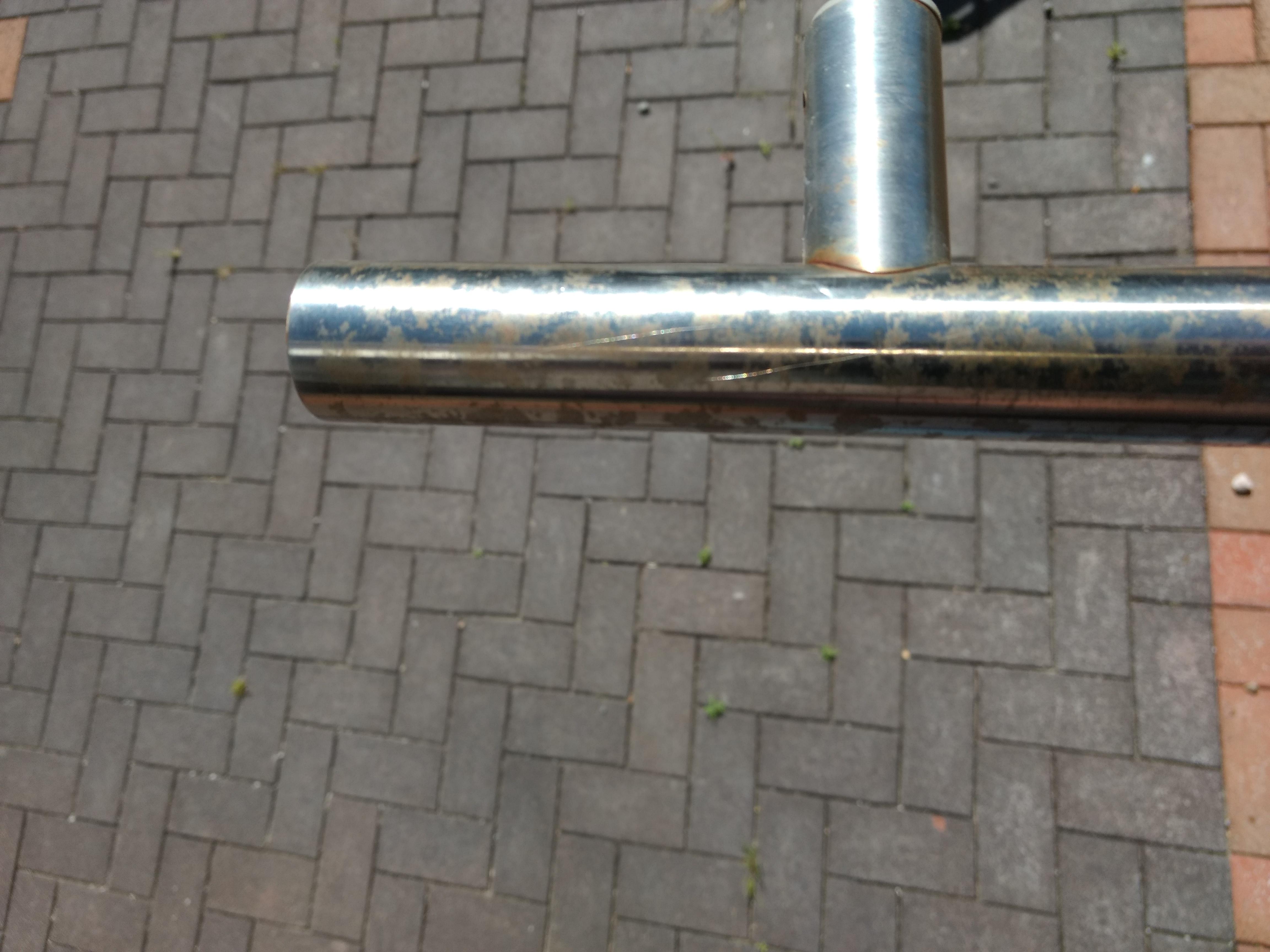

Corrosion of 316 stainless steel door handles
Mr Punter replied to Mr Punter's topic in Building Materials
Perhaps @pocster may want to look at this before he orders his front door. -
@joe90 what result do you need? You should get less than 5 without even trying.
Thanks Jeremy. I did the magnet test and it is non-magnetic. The door people say it is 316 and I have no reason to disbelieve but I cannot work out why they look so bad. The door people have just got back to me saying "I appreciate that you spent this sum of money with us and in return we provided goods and works to the value of £29k. However, that does not remove the responsibility of the properties occupiers to maintain the goods in an appropriate manner and it would appear that no maintenance has been undertaken since the doors were fitted. This is not our responsibility to rectify and whilst I understand you feeling our position is not satisfactory, it is not unreasonable given the circumstances. I take no pleasure from these situations and it’s saddening to see our product neglected to such a condition." I really did not expect to have a maintenance program on external stainless steel handles! -
The current development has a fair bit of stainless steel externally - most of it is 316 grade. We have lots of horizontal balustrades, as well as lettterplates and escutcheons. All have performed well except for the front door handles, which appear a bit corroded. We have 8 of these doors on the development and they cost £3,600 each. They were installed less than 18 months ago and when I contacted the manufacturer they did a sloping shoulder, saying they should be cleaned with specialist product. I would not expect door handles to be subject to some regular maintenance routine. What should I do?
