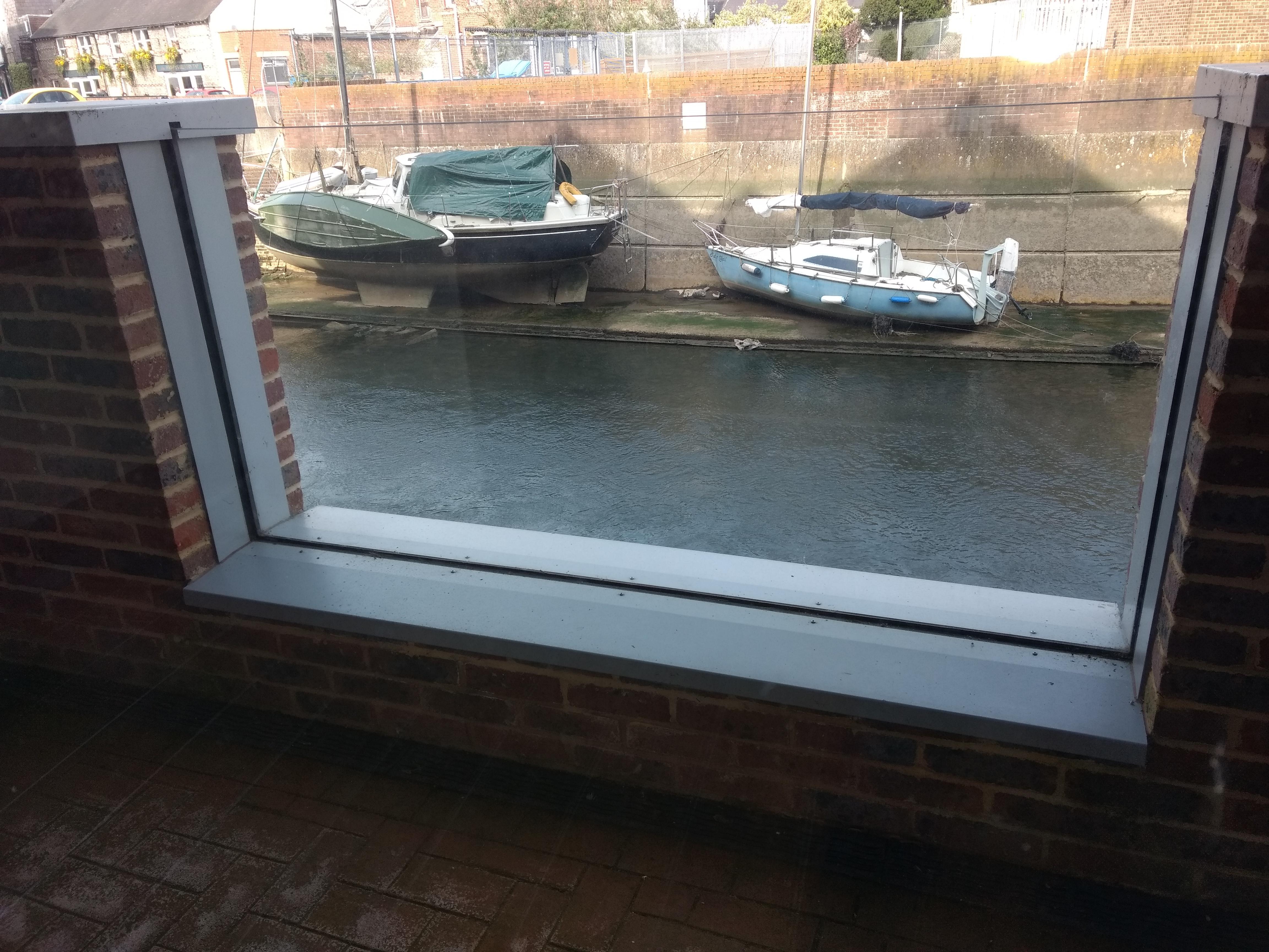

  6. I would not bother trying to cast the channel into the concrete as if it is not spot on it will be difficult to remedy. Also the channel will get filled with all sorts of crud. We have put in some glazing where we used a recessed ali channel but formed the recess out of timber slightly over sized. We still needed to adjust some bits with a grinder and bolster. Ali trims all round. Ours slotted into the sides as well because it needed to act as a flood defence. Have you worked out floor levels with the insulation, waterproofing and fall required on the terrace v 1st floor floor?
