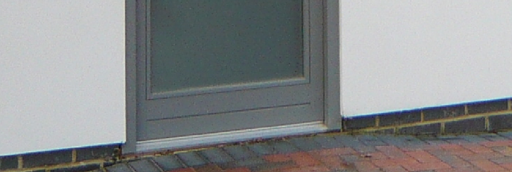

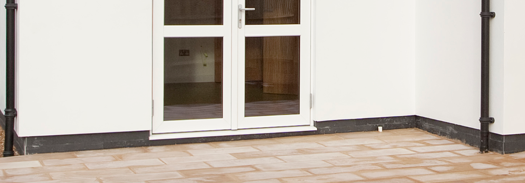

K-Rend Bead Thickness and Fixing Instructions
Mr Punter replied to Triassic's topic in Plastering & Rendering
Not me rendering! Either a bell cast of the same depth as render or a stop bead. -
Not very good ones but the top one is render onto cement board, the bottom one to blockwork. I just don't like the massively flared look with some bellcast beads. -
