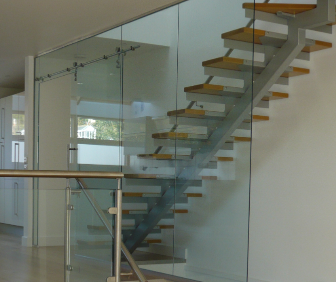

  22. With this one the manufacturer used a piece of metal as a downstand at the front of the treads to satisfy the 100mm sphere rule.
