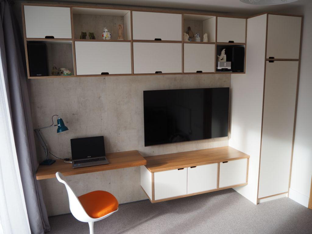

Typical architect! Ours is a fake, although they probably claim it is "inspired by"... The picture is my wife's office. Mine is downstairs and is a lot messier, or more practical as I prefer.
Pickawood. They are based in Germany but manufacture in eastern Europe. You design what you want and can specify sizes etc. It was good for us as I wanted to house a printer, some filing, speakers, vacuum, ironing board etc and I did not want any sockets and cables. The desktop for the laptop was from someone over here. It was quite expensive to do but this room gets used a lot.
I have got the Urban Concrete in a TV / office / spare bedroom multi function room. I battened out the wall to run cables behind and had the furniture floating(ish).
