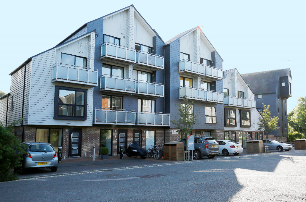

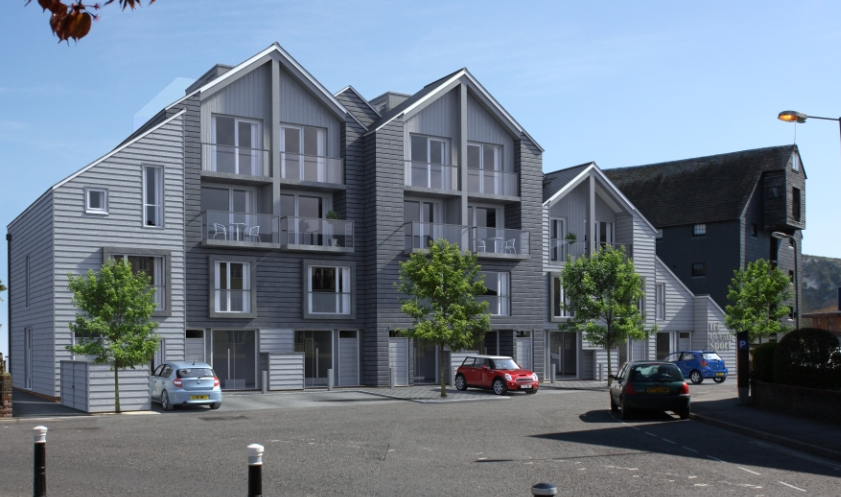

Ugly House to Lovely House New Series
Mr Punter replied to Ferdinand's topic in Property TV Programmes
It did not improve the image of architects. They did not make the ugly bit any better and in fact spent almost no time or money on it. Just added an unpleasant extension at strange angles. Given the £200k + and three years, it was woeful. -
