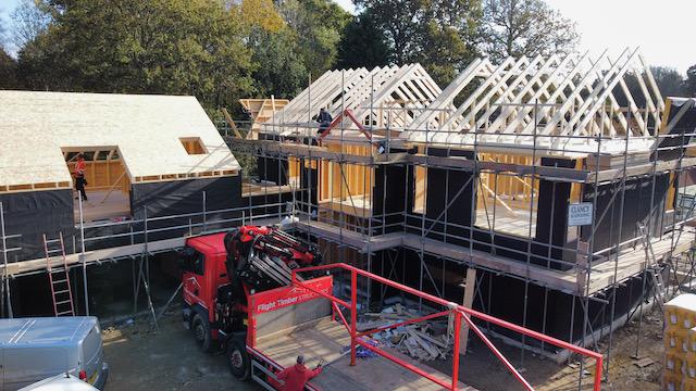

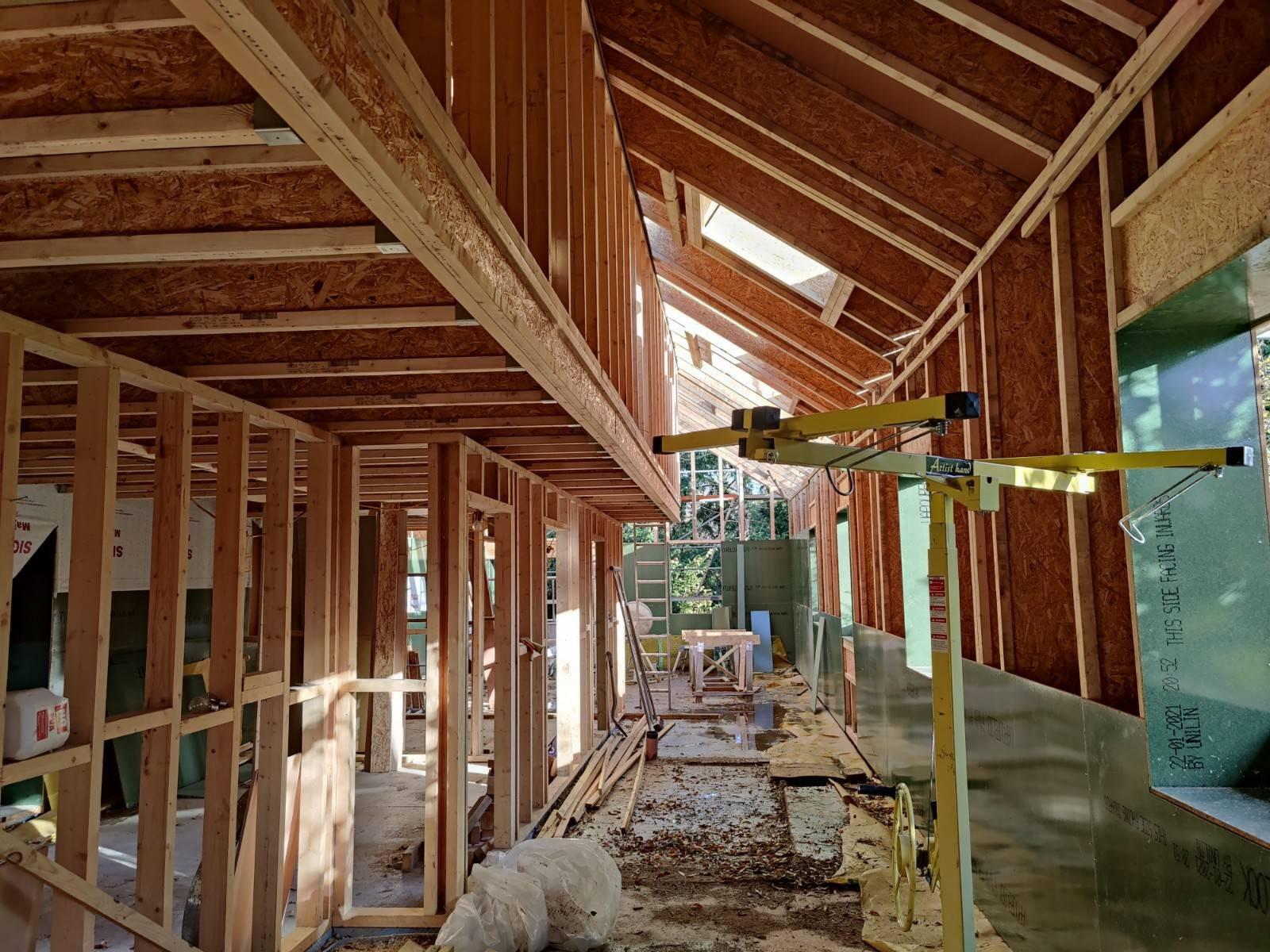

After a brief delay due to Covid-19 the carpenters were able to attend site and erect our timber frame. Thanks to the accuracy I insisted on and ensured for the coursing blocks the sole plates were a doddle and were done in no time at all although we did have a bit of rain and I had to get the puddle pump out!
We used Flight Timber for our timber frame and they have their o

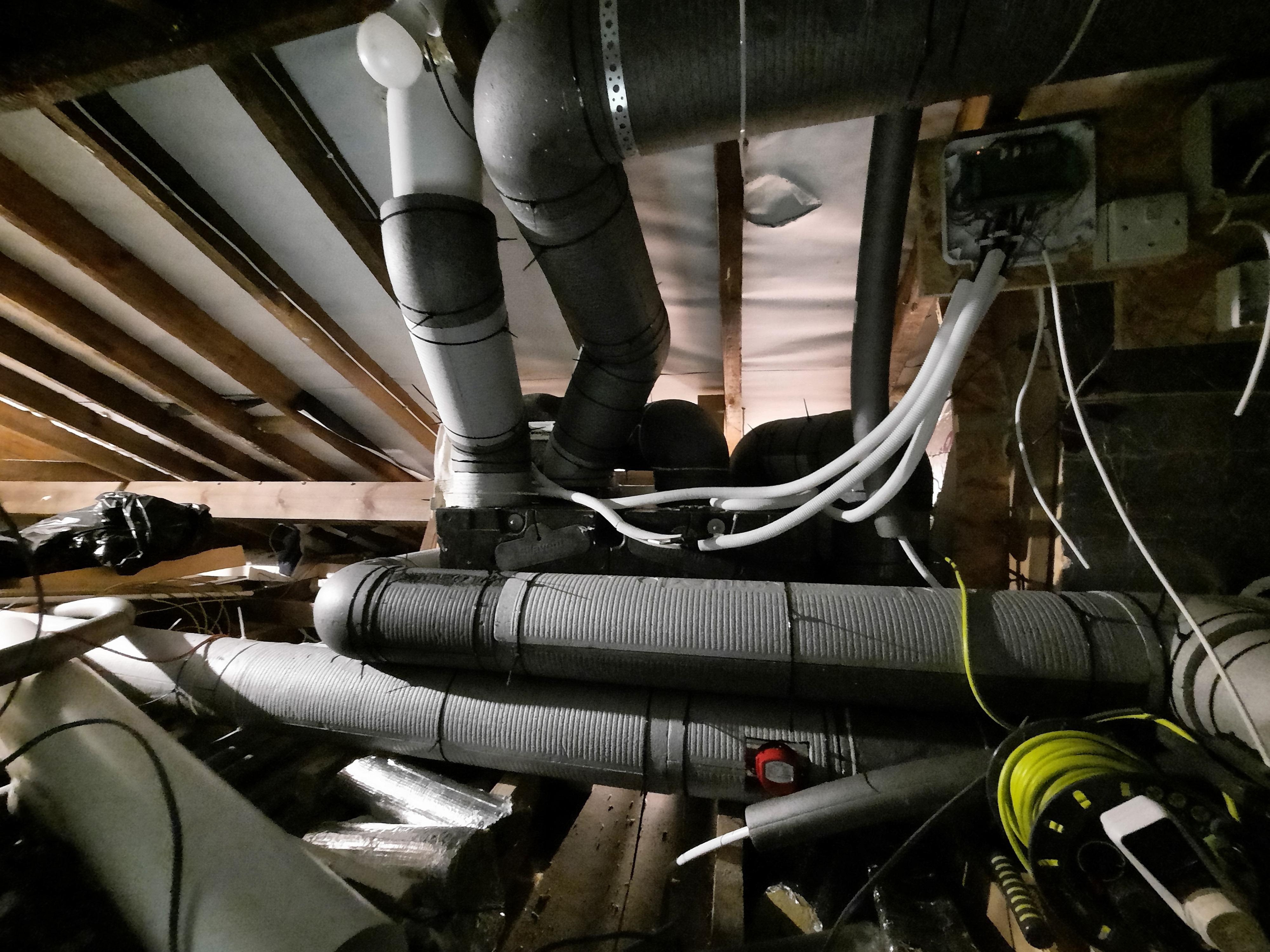

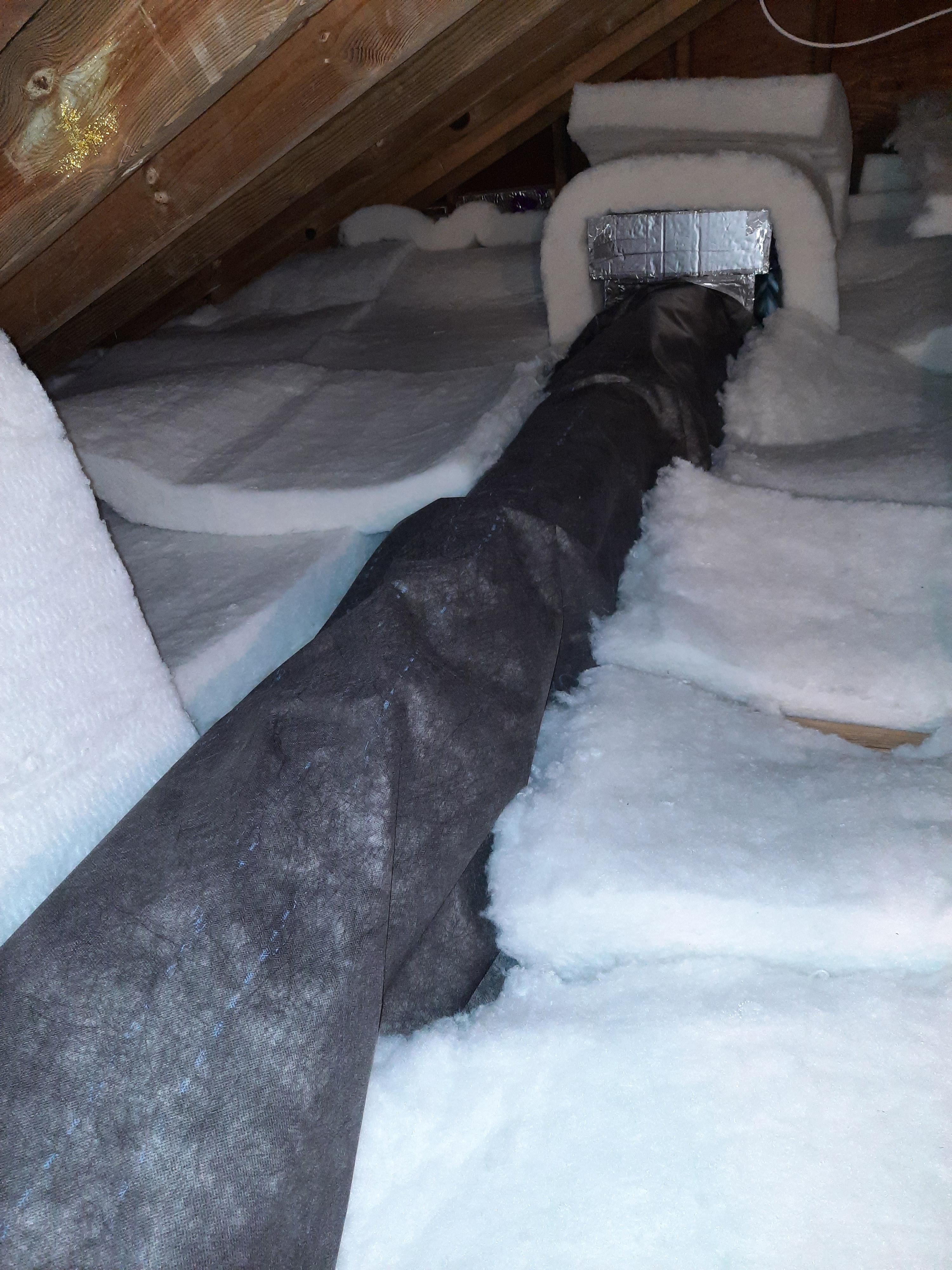

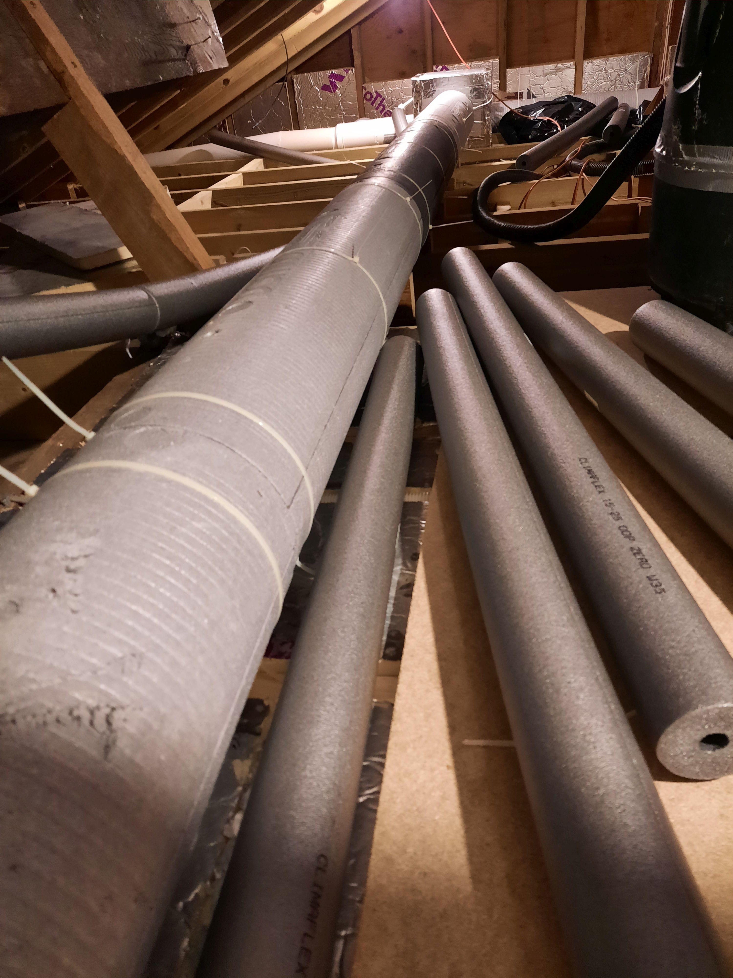

The existing loft insulation irritated the .... out of me. Mainly because I needed to change a lot of pipes in the loft and the roof is only 22.5 degrees and the fluffy was very thick. What with the 150mm insulated MVHR pipes (190mm thick) 2 high and a roof at 1300 ish it was too cramped. Anyone looking at the ducting photos will see the loft was bare.
Before insulating, the bungalow was loosing 87% of the heat through the roof because the rest is so well insulated. Gonna have to tur
More of the same...
When insulating the ducts I noticed that the top of the MVHR was not insulated so I have installed flexi conduit on the cables ready to throw fluffy over the top.
This is the inlet pipe running under the ridge. 150 diameter with insulation held on with cable ties

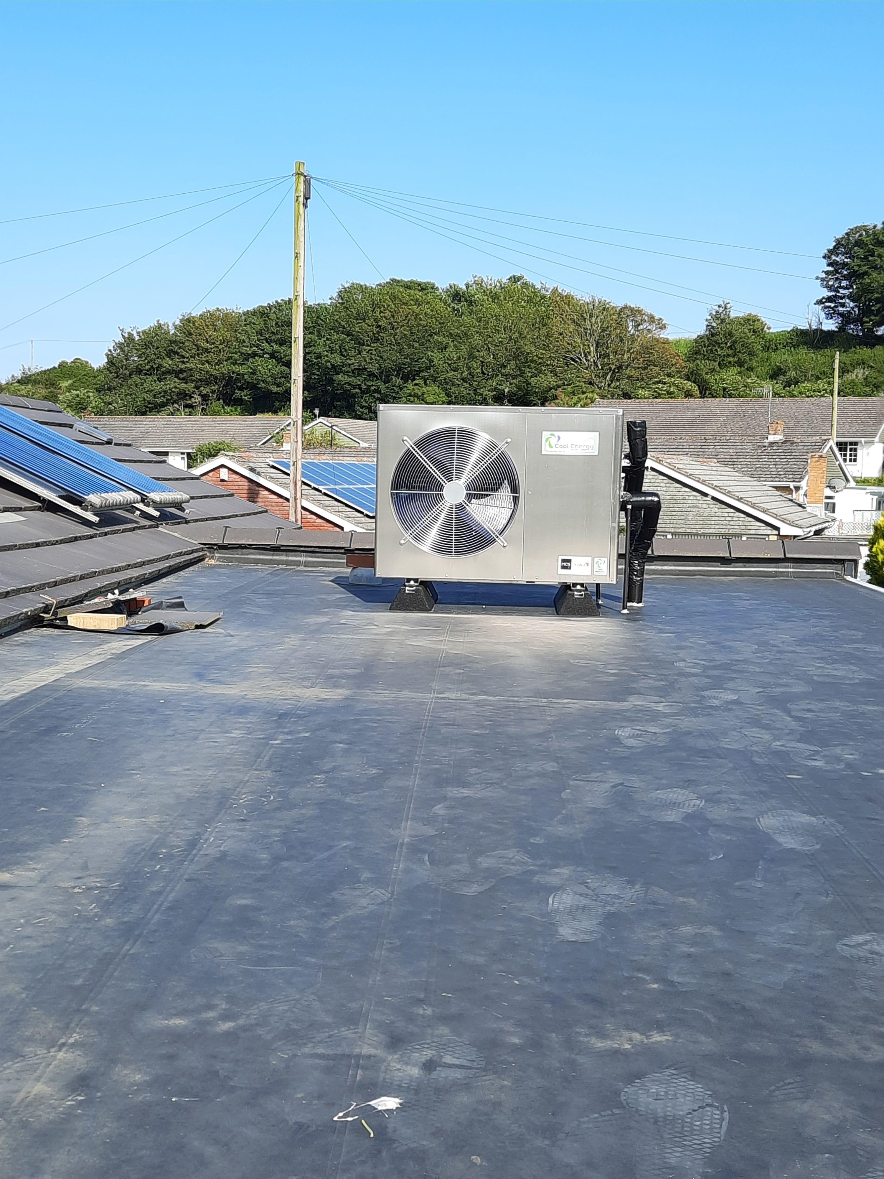

ASHP main parts:
: Air to water Cool Energy inverTech Air Source Heat Pump CE-iVT9 4.3kW-9.5kW

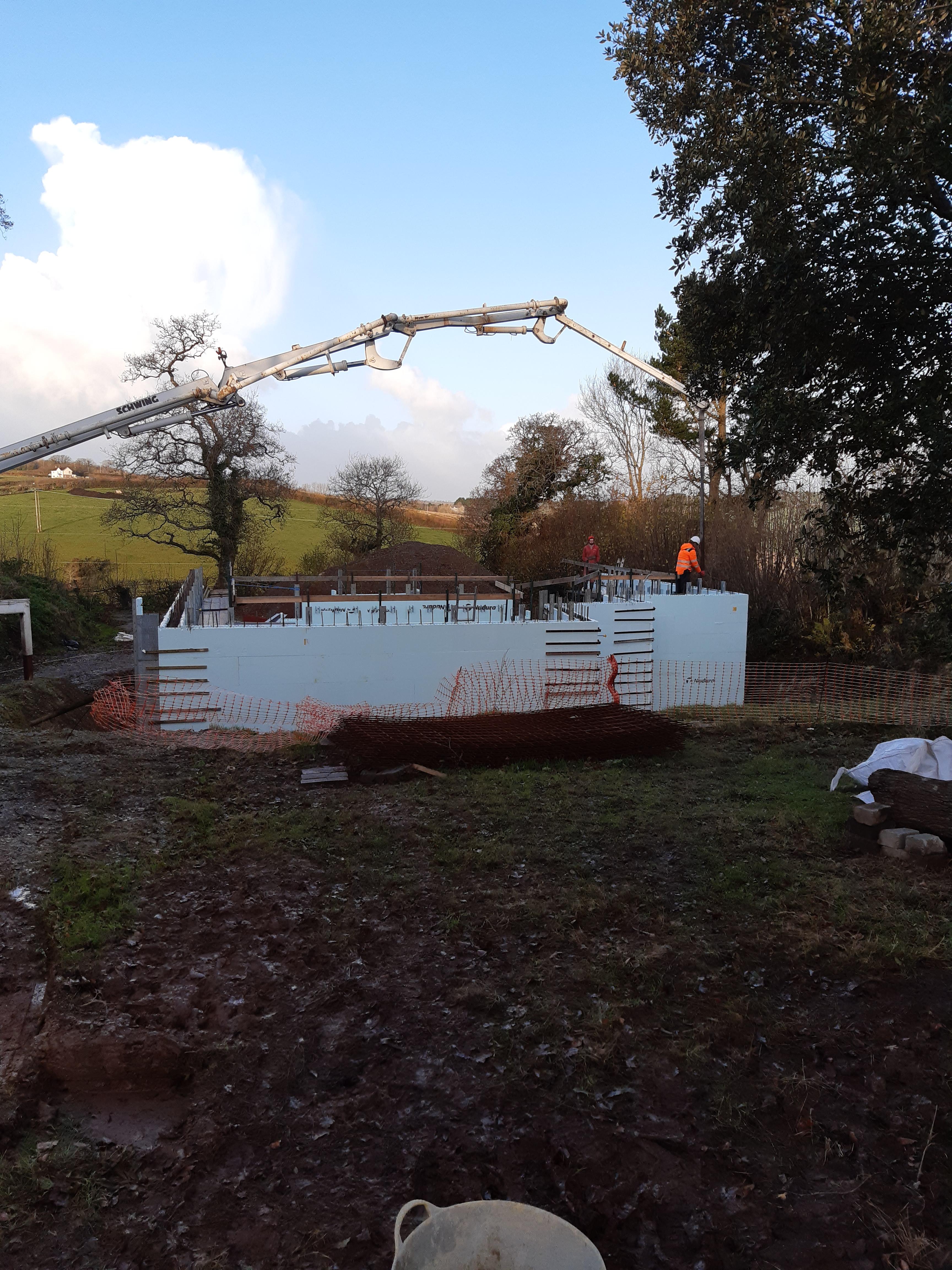

pointed Out numerous times... if you dont go over the poured slab often and quick, again and again , you be ending up with a garage floor. So we had the concrete ordered for morning and ready with 4guys to spread and level, tamper and float.
Pouring went smooth. Pumping was good.
But when we started tampering and levelling the concrete, Murphys law kicked in:
-concrete went off a lot faster than my groundworkers seen in quite a while
