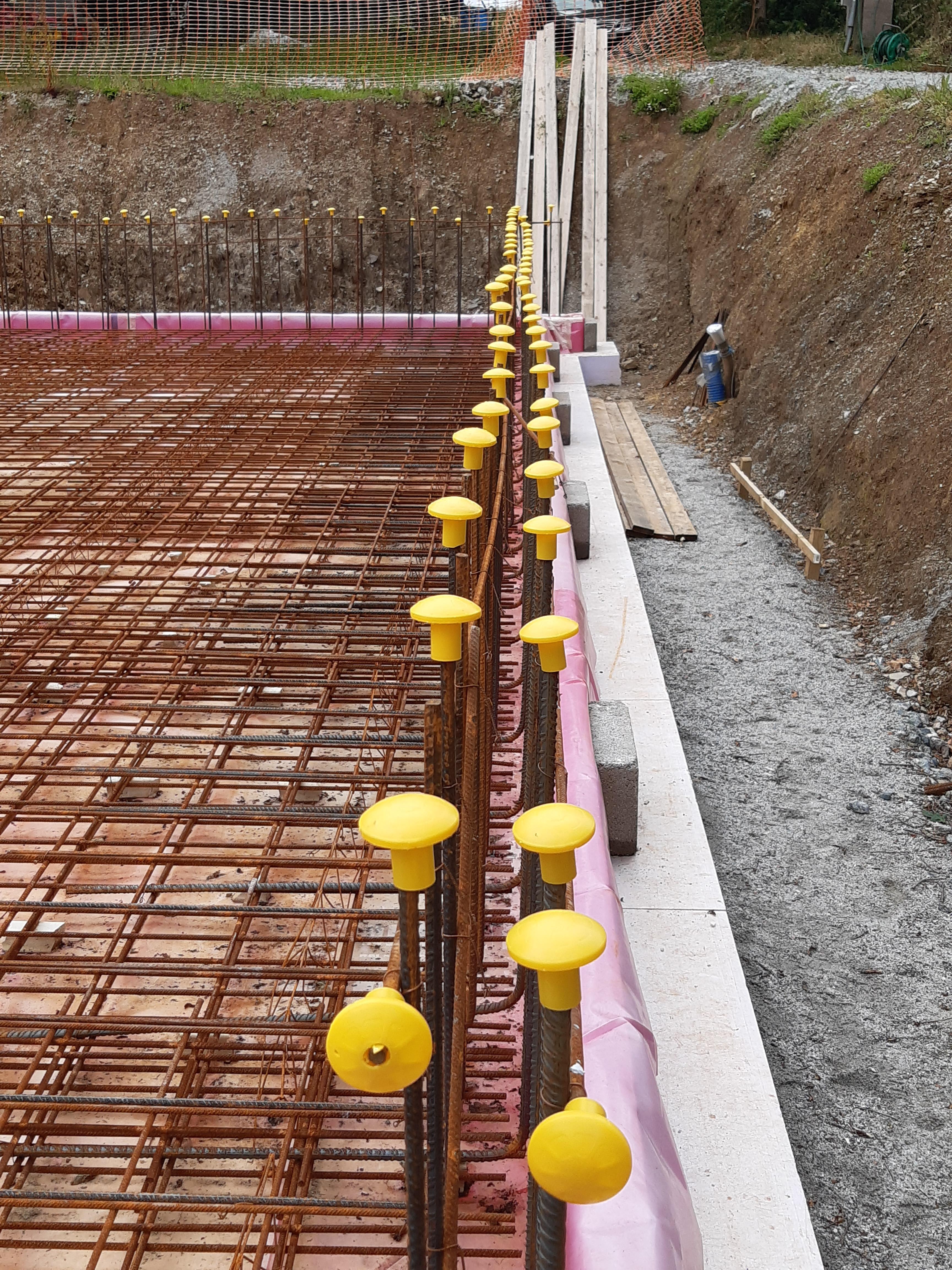

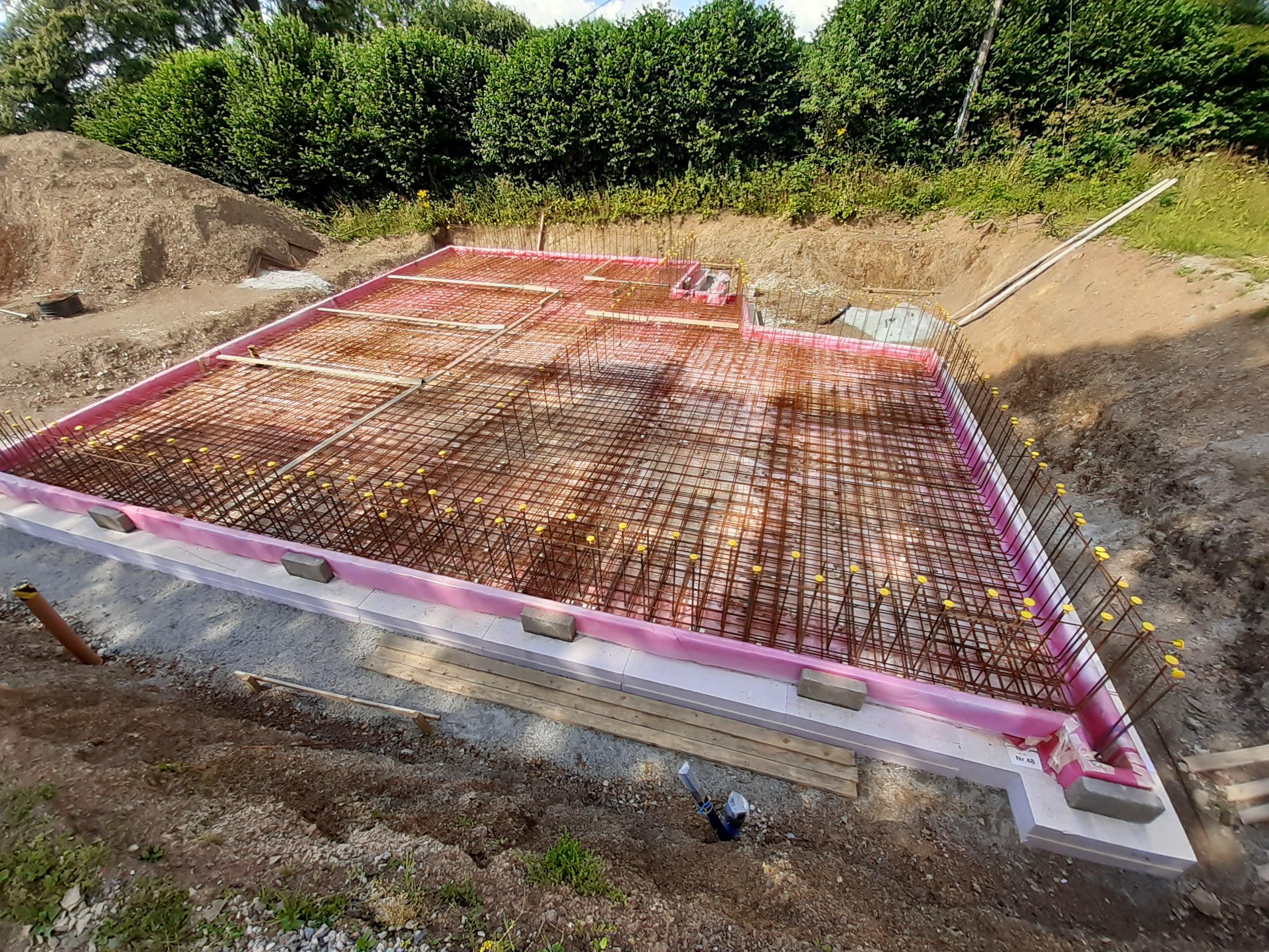

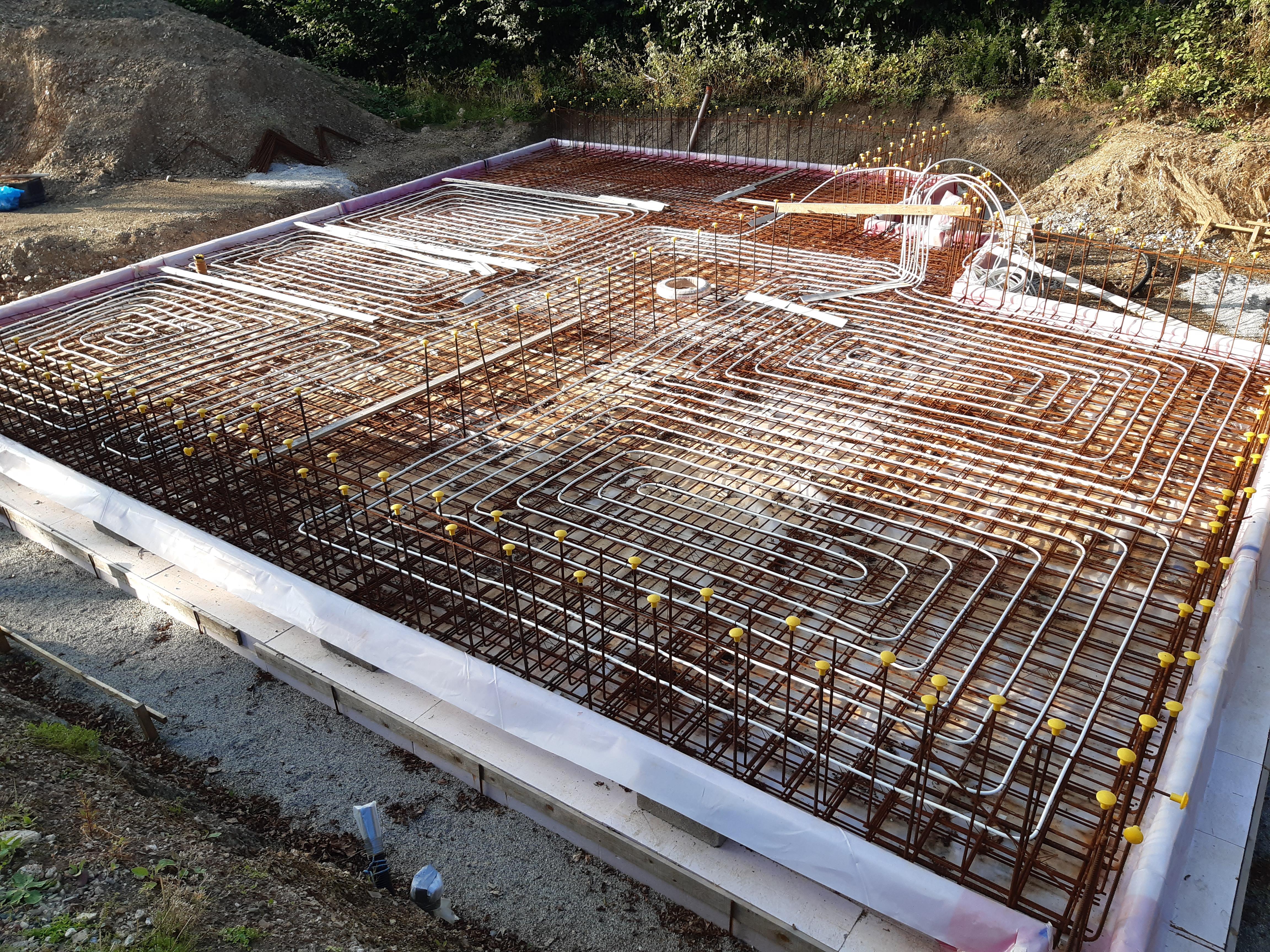

So, first on the list was the starter bars for the retaining walls with this amazing double row being installed by my erstwhile wife
20210724_125555.thumb.jpg.57f86286320133f9a07f239e52160e44.jpg  20210724_163252.thumb.jpg.9887d1df9ae7fb7f8587b354acd88cbf.jpg
and with all those complete, it was onto the underfloor heating loops

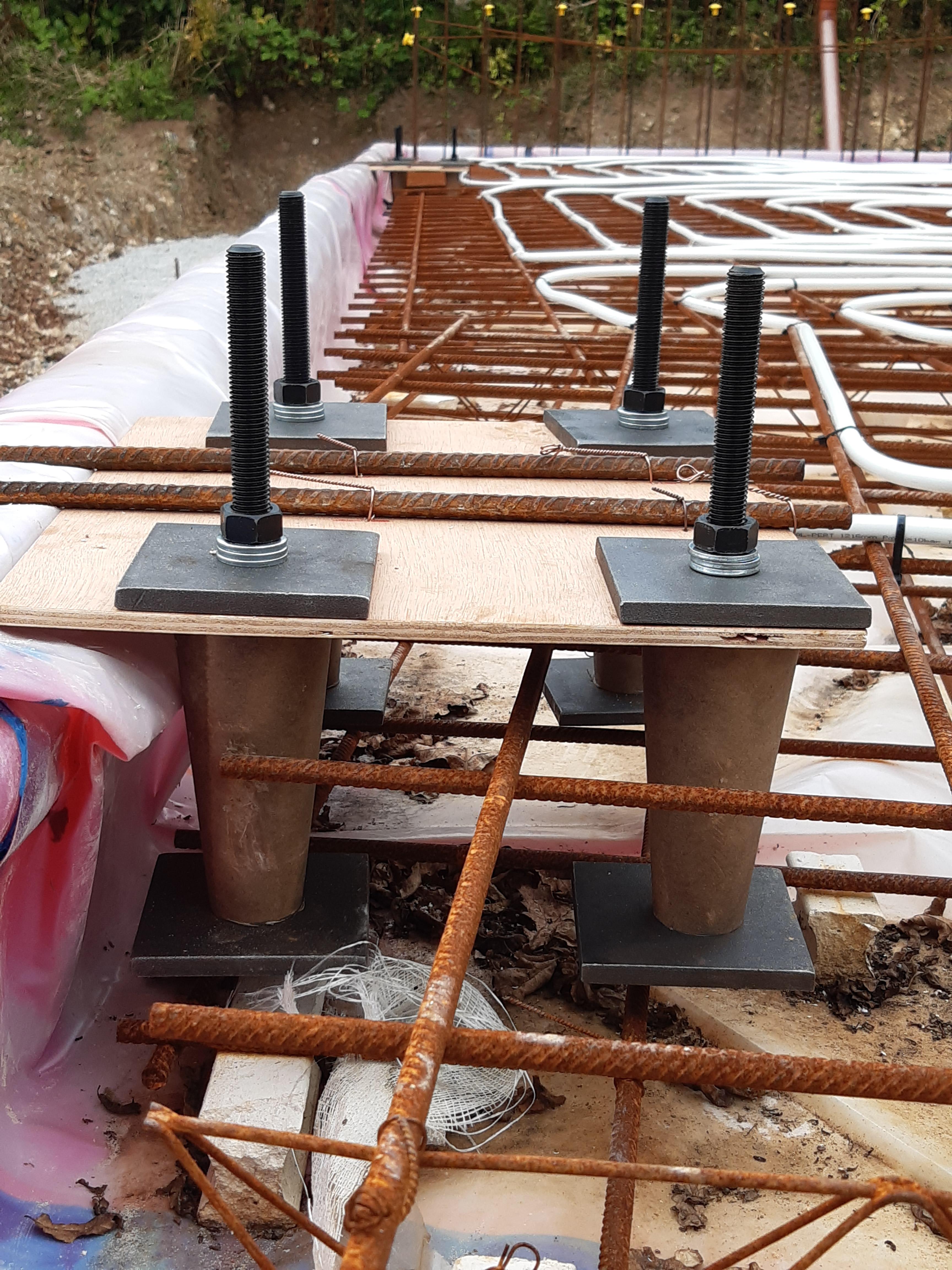

and then the bolts that will locate a couple of steel columns
Now, the eagle eyed amongst you will recognise those as M16 bolts (well done to all the bolt nerds), and when a steel fabricator came along, having seen the plans, he fortunately pointed out that they should be M20 bolts. So, if anyone is in need of some 300mm M16 bolts and fittings, tap me up for a deal ?

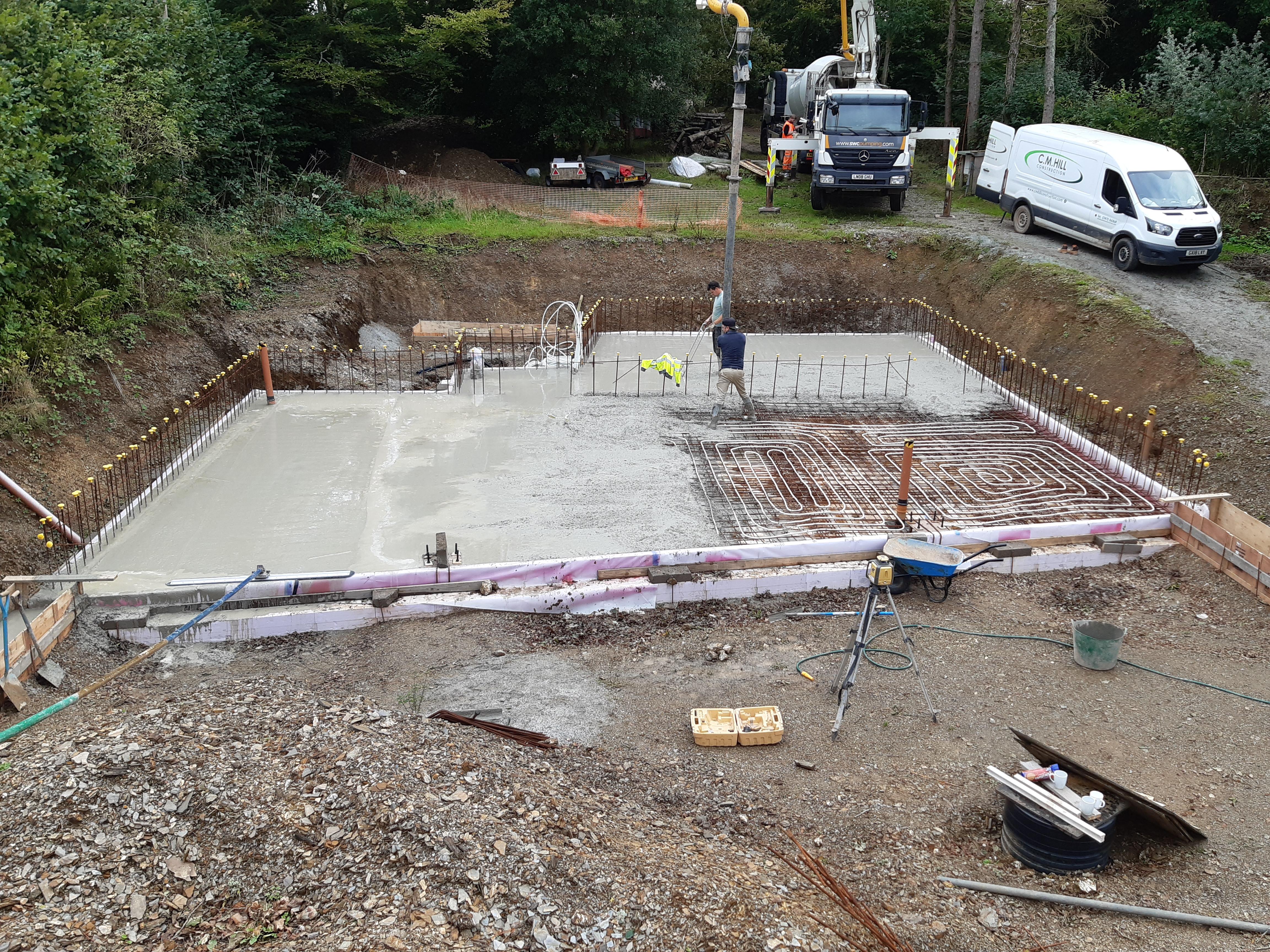

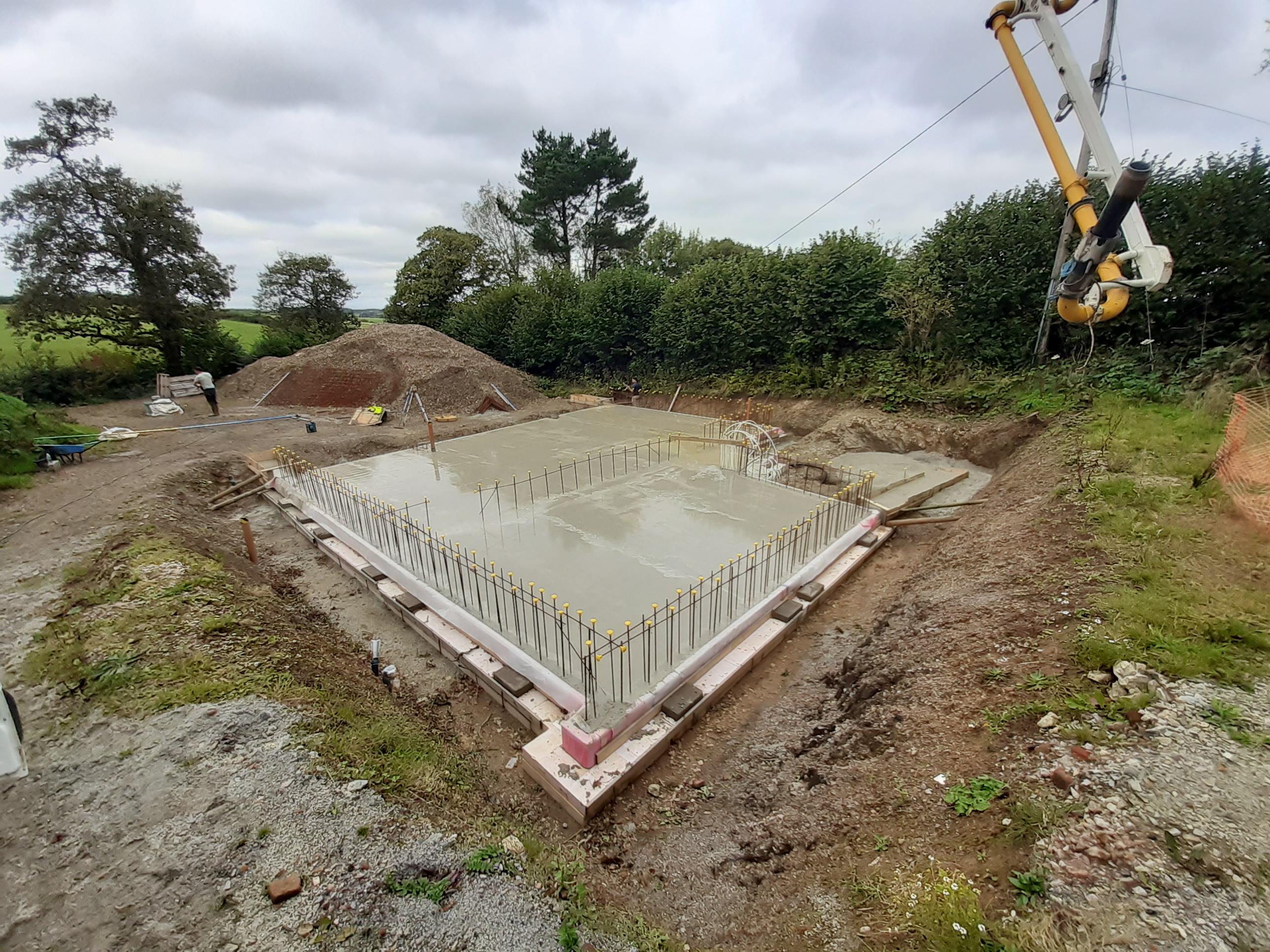

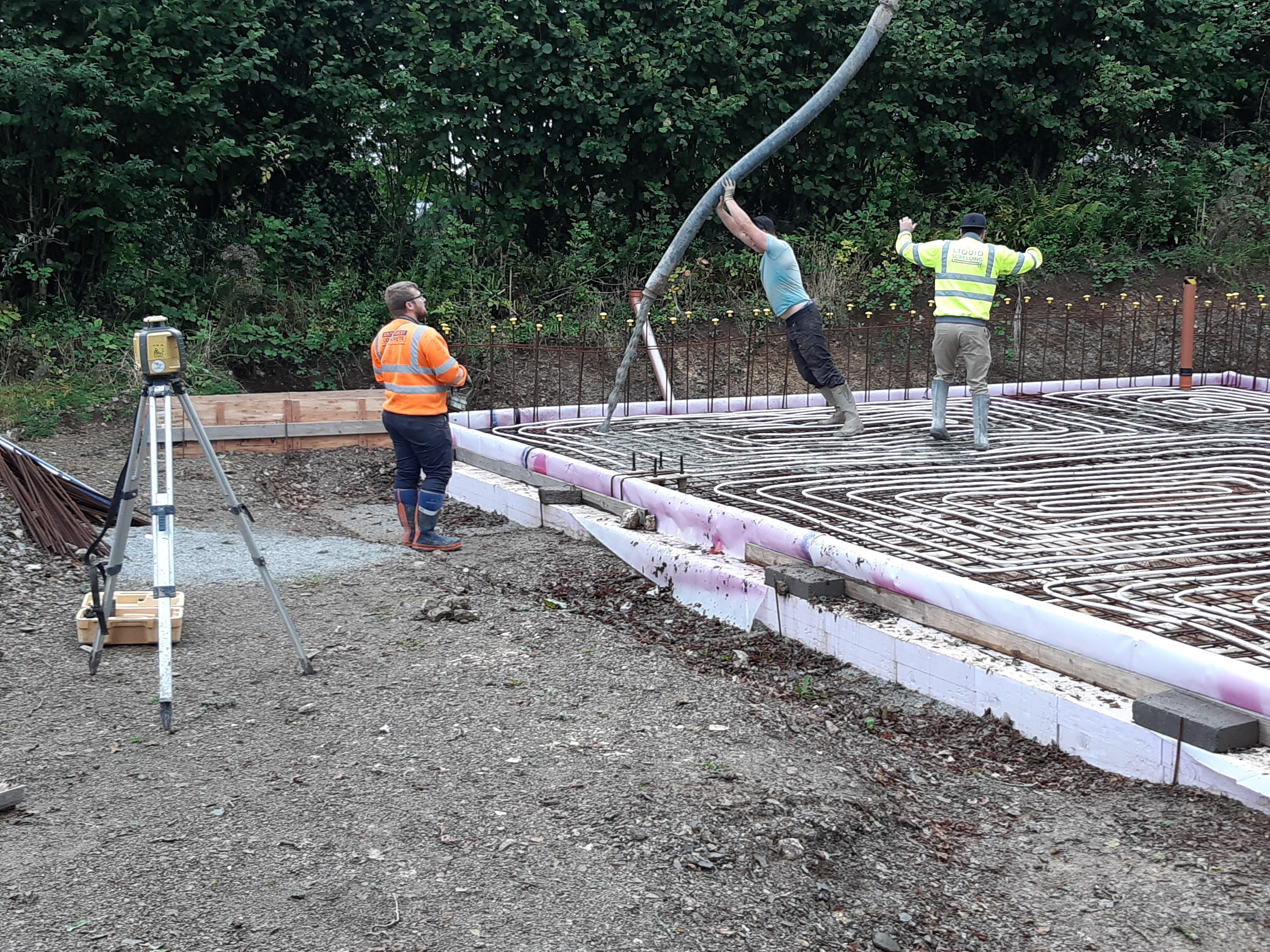

And, so we thought we were ready for a bunch of concrete, until we visited our friendly ICF supplier to talk about the walls and realised I had omitted the shoring for three extra pieces of wall that needed to be tied to the main slab. So after a stupidly self-imposed extra delay, we managed to get everything in place to have some jolly super chaps (Tom, Phil and Ross) to bring along a concrete pump and other wonderful paraphernalia to pour, tamp and float our insulated slab foundation.
  20211008_091551.thumb.jpg.f4669025da56780226f743c0efe3c70b.jpg  20211008_111011.thumb.jpg.547f1835b12f9f1923cb744c4d3f8e4f.jpg. 20211008_124754.thumb.jpg.01bef386c55e8ce5d2bbac6c41b66f8a.jpg
We can almost smell the completion of the house ?  ?   ?   ?
