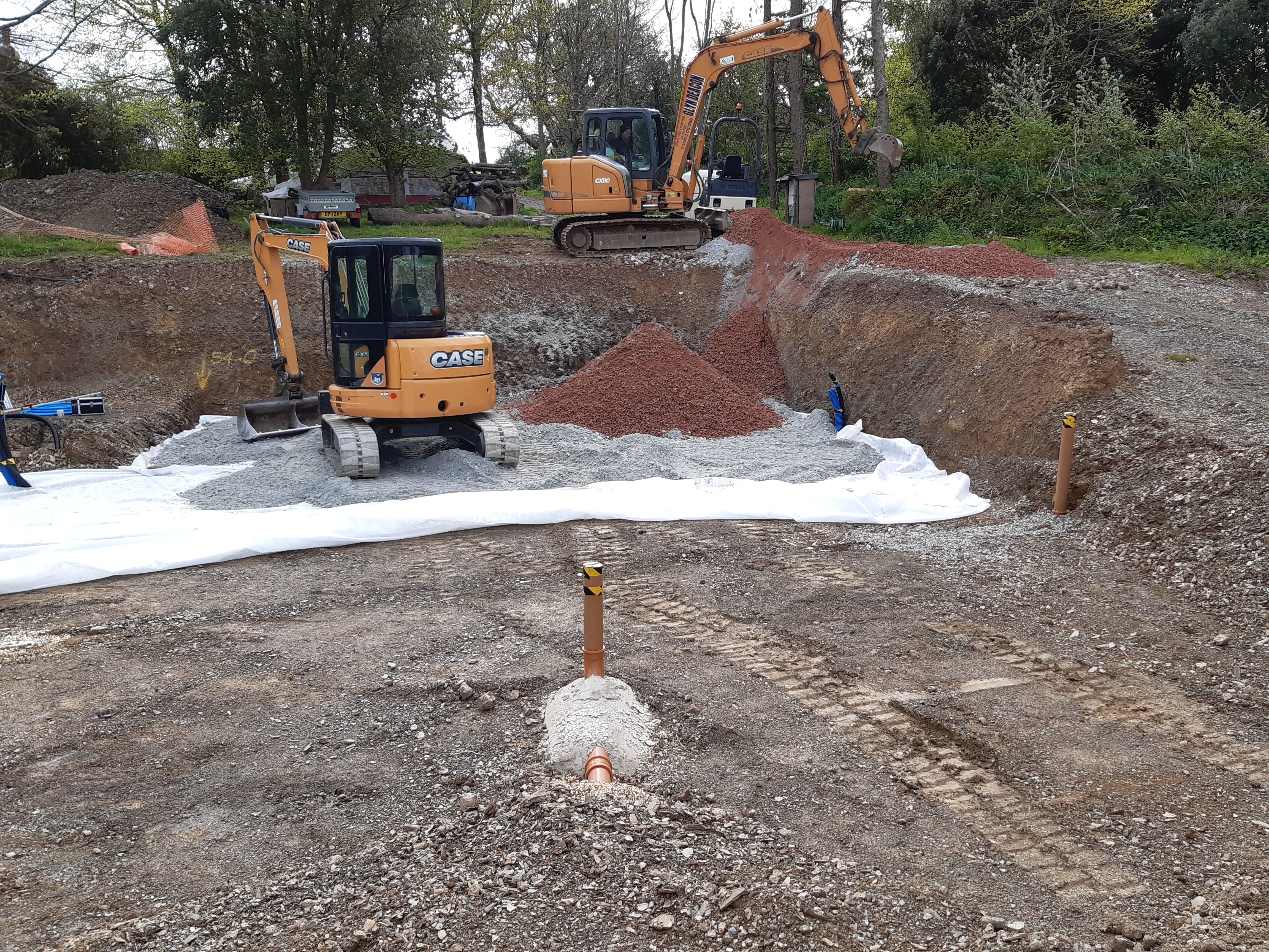

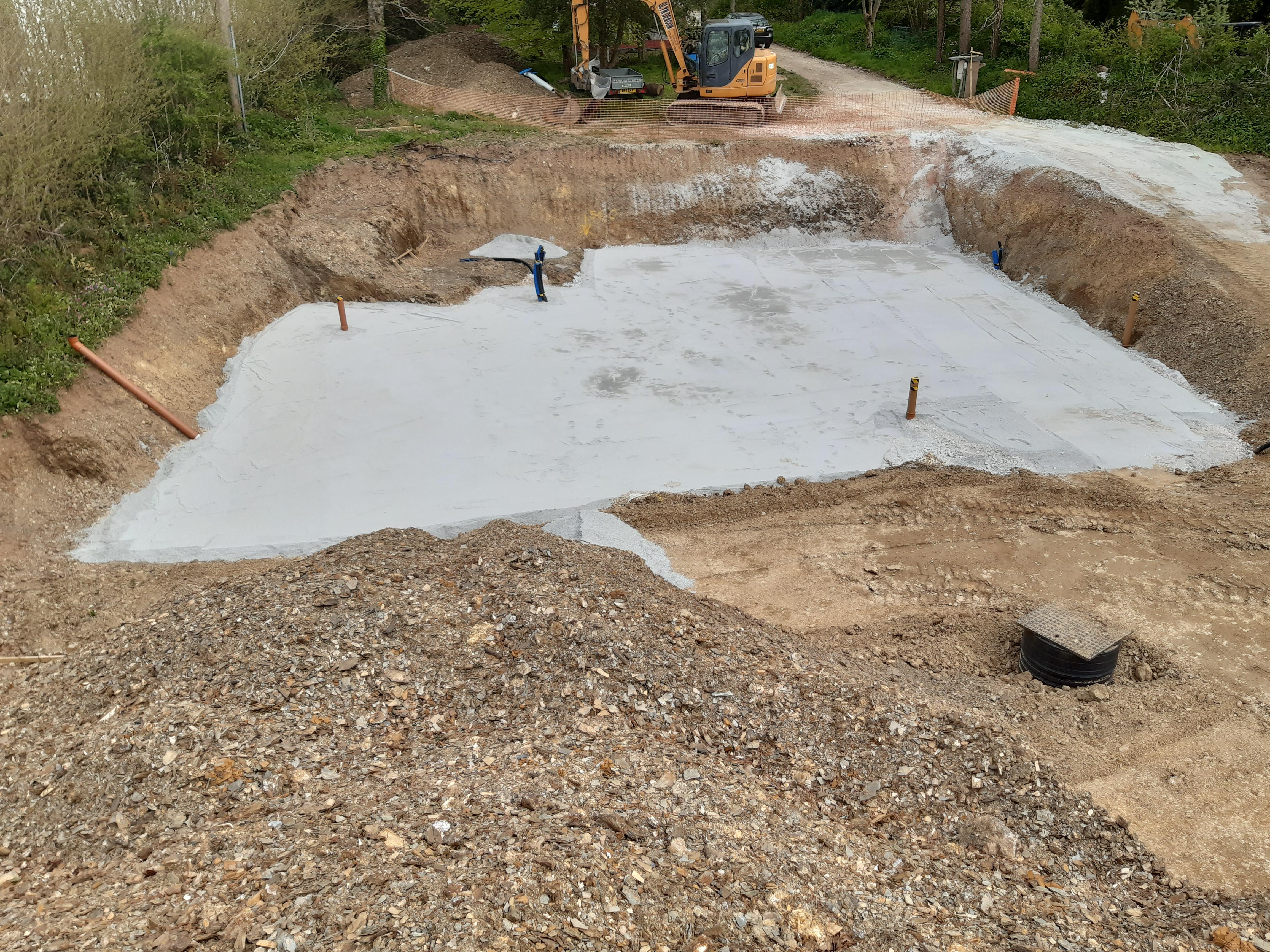

So, after more enforced delays, it was back onsite in May with the groundworker to get the stone and blinding sand in place ready for the insulated foundation system to be installed.
20210504_100438.thumb.jpg.45c491aff3e43683e422002d50ca349c.jpg 20210507_154255.thumb.jpg.bd94bcd8adb5dacaa47fd4dd421ae097.jpg
This involved about 80 tonnes of stone and 15 tonnes of sand being delivered - we have about 5 tonnes of each left over, fo which I have no doubt we'll find a use ?
(and before anyone asks, yes, it was rolled with an appropriately large machine at the appropriate time).

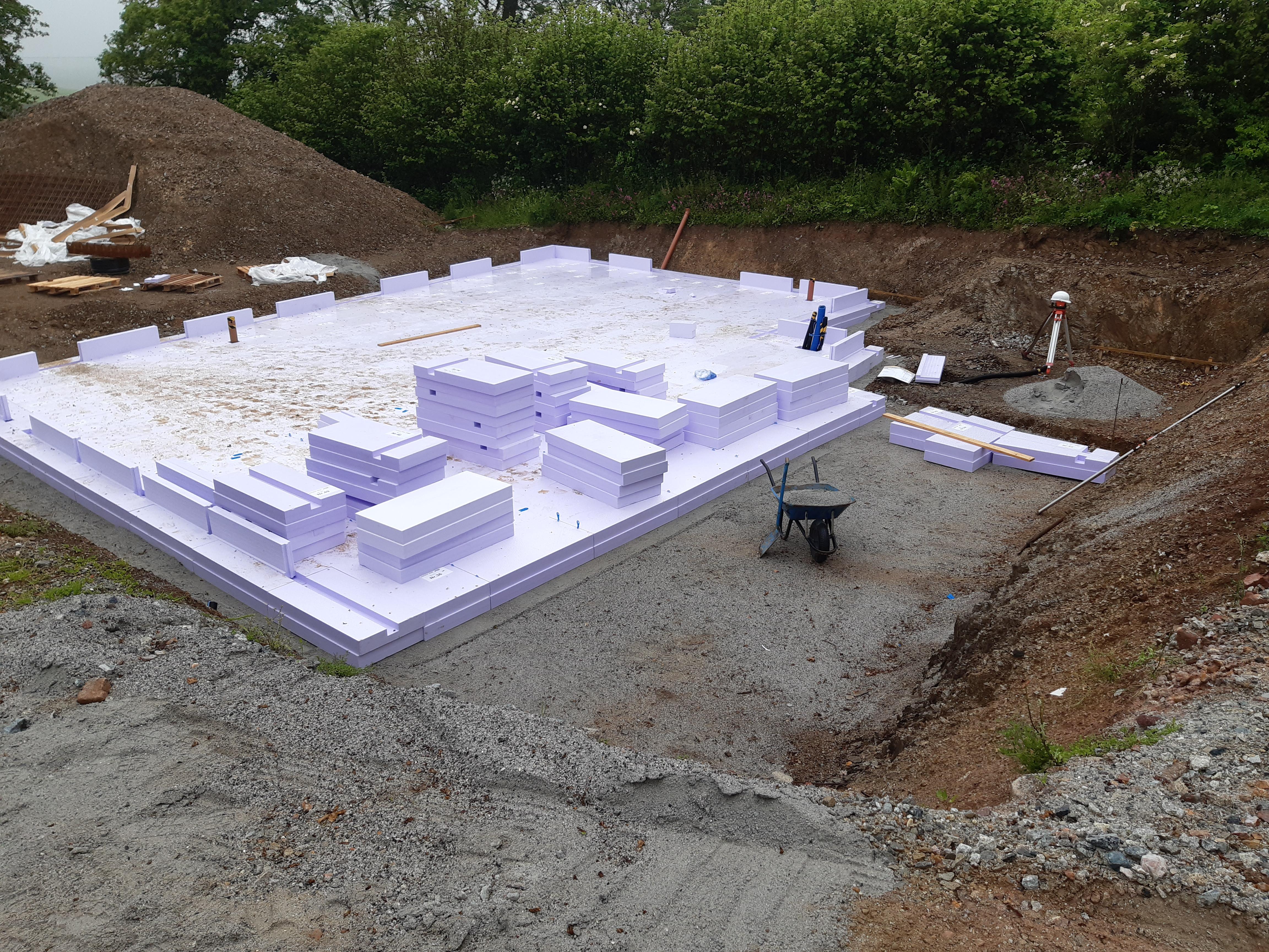

Ahhhhh - the insulated raft choice - it started out so simply having read the various comments in the forum, and Kore Systems it was going to be. I did then visit the Swindon self build centre and saw Jackon's stand and what seemed like a good system. Our SE had specified a 250mm thick slab throughout - no thin bits and thick bits - the Jackon Jackodur Atlas system seemed to fit the bill - a few calls, swap some drawings, commitment to delivery timescales, but with the flexibility I needed, a person onsite on day 1 to help. Quite straightforward. I won't go into detail, but let's just says Kore Systems approach was "our way or no way".

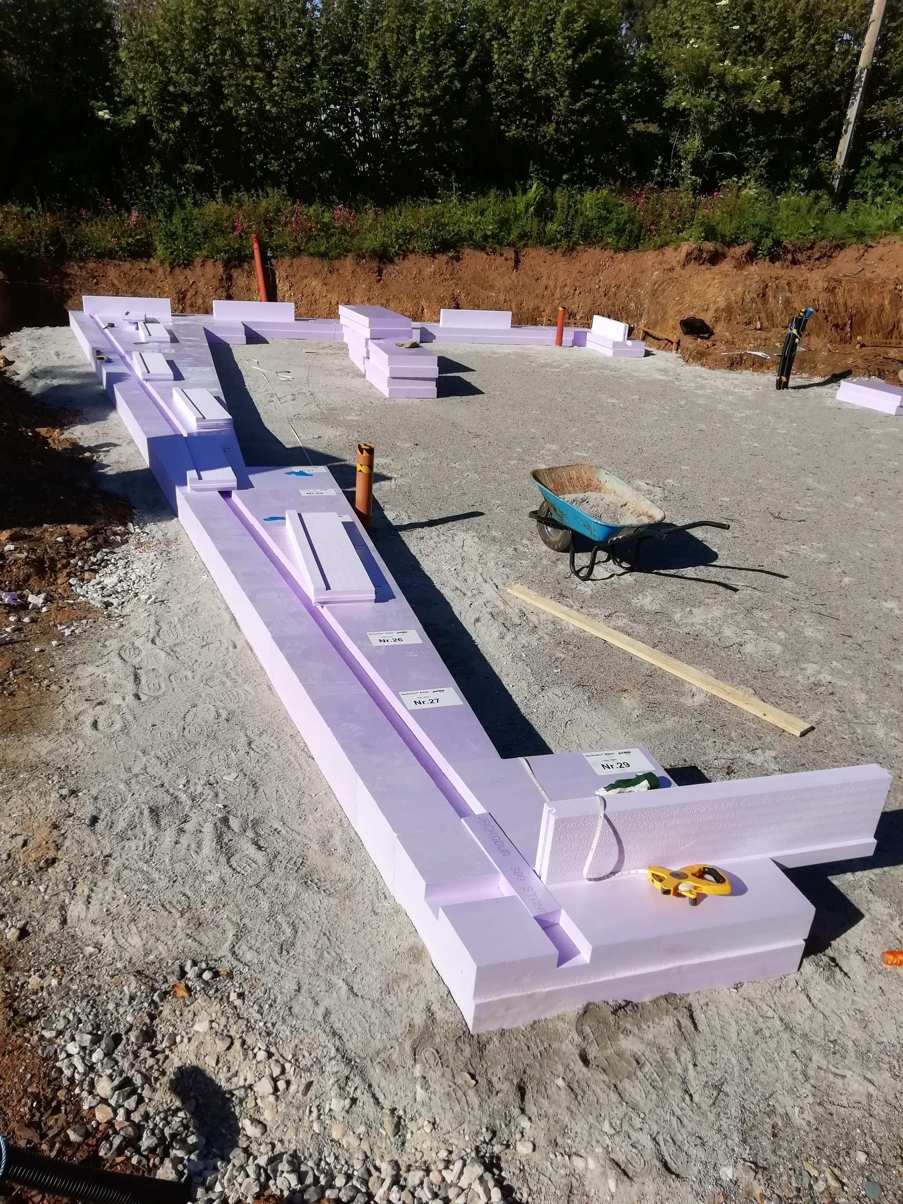

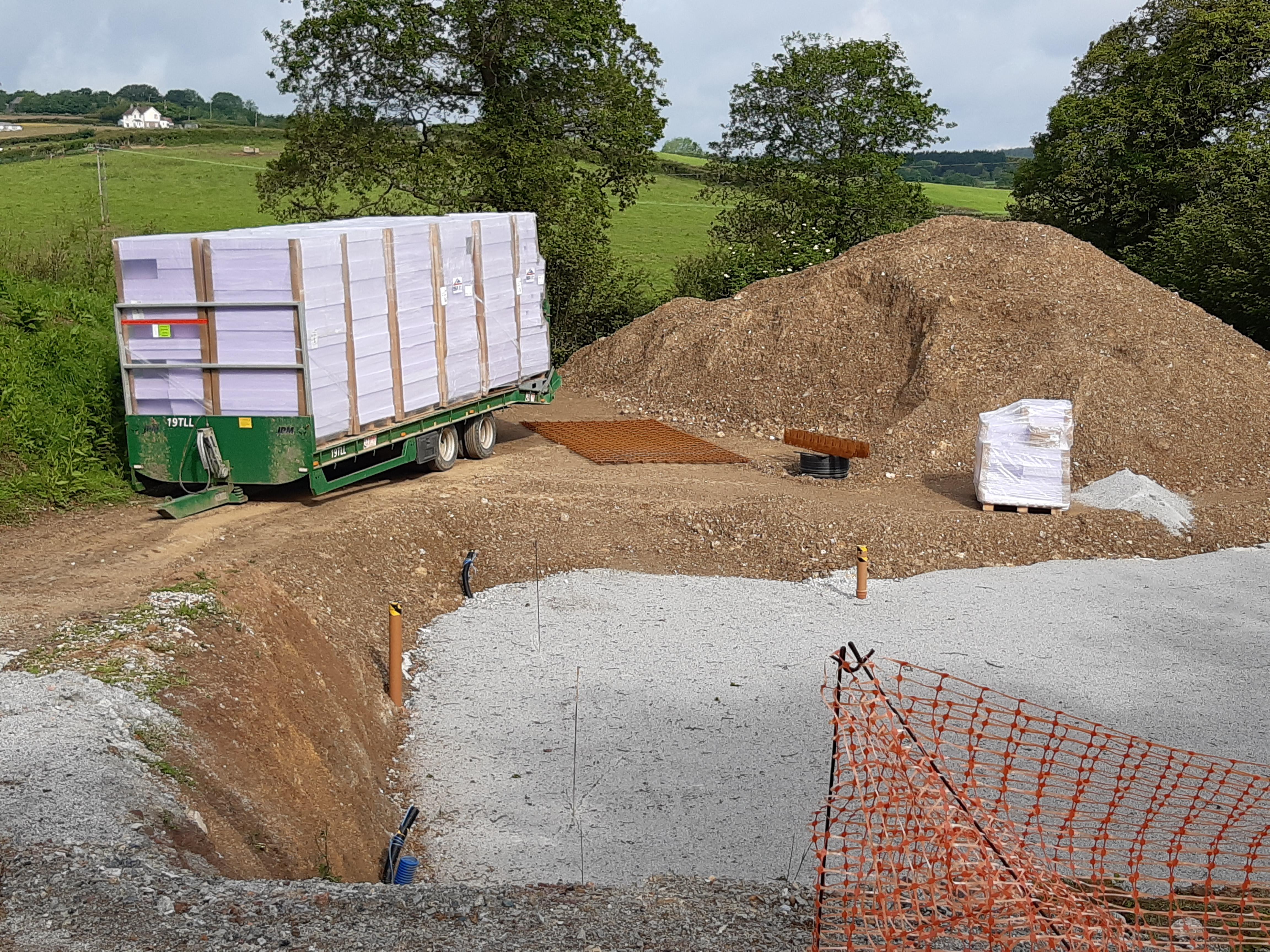

With a delivery to a local yard by articulated lorry and then our groundworker getting it on his trailer to go the last mile or so, we then proceeded to handball it all off the trailer. From delivery to the yard at 8:30am onto the ground by 1:30pm. The handballing was done by Mrs BB and I in about 4 hours.

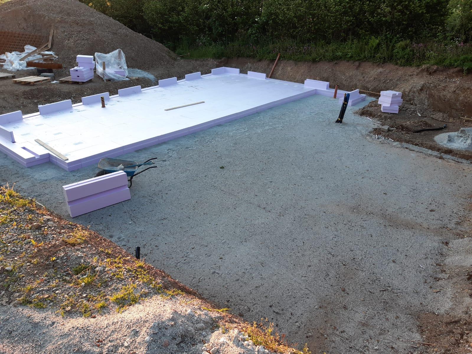

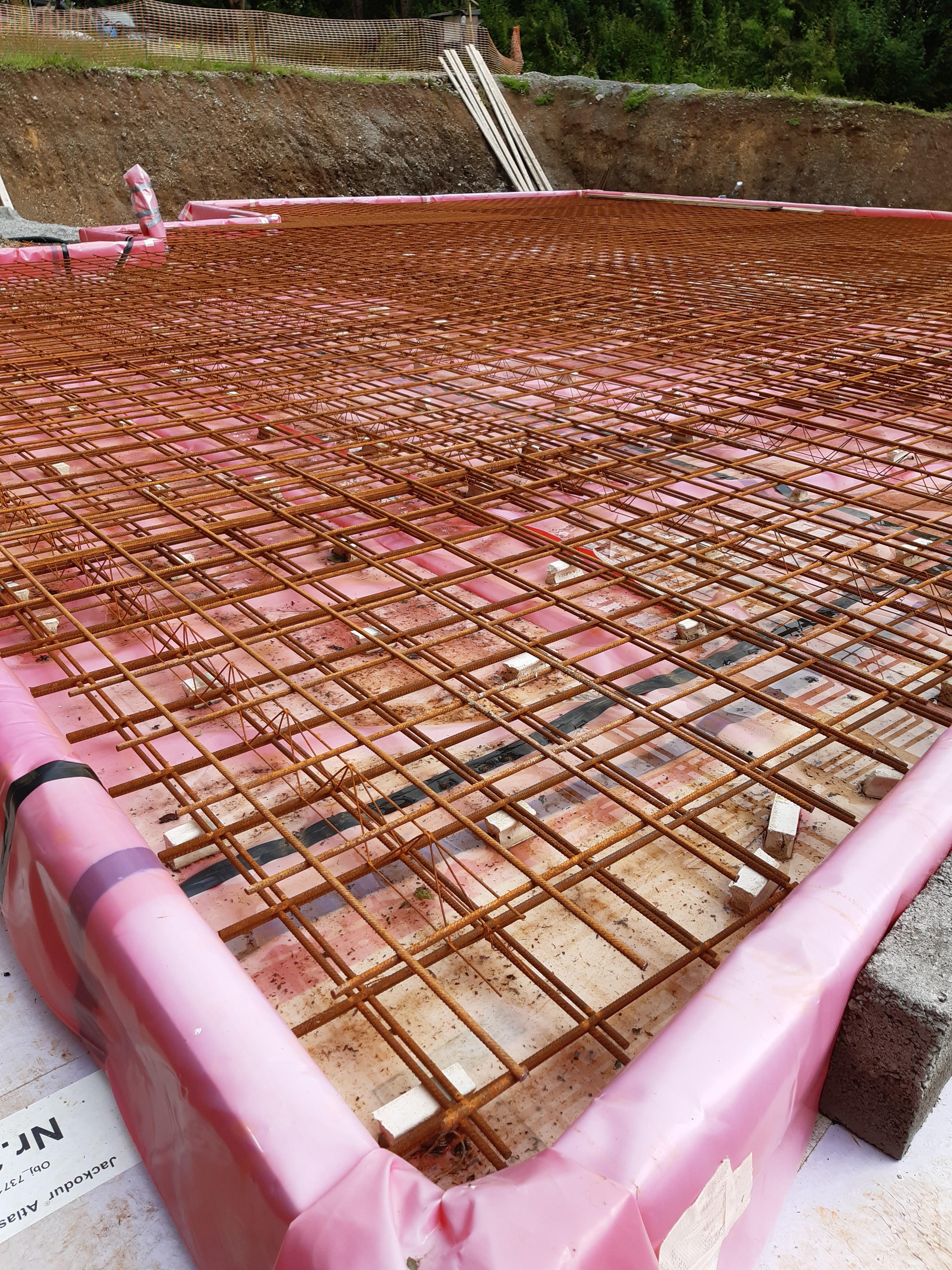

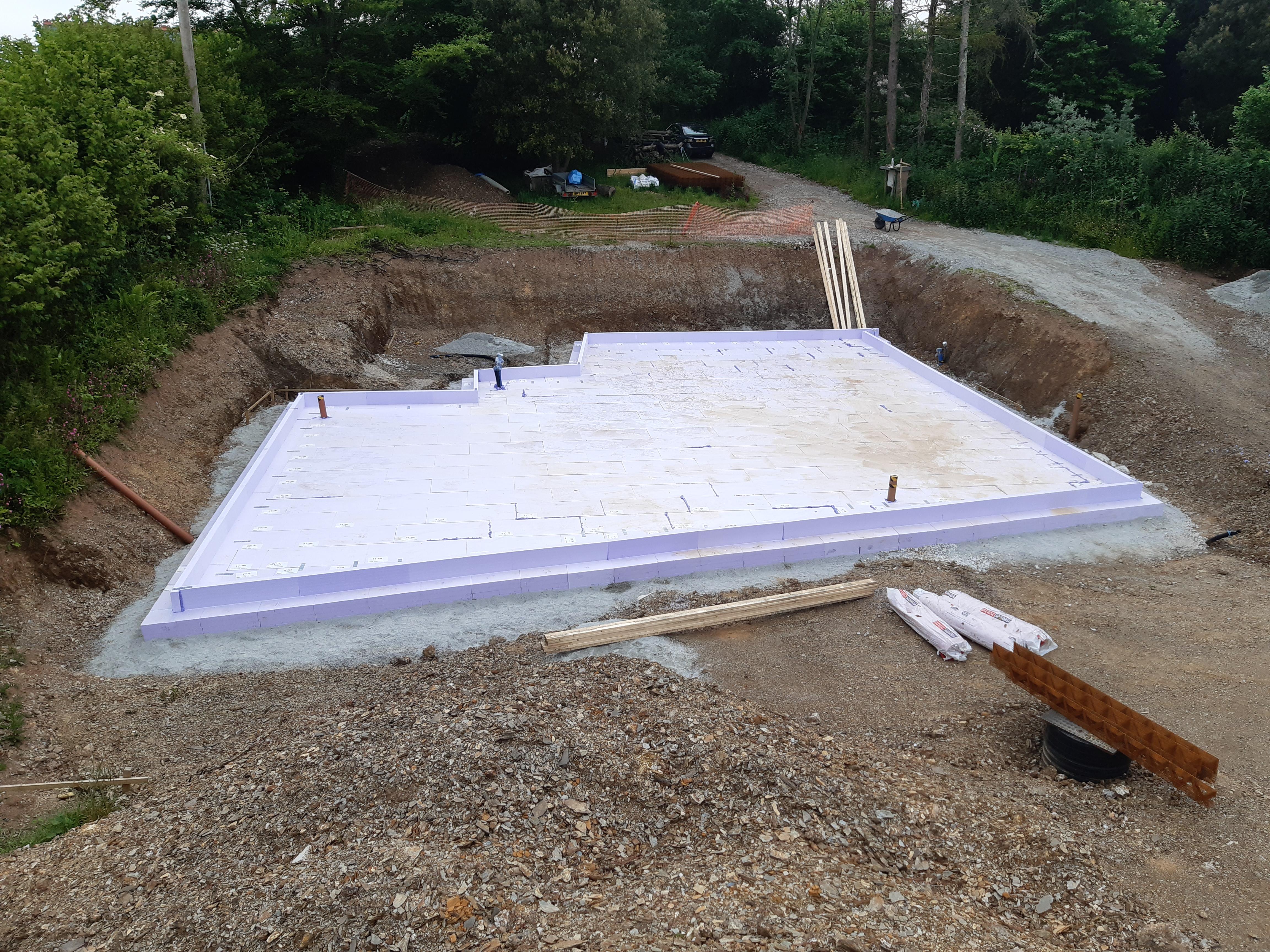

The insulation comes with a nice waterproof holder for the instructions and the plan to follow - think "a jigsaw puzzle with the special parts all numbered and shown on a drawing". All the other parts are standard, but if you work from pallet 1 through pallet 2 to pallet N, you can't go far wrong. The very nice man from Jackon arrived just after we had stopped for lunch and we began with laying the first two sides and three corners, and then Mrs BB and I carried on the following few days to lay the rest. We did come across one part while the man was onsite which had not been cut properly in the German factory - you should have seen the delight on his face when he realised he was going to be able to send a snottogram ?.   It was easily sorted, but if he had not been onsite I can see that it could have caused a big time day - even with being onsite it took about 45 minutes for him to work out what had gone wrong.
Day 1:    IMG_20210607_174759.thumb.jpg.df62a13be74341f36a29fc8c88af490f.jpg              Day 2:    IMG-20210608-WA0000.thumb.jpg.fd528ea7d5ad7680509f1dbc29024b11.jpg
Day 3:    20210610_081940.thumb.jpg.2caf659650fd3278ac7e8cd45f3f3924.jpg      Day 4.   :20210610_164511.thumb.jpg.286e02eaffd15e867d0a60732489239b.jpg

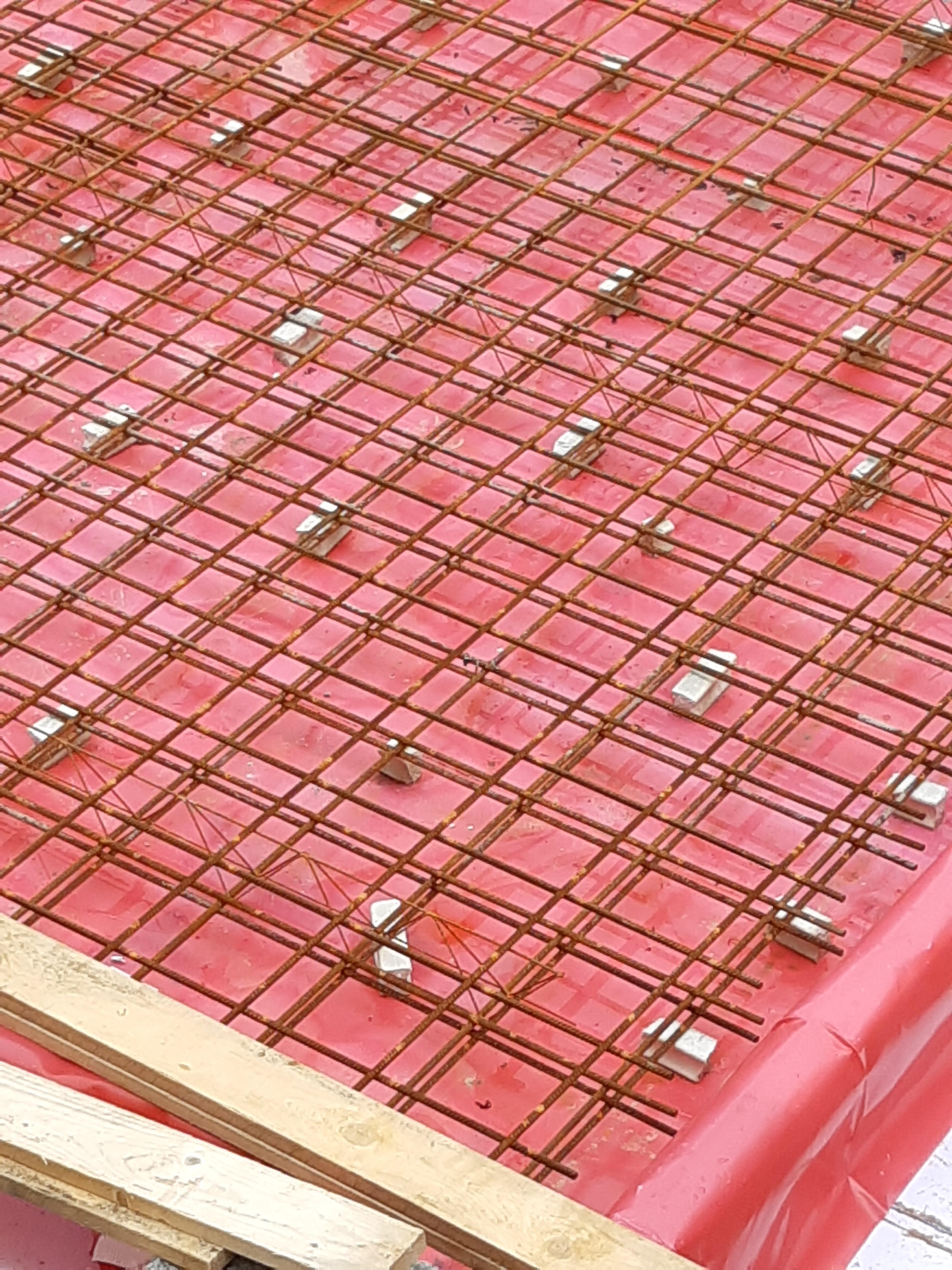

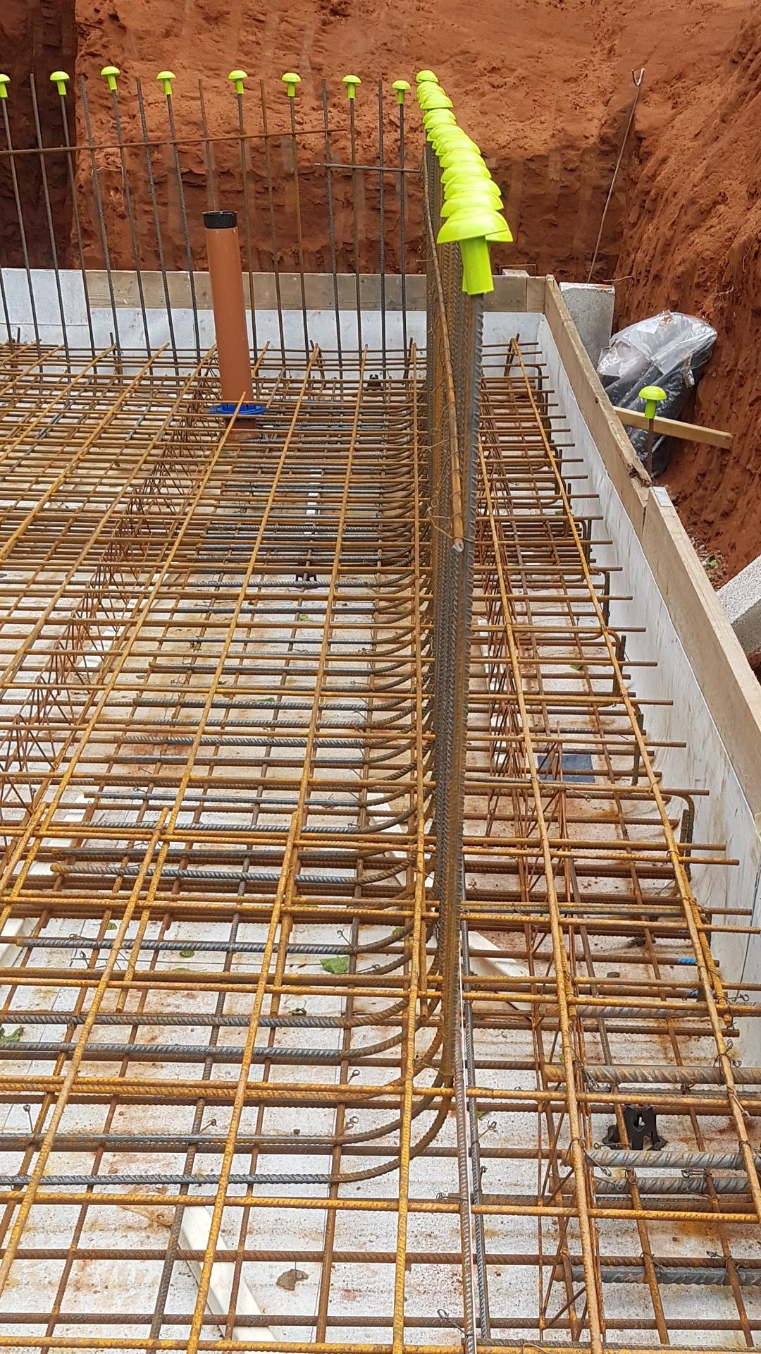

Next in was the combined Radon barrier/DPM, the first layer of reinforcing mesh, including a double-layer strip (see left hand photo below) around the 3 sides that will be retaining walls. During the laying of the re-inforcing mesh we suffered our first big accident when one of them caught Mrs BB on the shin and we ended up at the local A&E for her to have a few stitches applied - she is still talking to me ?
Over the last few weeks we have managed to get the time to put in the second layer of mesh, with the help of a good friend and one of our neighbours-to-be.
20210620_114457.thumb.jpg.f3749defdb2ca9fe778f4d74b115dfd6.jpg                       20210710_154657.thumb.jpg.3ec997509c6f1627b10503c67c5bf0a6.jpg
We're pretty close to pouring concrete, but just have the starter bars for the external walls and one internal wall to put in place, and two sets of bolts that will eventually have two steel columns attached to them.

Looking good, and It reminds me of me doing my slab mesh a few weeks ago.
I,m currently filling the cavity of the retaining walls and getting the waterproofing done.
I did about 200 starter bars and that was enough for me, you look as though you have triple that.
I put a 6m length of rebar on the top mesh where the starter bar needed to be, so it could be tied to that and the bottom mesh. Before the pour I fixed the hope of the starter bars to another 6m length of rebar, to make sure they were vertical and the right spacing. I took this off before I attached the retaining wall mesh
What are you tying with, I had the pull / twist tool and it was such a good thing to use.
A what now? a double layer of A393?
My SE spec'd the bottom layer as B1131 with lacer bars in it, to get the mass up.
Started with the twist tool, but it broke, so I put a tent peg in my cordless drill and it is so much better (set to slow speed with the variable trigger speed as well)
I know - this thing will hold up a block of flats ?
My SE has also spec'd two rows of starter bars (wait until the next blog entry), one from the bottom layer, one from the top.
Appreciate how you kept yours upright ?  Will be plagiarizing ?   (or is that learning?)
Mine got really stiff but I put a load of grease on it the twist thread and works fine.
I have never come across a double layer of starter bars, are they at 200 ctrs?
Learning definitely learning, what route have you gone down for the retaining wall, filled cavity masonry wall or cast in situ?
I did my second cavity fill today, and happy with how it has gone, up to 8 blocks high
BotusBuild
1 set is at 200mm ctrs, the other at 400 ctrs.
