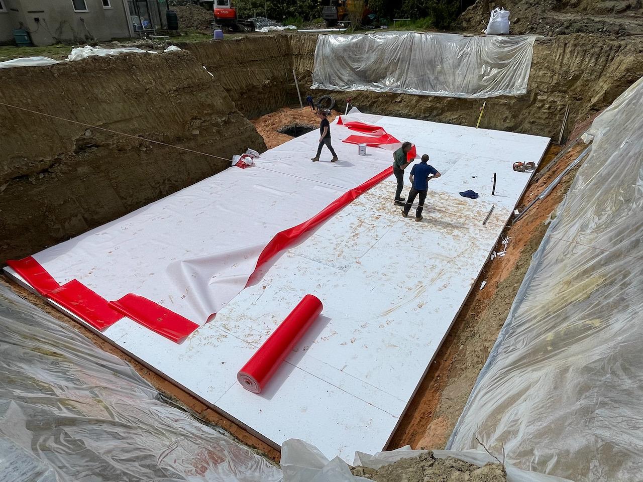

We have 200mm EPS300 specified for under the slab and this was laid by using a long telescopic rule from the profile board strings 4m above at ground level. We are supposed to have a 200mm toe outside the slab and luckily I was outside when the basement contractor's engineer came for a site visit to set out for the slab and I asked if it was square and was told it was a bit off in one corner. a bit off turned out to be 70mm. now, in my mind if a structural engineer tells me that the 200mm toe is needed to take the 45° load from the walls above then you really should have a 200mm toe and 130mm just wouldn't cut it. you'd think that wouldn't you? but, it turns out that unless I was there to ask them to move the insulation so that I had the correct toe all around it it wouldn't have been done as the corner points had already been marked. I got a few huffs and whinges about 'but we've already set out' but there was no way I was letting it slide and made sure I was happy with the toe widths. This just goes to show the importance of living on-site as I pop out every hour or so to get a break from my desk to see what's been going on. if I didn't do that I wonder what else might get missed and just covered up?

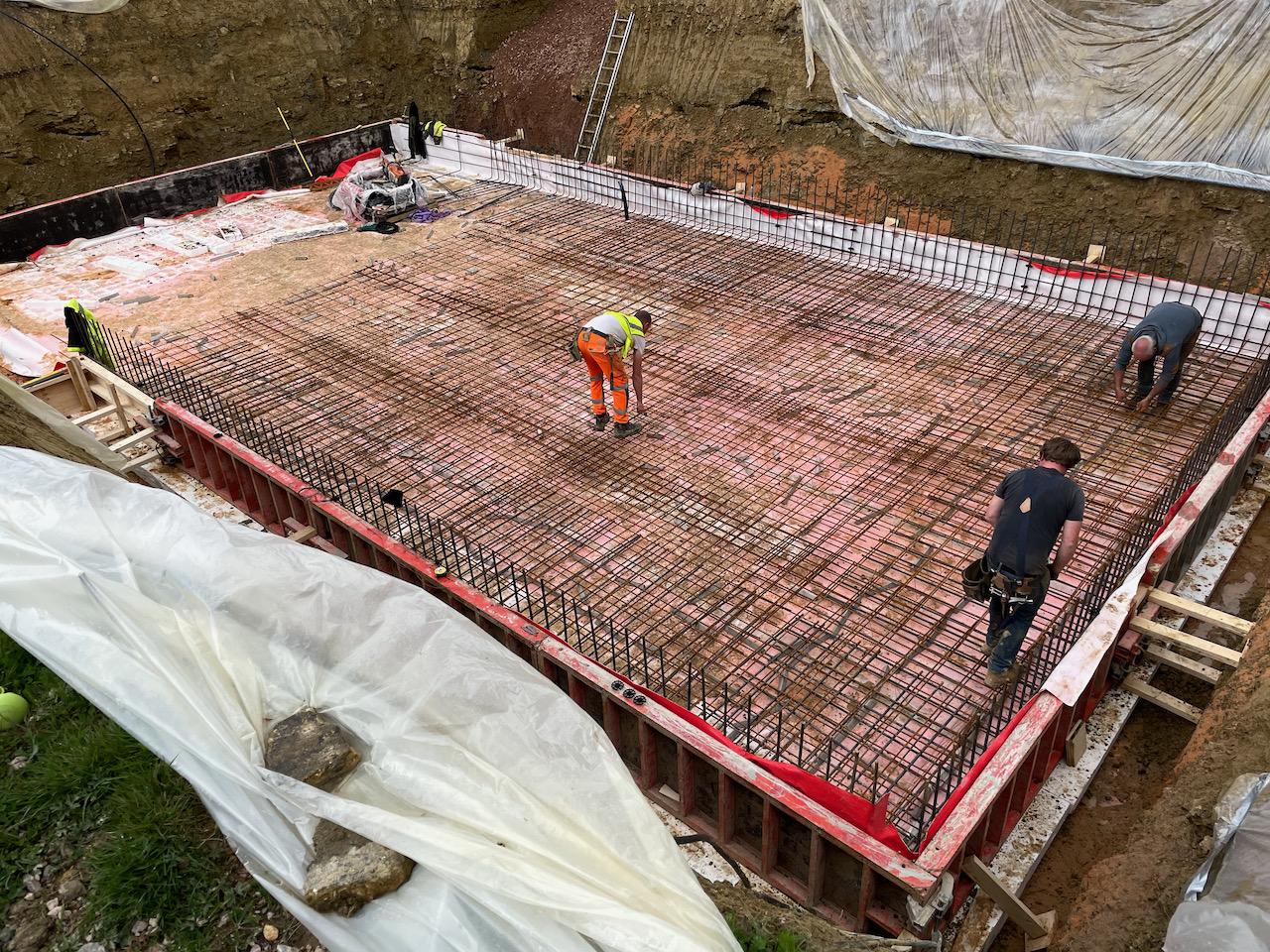

Anyway, after the corners were set out the FIS waterproofing membrane (http://www.fisproducts.co.uk/product/maxiprufe-plus-2/) was put down on top of the EPS300 as this will then join the same membrane on the walls to form a waterproof wrap around the basement to ensure Type A protection and with the Type B waterproof concrete that will give us our 2 forms of waterproofing. Following that was the formwork, steel bar and mesh, hydrophilic strips (http://www.fisproducts.co.uk/product/cemflex/) and kickers and then we were ready for the concrete.

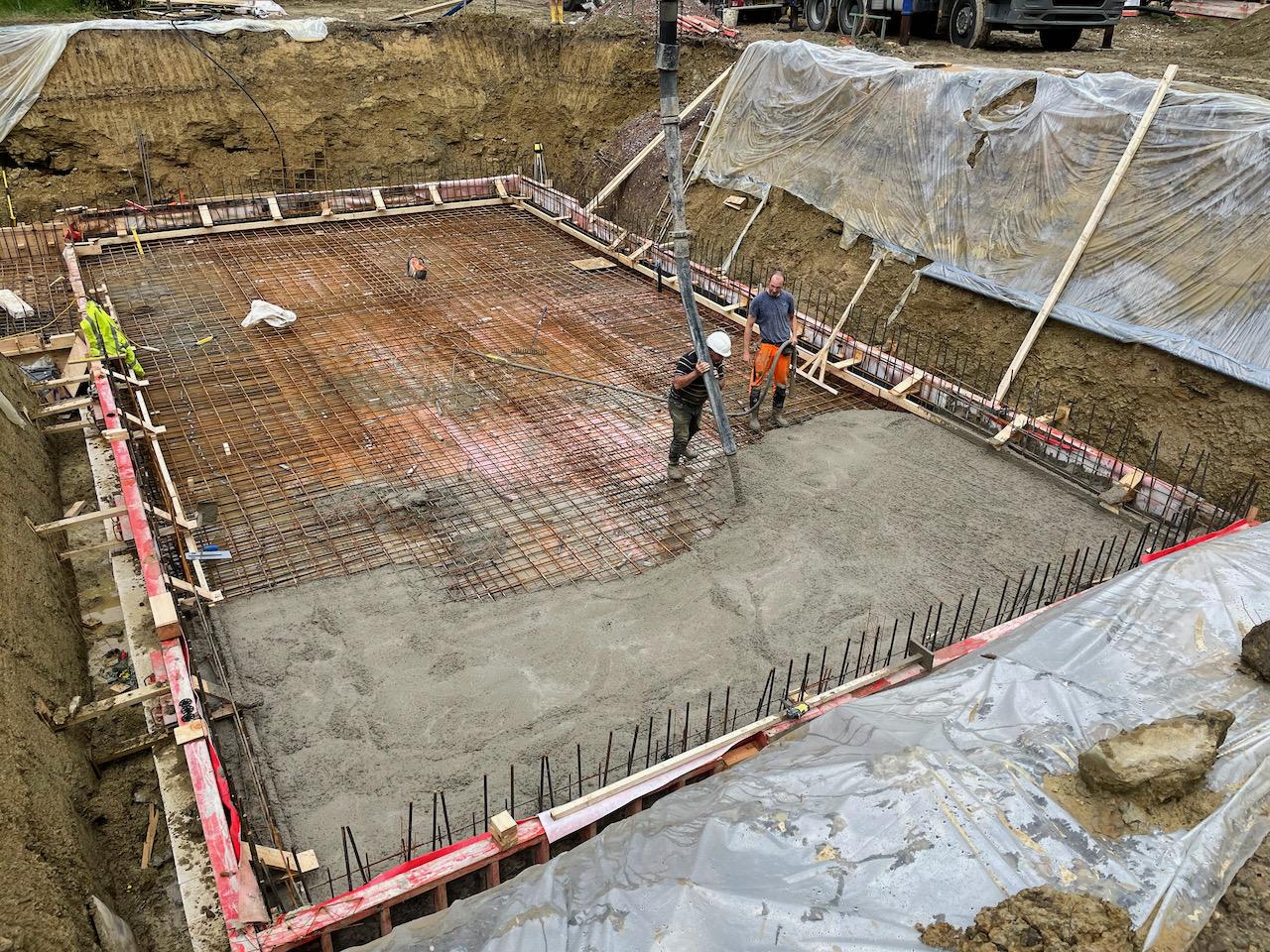

The day of the slab pour came and we were extremely excited. It was though, as I’m sure it is in most cases, a very last minute dash to get ready for the pour. The contractors were let down by a couple of extra pair of hands on the morning of the pour so they were rushing around finishing off bits in between lorry loads of concrete. it all worked out ok in the end though.

The waterproof membrane on the EPS:

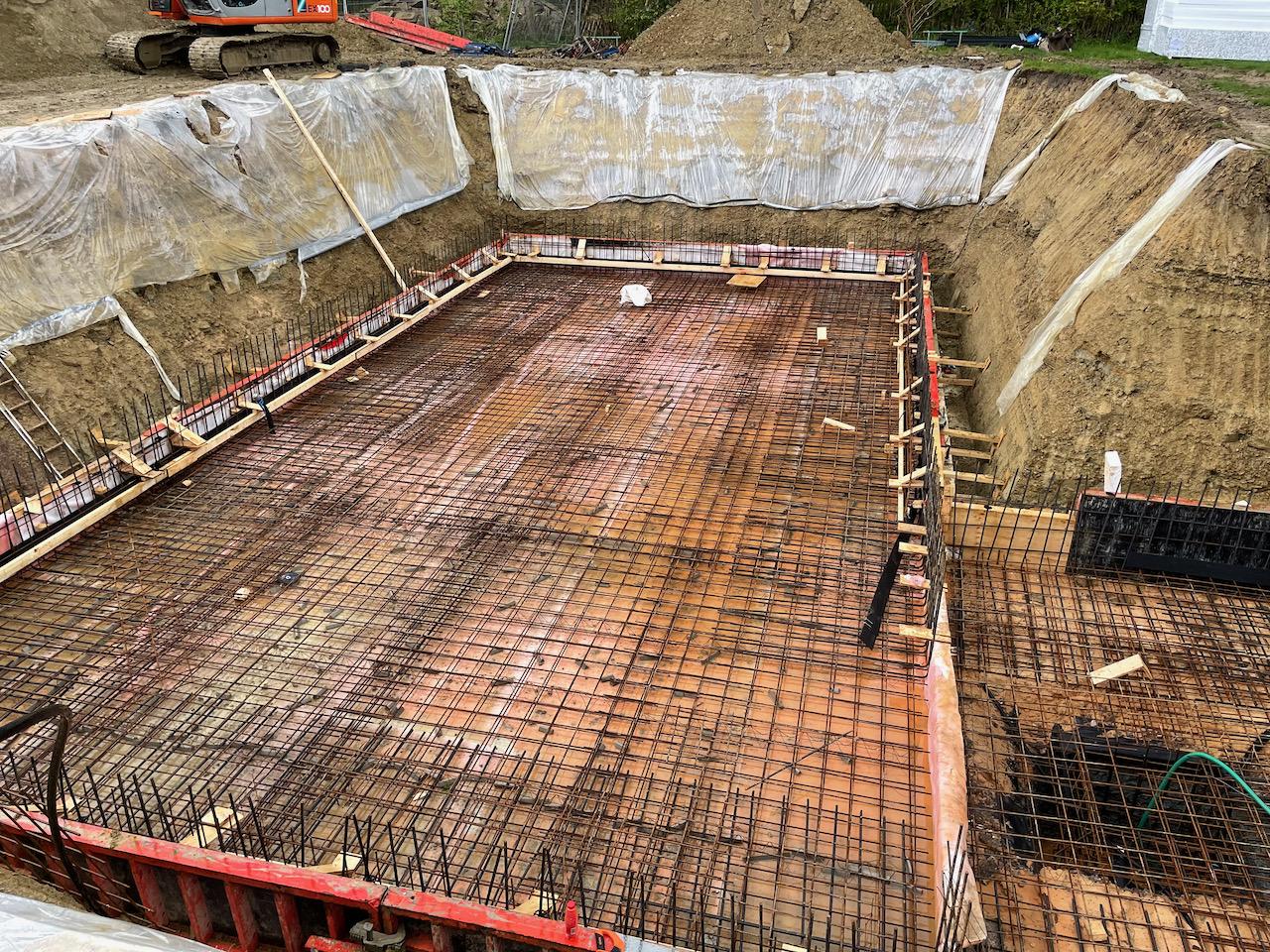

Formwork almost complete:
Steel mesh:

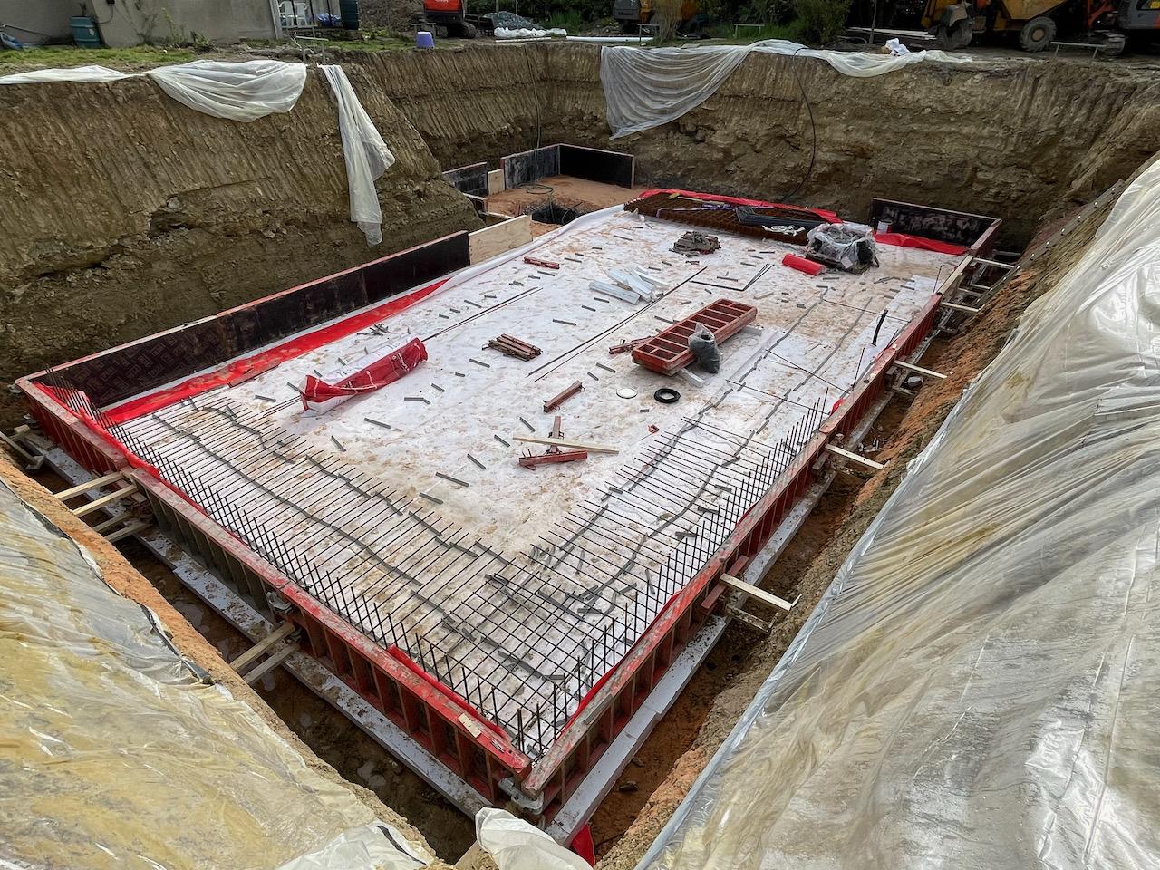

kickers almost finished. the final ones in the courtyard (to the right) were done on the day of the pour:

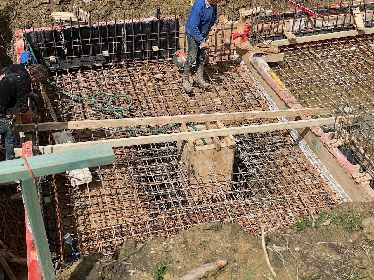

The shuttering for our sump in the courtyard:

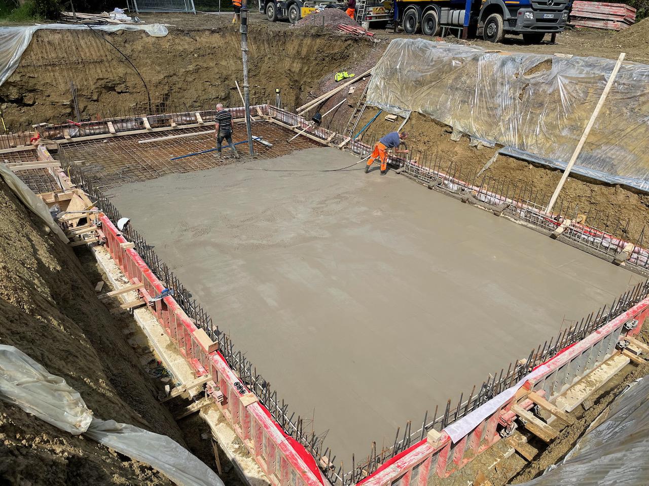

first lorry load:
almost there:

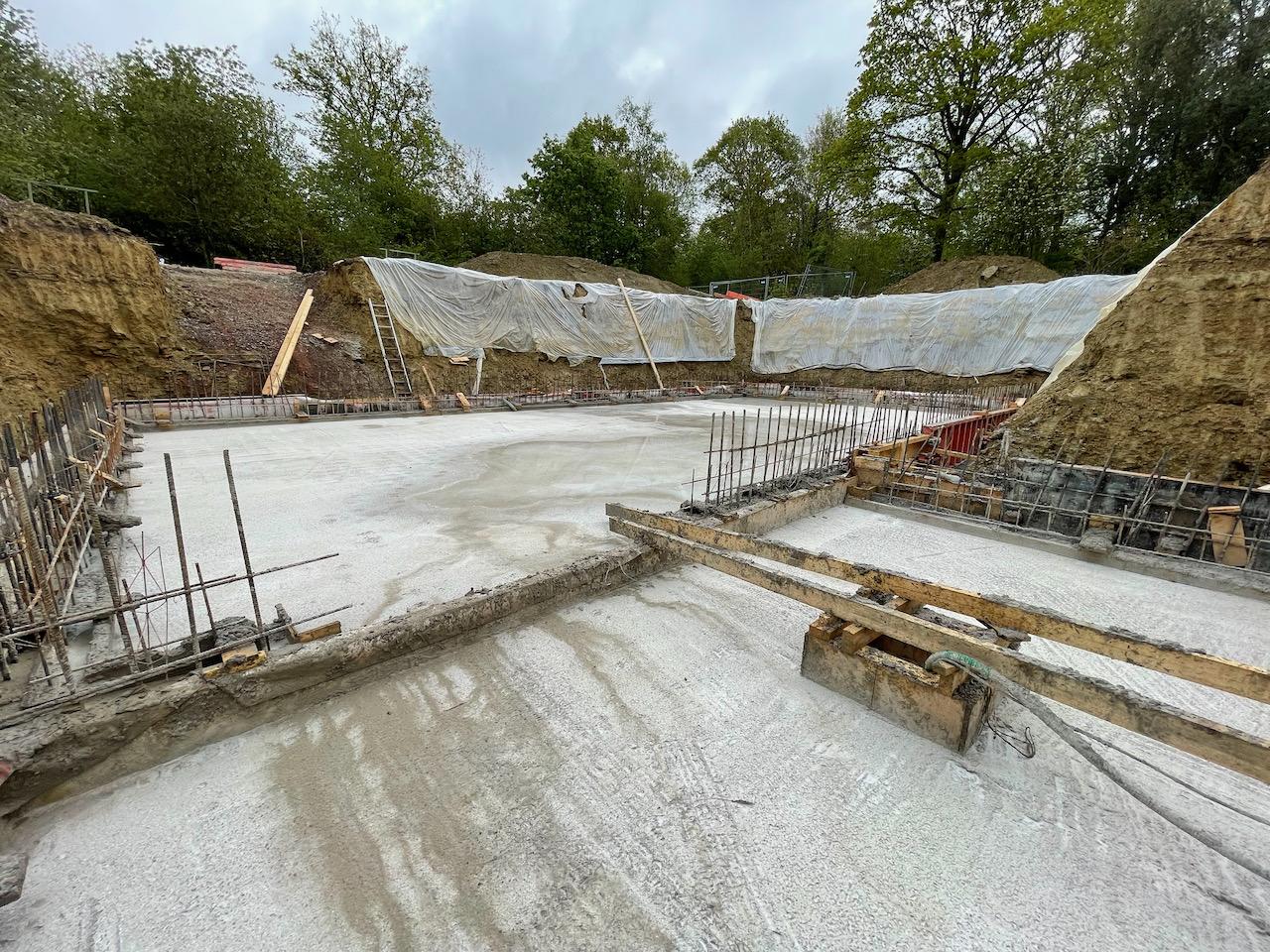

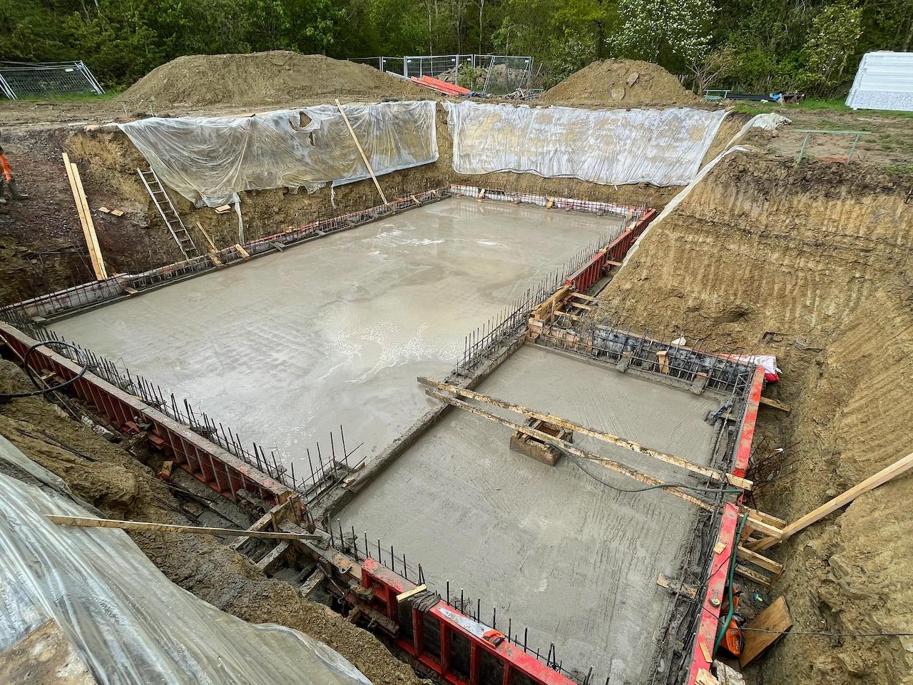

finished:
sadly the weather turned a bit for the worse during the pour and the finish isn't perfect so we'll probably have to put a self-levelling screed down but we can cross that bridge when we get to it.
the next morning:

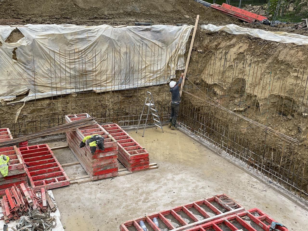

After they struck the slab formwork they made a start on the wall rebar. it's only now that I see it up that I realise how bloody high the ceilings will be! 3m was the request and that is what I got.
painting them will be fun. ?

This week they’re starting on putting up the formwork for the walls and we’re hoping to get a pour in towards the end of the week which will be great. I was told that the walls should take about 3 weeks in total so we should really see some great progress over the next few weeks.

This membrane - there will be separate rolls for the walls attached to the ones under the slab? Do you have any indication of the cost - I know you have groundworks as a package.
Sorry, more importantly: great progress and an excellent catch in the corner!
yep, the horizontal membrane goes up the outside of the wall a bit and is overlapped by the vertical membrane on the walls enclosing the whole basement in a membrane.
with regards to costs the waterproofing section on the quote is around £10k which also comes with a 25yr insurance backed warranty. it's a cost I'm happy to pay for peace of mind.

What is the deep hole area that appears to have shaft leading down to it?

11 minutes ago, Carrerahill said:
Even now with my build nearly done, any excuse, I get I order a ton of all in one and get the mixer out.
it is a sump for the land drain and the courtyard drainage. the water then gets pumped out to, eventually, an inspection chamber and then discharged.
