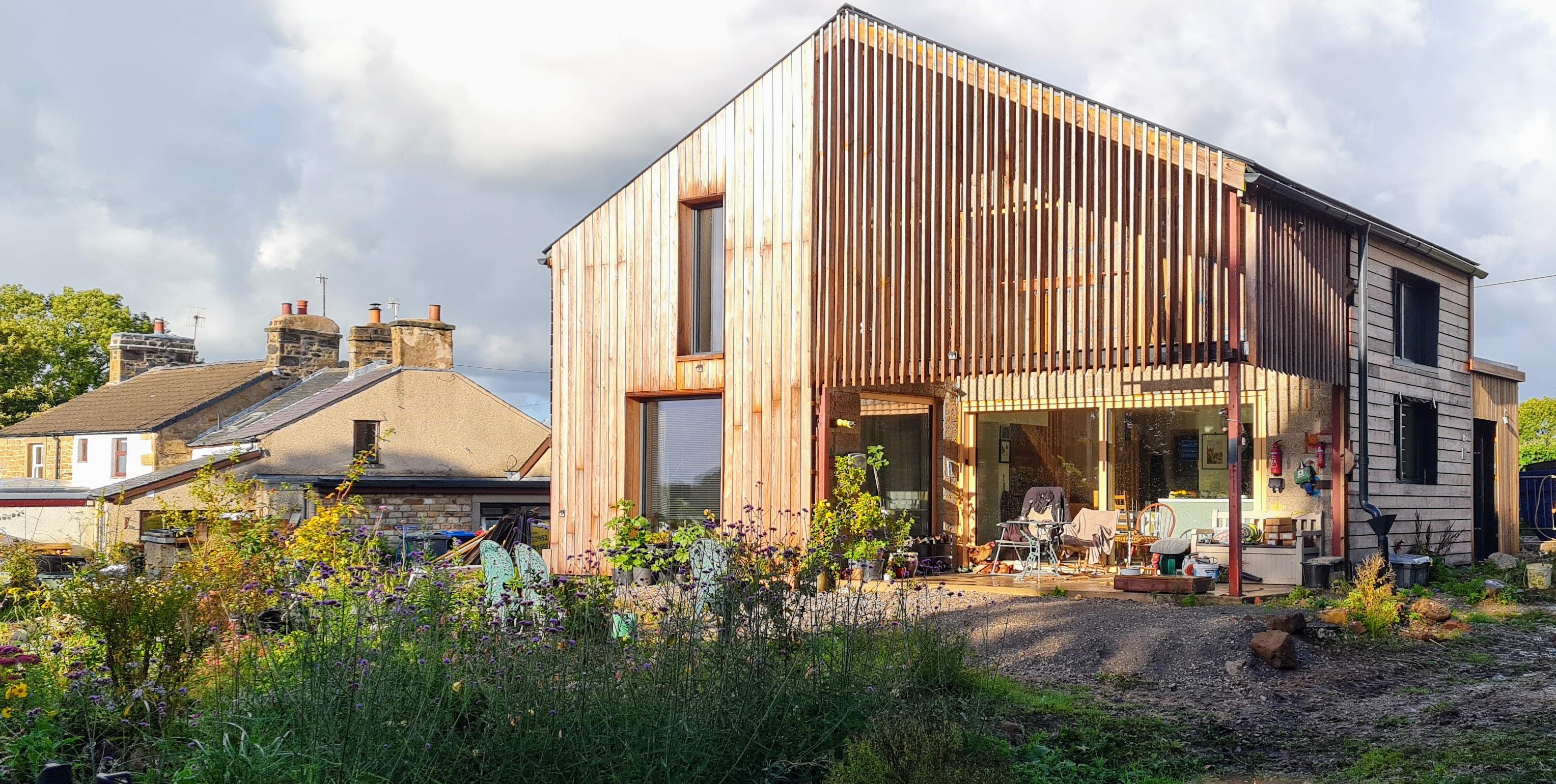

ToughButterCup Posted September 27, 2021 Posted September 27, 2021 (edited) 4 hours ago, cowsgomoo said: ... Maybe someone else can suggest the best bits tho?! i just havent got that far ? Just clearing the site today and it occured to me as I filled the skip (last one?) I know what I paid for every bit of 'rubbish' I threw away ? The early evening sunset on the cladding knowing everything about a house knowing I can pull myself up from major disasters being grateful for all the friendship of the vast majority of (chatty) passers-by. the banter on BH knowing what some locals really think of the house, as opposed to what they say in public fora all the well-meaning advice from everyone who offered it the silence from those passers-by manage to read my non-verbal cues @SteamyTea, @PeterW, @Stones, @ProDave, @Dudda, @jack, @Moonshine, @scottishjohn, @pocster, @Onoff , @Jeremy Harris, @Construction Channel, @the_r_sole, @Crofter, @Ferdinand, @MikeSharp01, @newhome , @Declan52, the Mods, The Foundation Group (I've missed some I'm sure) , all people who have bothered to give me their time and thought my mates who come round and (mostly) help. If you buy a digger, they just want the keys. the ability to keep going under pressure: if I didn't have that pressure, I'd become a fat(ter) slob the knowledge that I'm probably over-priviledged: at least very very lucky. Retiring the day we got PP and done nowt else but this for the last 5 / 6 years. I've lost count of the passers by who stop and talk wistfully about their dream of being able to do what I have That gorgeous lass who jogs past the site in top to toe super-tight lycra, smiles widely, says Hi. She melts my withers every damn time. That do ya? Edited September 27, 2021 by ToughButterCup 6
