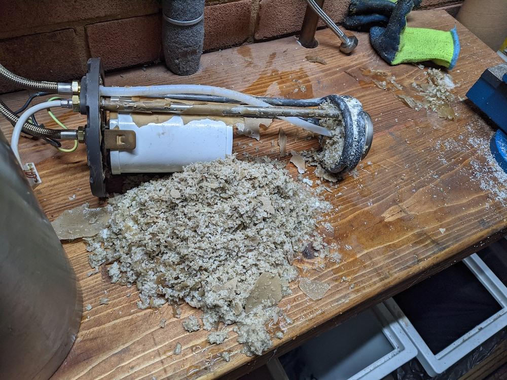

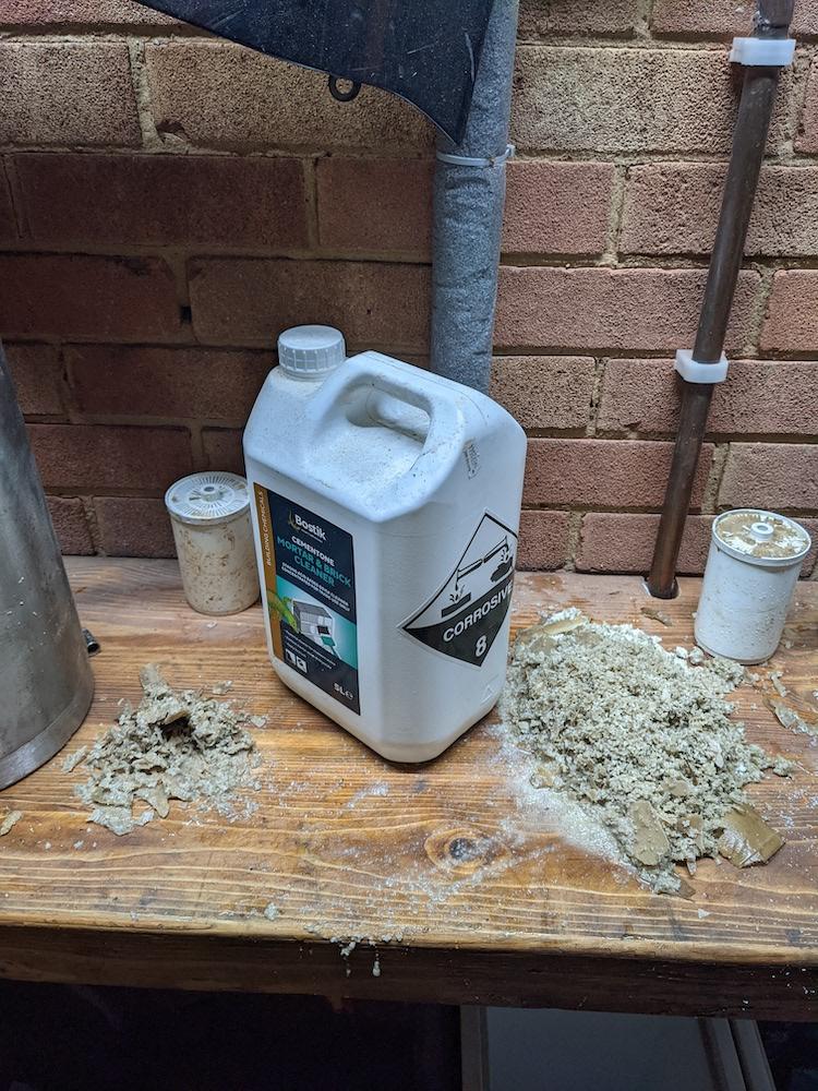

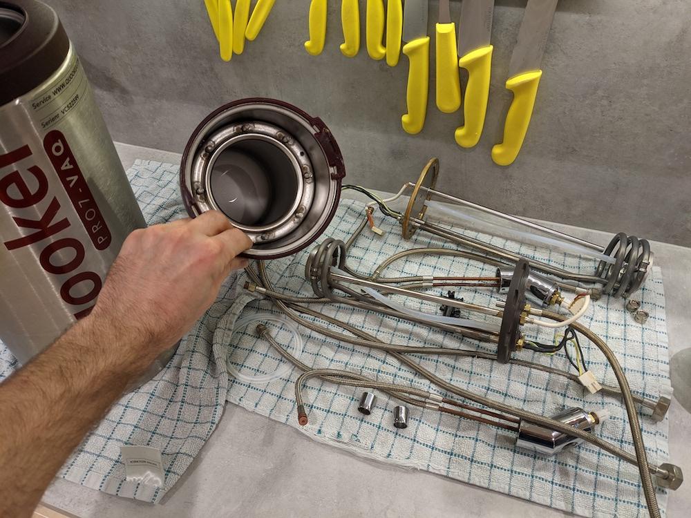

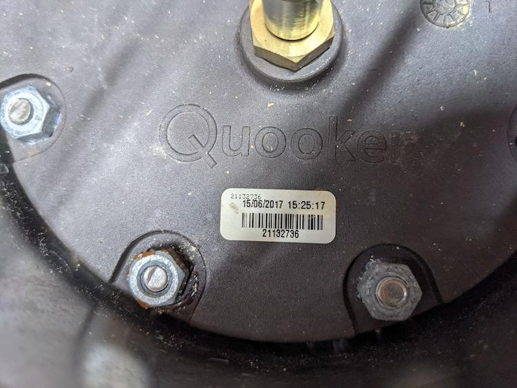

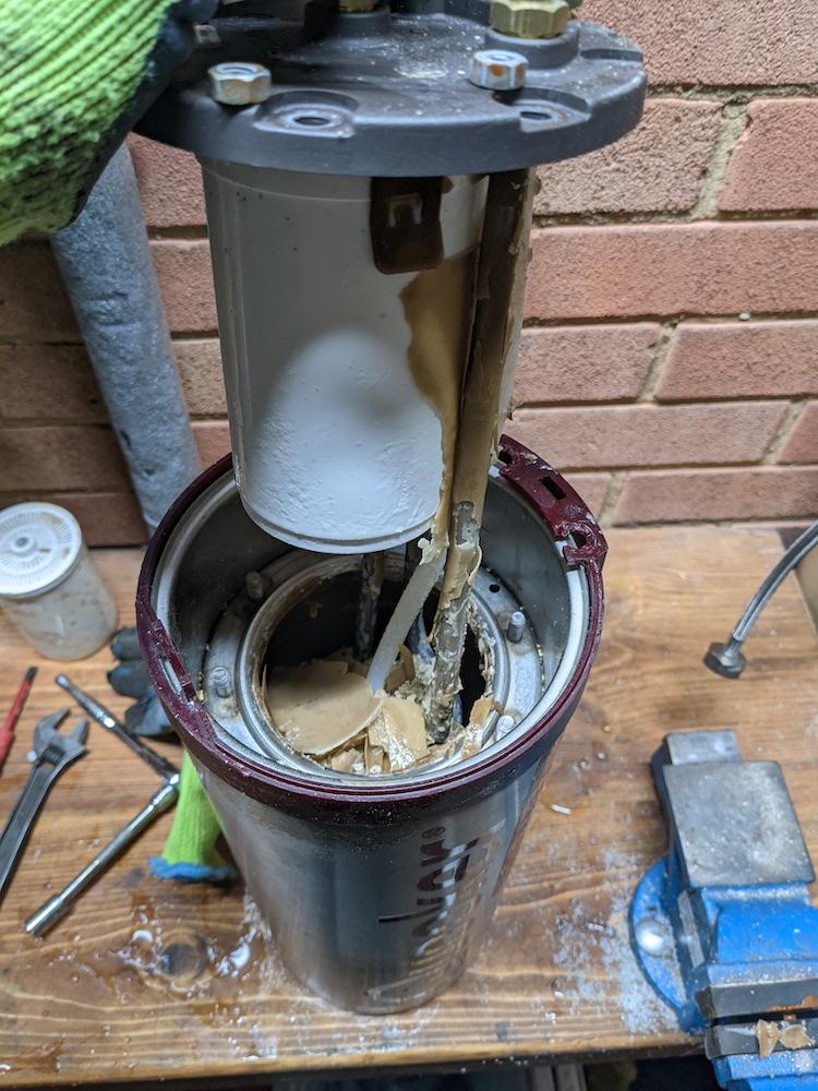

Boiling Water taps. What and where to buy.
markocosic replied to ProDave's topic in Kitchen & Household Appliances
I'm...impressed by how robust the Quooker elements are to abuse by previous owners. I'm...less convinced I'd always want tea made from one of these if I don't know the owner though! Bought used for not a lot. 4 years old. Shouldn't think it's ever been serviced. The mind boggles at the how some folks think things should be maintained. (the woman just replaced the entire tank and tap thing at full retail plus fitting) It's been given the Cambridge treatment (no prisoners taken with descaling around these parts - 80-20 warm water and brick cleaner every other month if you're a kettle) and will be happy one it's got an outlet filter again. For what it's worth the service items are surprisingly reasonable for the Quooker units given what the original items retail at: £30 for a tap valve https://www.quooker.co.uk/tap-valve-31-103-00.html £25 for the filter https://www.quooker.co.uk/catalog/product/view/id/180/s/hitacr-filter-31-004-00/category/46/ Or £95 for a complete set of internals: https://www.quooker.co.uk/pro3-vaq-internals-31-196-00.html ~12 mins to recharge 3 litres at 1600W ~15 mins to recharge 7 litres at 2900W Unsure which to bring with me back to Lithuania as yet. -
