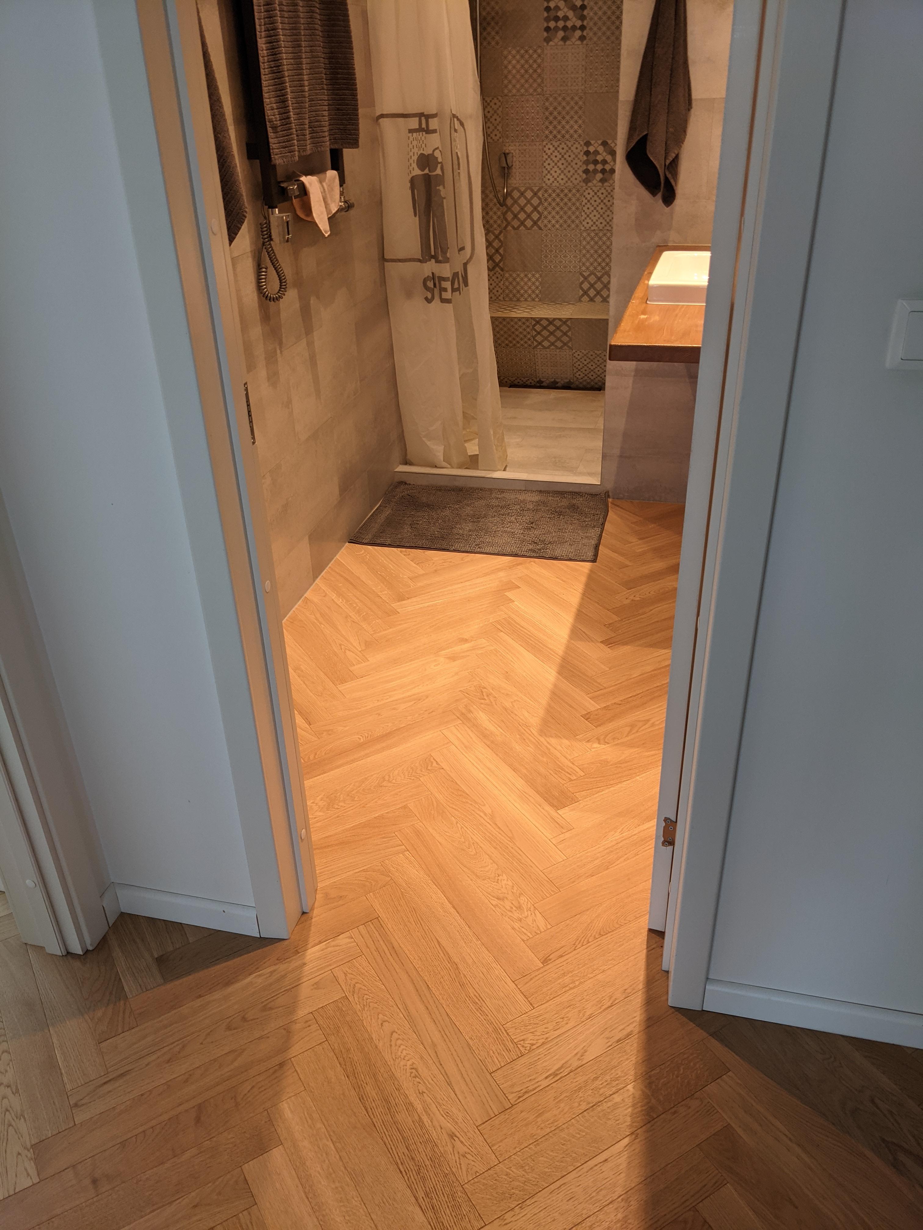

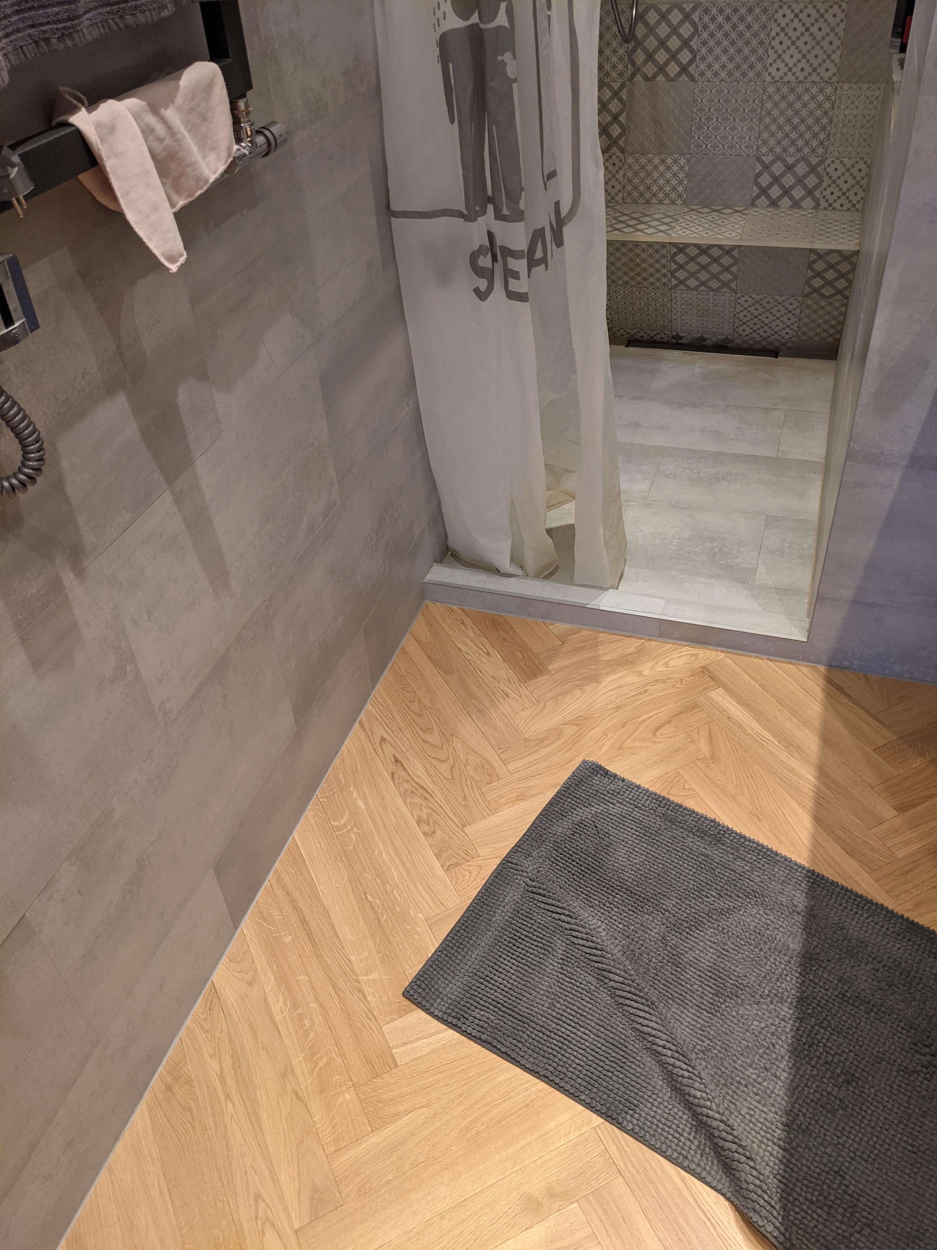

Lifting section: (shower needs desperate clean... :-o) Could be fixed by removing silicone, lifting, and re-gluing. Or by leaving the mat on top. Engineered wood itself is fine if allowed to dry IME -

Currently debating what to put in the next house... For what it's worth this is entirely possible. We've got engineered wood in bathrooms - in a house in the UK and the apartment in Lithuania. You don't need the UFH. Wood is warm underfoot and if the bathroom is ventilated then you don't get moisture and this will air dry to the room as well as through drying through teh chipboard / OSB underneath if it's a 1st floor. UK: Cheap 14 mm planks glued onto 18mm 1st floor chipboard with some 4 mm packers and a 4mm thick electric heating wire (never used though...as wood is warm) underneath it. Commercial 2-pack floor varnish over the top after being laid. (which has cracked a the joints pretty much the second it cured, so it isn't waterproofing the joints) Installed by me so glued to all heck. Maintenance? Take care to keep it dry. One bath mat sat in the "centre" of the floor that is moved regularly. House has MVHR with ridiculous boost extract from bathroom so bathroom air is never humid. Been down 2 years. Looks the same as they day it was installed. 8 mm expansion gap with silicone in it to the bath side and to the tiles around the edge. Lithuania: Herringbone oak parquet glued onto screed. No UFH. No varnish on top. Installed by general purpose builders so probably very lightly glued onto dust in a hurry. Minimal say 5mm expansion gap to tiles because she doesn't like to look. She also insists on keeping a mat right by the shower right up to the edge of the floor. As such...it can never dry...and the parquet is loose where you step into the shower. Completely undamaged by moisture though. Just lifting. This has been down 5 years: Wall hang the sink and toilet. Much easier to clean and you can set them at a height for adults instead of 5 year olds. The cheap 14 mm UK boards run into the hall, then transition nicely to 11 mm underlay plus carpet in bedrooms. No height difference; standard thresholds. I also have it throughout the downstairs including the kitchen. Only real maintenance tip is to RAISE all your appliances by the same height as the cupboards and put a plinth under them. Seal the gap between the plinth and the floor BEFORE somebody spills milk. Much easier to keep clean. -

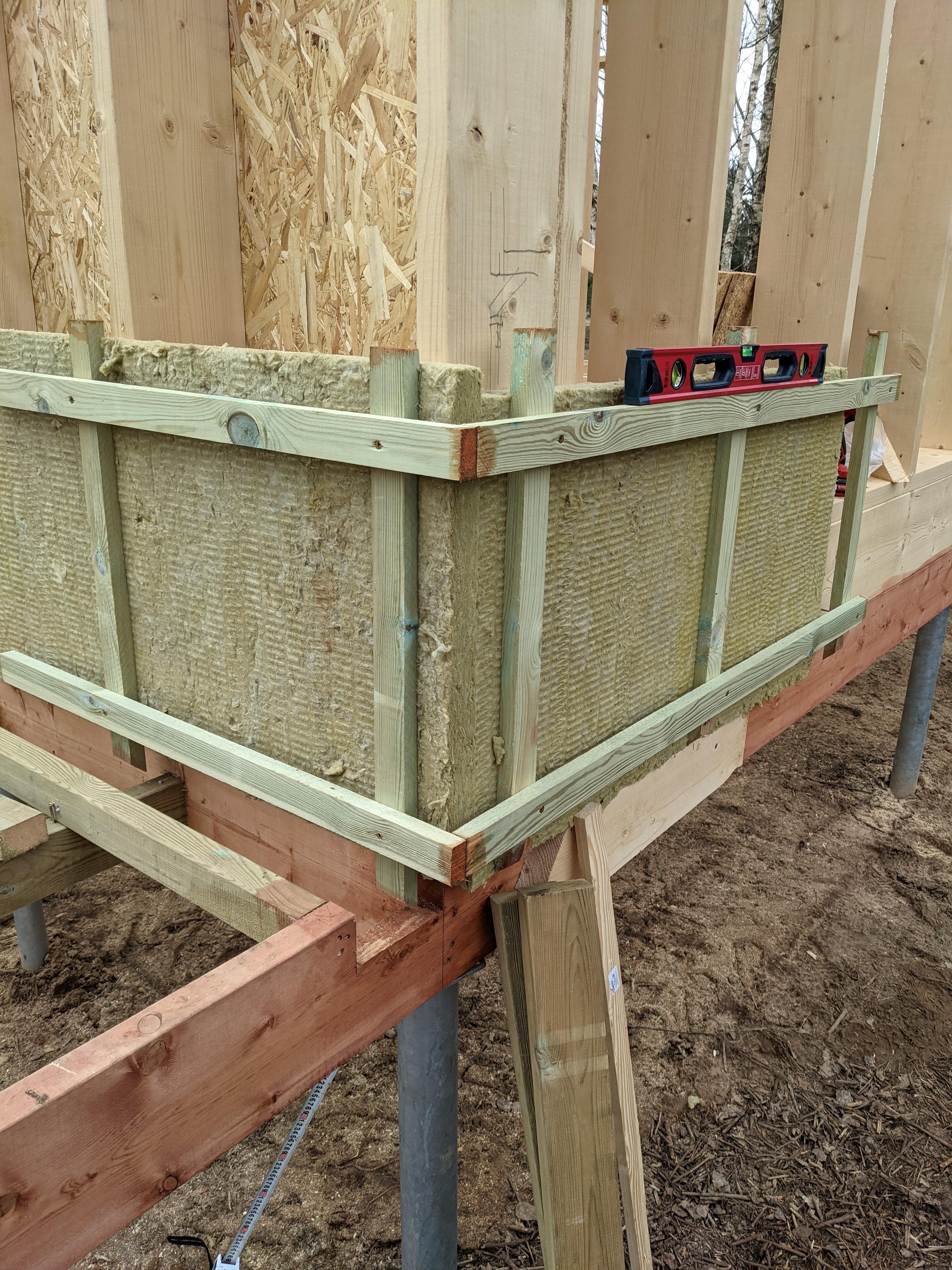

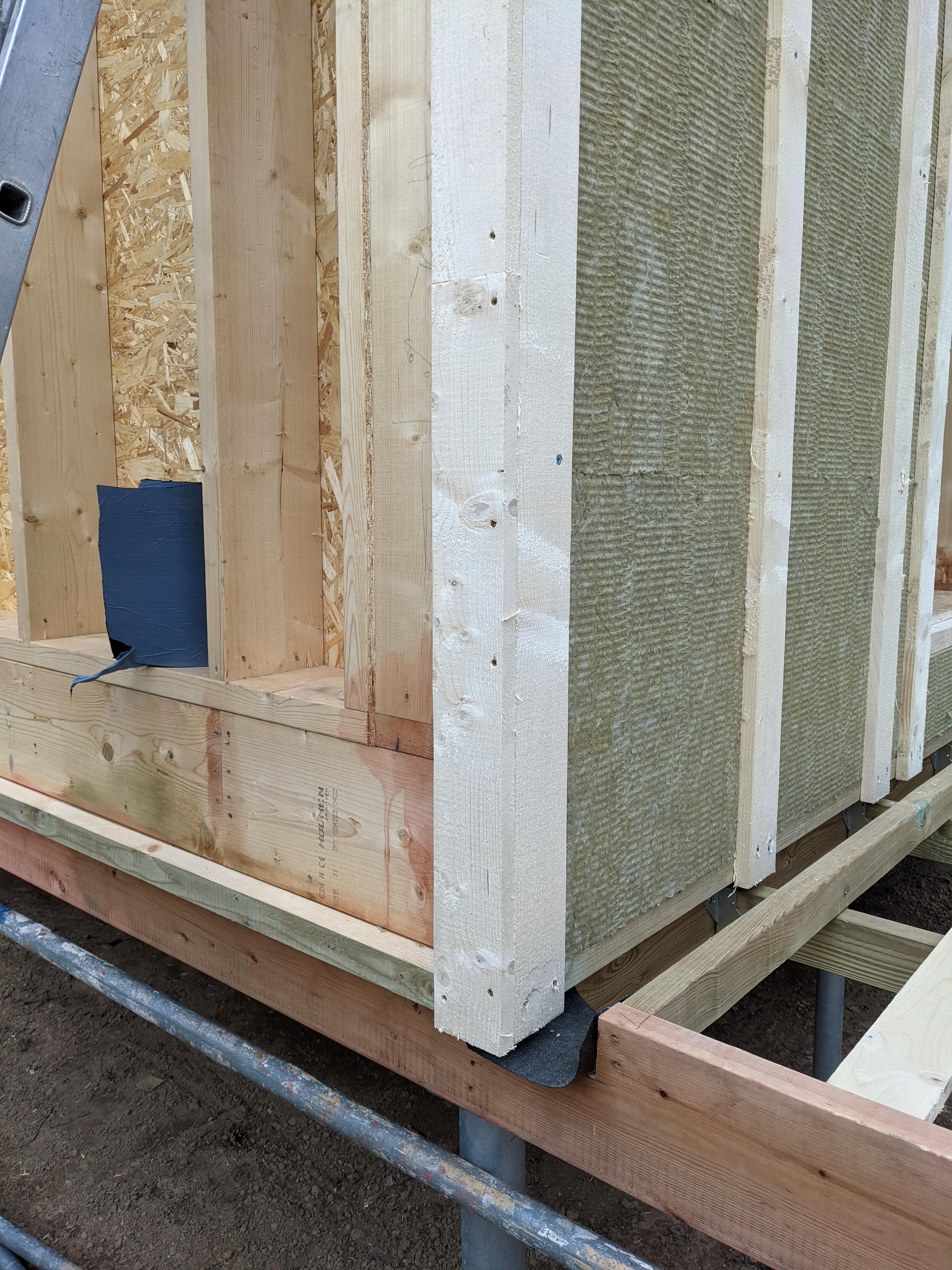

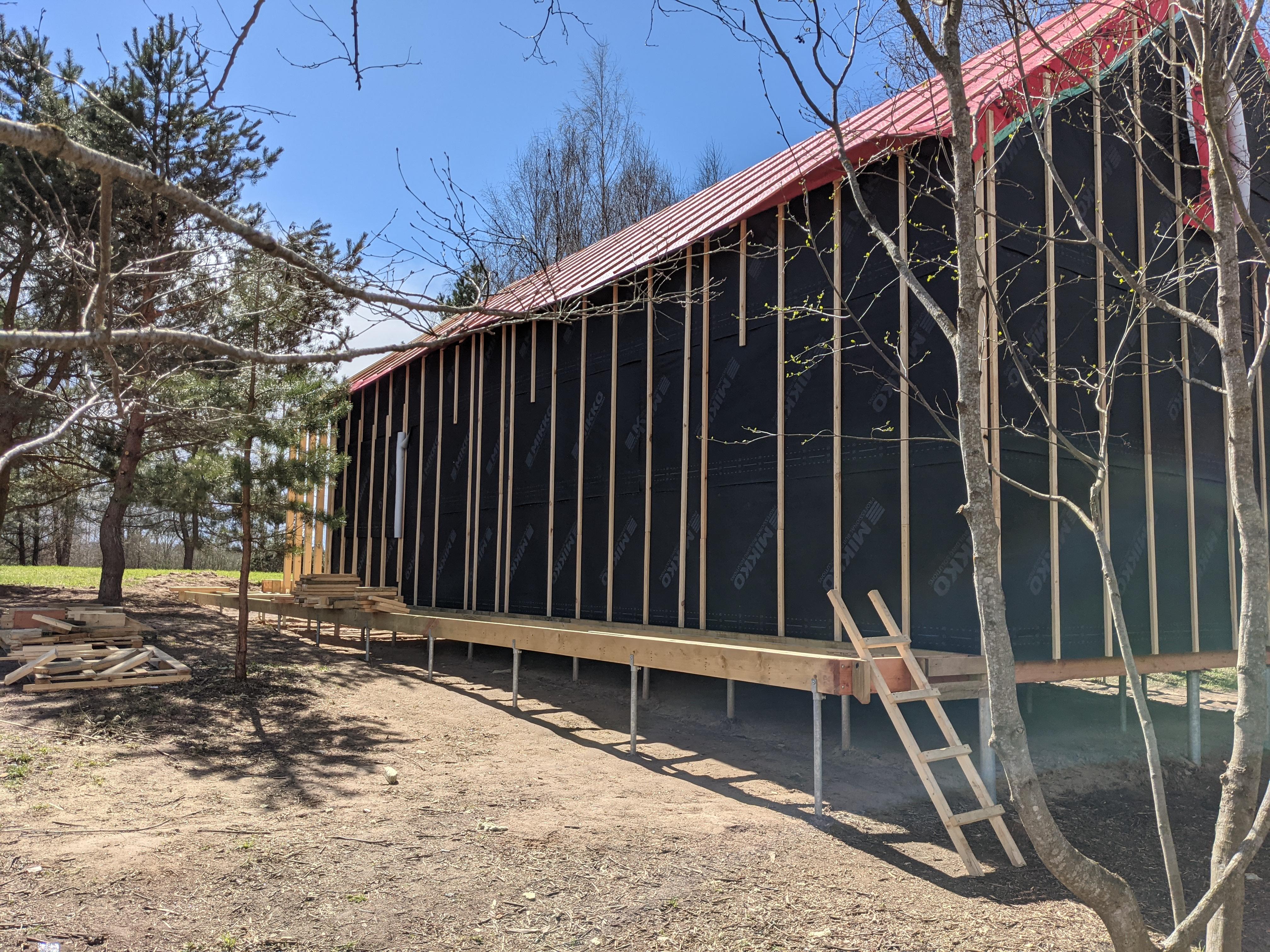

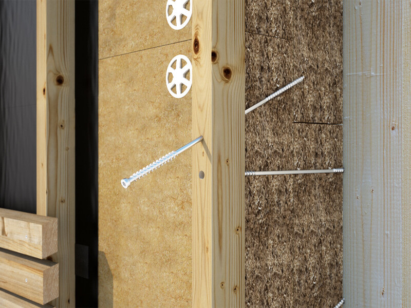

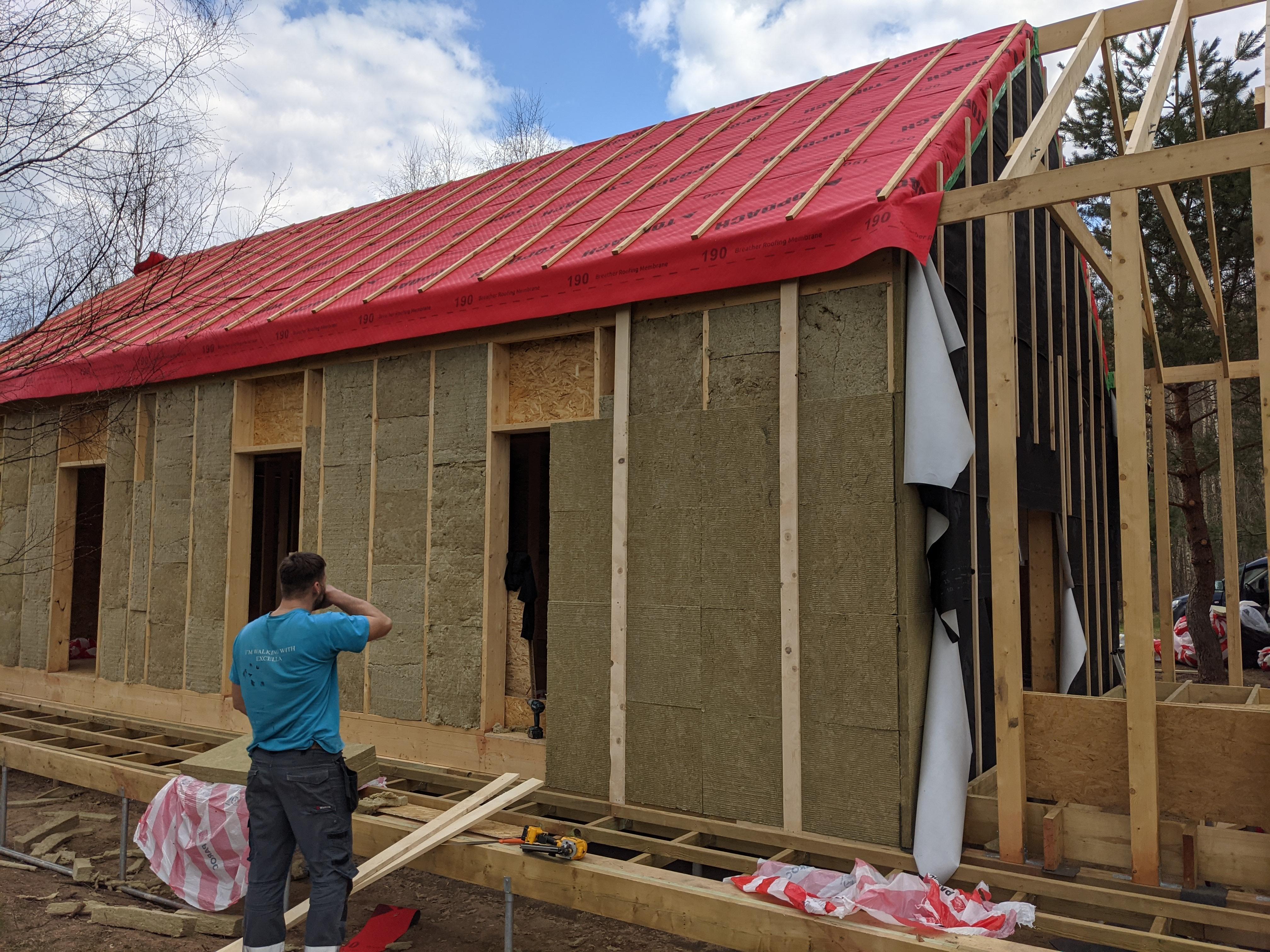

And some other details we looked at when switching from lightweight to timber cladding: That "create a truss using screws" model can work in places where it's too difficult to put a horizontal batten in place. We ended up using one (which goes in place if the insulation - 45mm for 69mm nominal insulation) at the footings and one at the eaves of the roof. Much like the second image but on a smaller scale!

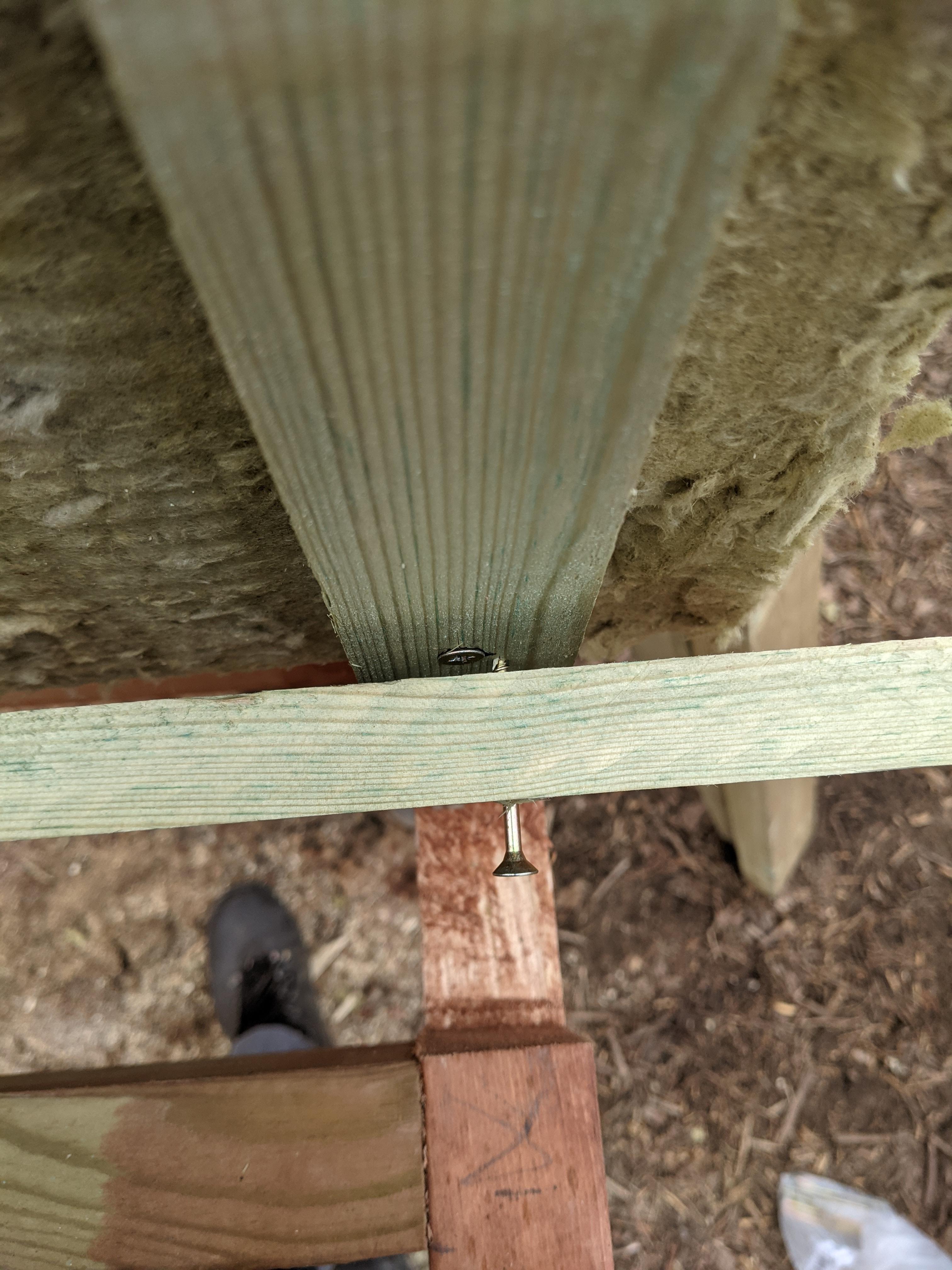

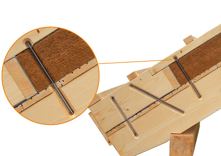

You might find these useful: https://dmxsystem.com/en/group/wds https://www.varztupasaulis.lt/?gclid=CjwKCAiAmrOBBhA0EiwArn3mfNQLCp15vhFhjPkY8PQm5b-Hb6XhpSAtJ7PMB0vT2q_5A6cKgoUoeBoCJusQAvD_BwE&locale=en#!gid=a6f22c80-99ac-11db-8870-000423473dd4&details=3f33129c-e602-11ea-0480-000c2926ea9c&tab=1 It's a screw with one way barbs under the head. You screw it through the strapping and into the stud. The barbs grab the strapping. You can then screw it in/out and the barbs give you some pressure resistance - enough to walk on whilst you're building the roof without/putting the horizontal battens on anyway - whilst the heads give you suction resistance. I prefer physically locking the head by putting the horizontal battens directly on top of them though.
Showing overlapping screw detail. First vertical batten can't come away from wall but can "over squash" the insulation. When you lock it in with the second horizontal batten the vertical one can no longer "slide further down the screw" because the head it locked against the horizontal batten. You need to take care how you drive your screws with this method (heads must be flush - countersunk but not buried deep into the first batten) Drip edges on vertical batten. We laid some bitumen in a "u" shape to protect the (external deck support) wood from water pooling on it. Not the best detail in hindsight!
An earlier attempt without any horizontal batten. This works for lightweight cladding if fixing at 460 mm centres with 6mm screws. (we were going to use wriggly tin / bitumen originally then decided that it was just too ugly - the yanks use similarly lightweight vinyl siding)
Membrane and an extra layer of strapping variant. (ready for horizontal battens and in this case vertical cladding but tile.would.be similar)
Stacking insulation behind loose strapping (fix at 1200 centres first, then add the others later it makes adding the insulation easier)
mineral wool over frame filled with soft mineral wool. The horizontal batten is in the foundation frame (footing) not the rim joist.
Put a horizontal batten that is the thickness of your compressed insulation near the ground to take vertical load. Preferably on the (cold) footings not as a thermal bridge to the (warm) studs. Screw fixings to take shear load. Put vertical strapping (e.g. 25*100 mm) on the wall. The bottom is fixed rigidly to the horizontal batten. The top is loosely screwed in for now. Slide your insulation panels behind it. And membrane if your using one that goes directly onto the insulation. Then screw through the vertical strapping into the studs. Compress your insulation the required amount when doing this. You now have vertical straps that can carry suction load (pulling away from wall) and vertical load (via that horizontal batten at the base) Now fit horizontal battens ON TOP of the screw heads. Screw these into the vertical strapping. By "clamping" the screw head that was attaching the vertical strapping you prevent pressure loads from pushing the vertical strapping into the wall. It also locks the vertical strapping together in a horizontal direction. Tile onto that. Variation: if your membrane doesn't go directly on top of the insulation then put the vertical strapping on first, then staple on your membrane, then put more vertical strapping on top to "lock" those first screws in. Then go horizontal on top of those. Another variation: if your insulation has some compression strength then you don't need the bottom horizontal batten. Just put your screws holding the vertical strapping on in at an angle (upward towards the studs) so that the screw is the tension member and the insulation is the compression member of a truss. (Rockwool USA approach) You can't nail in this application. Will dig out some photos...
