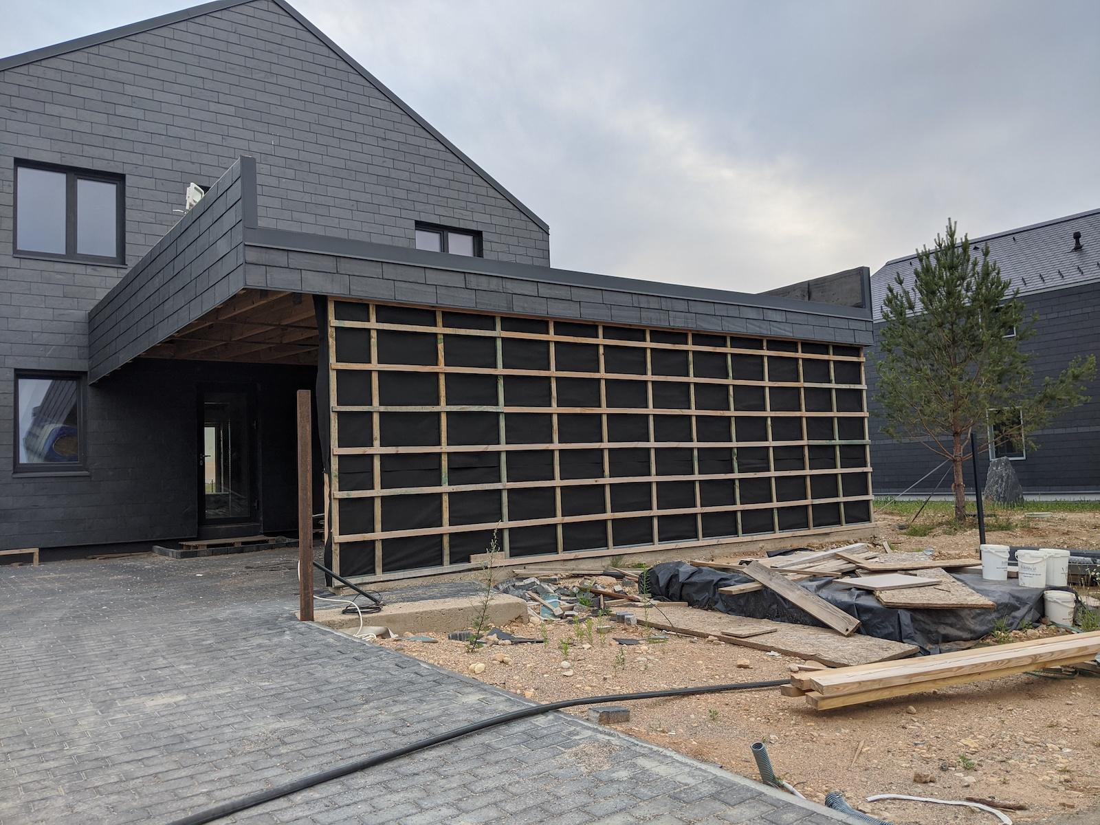

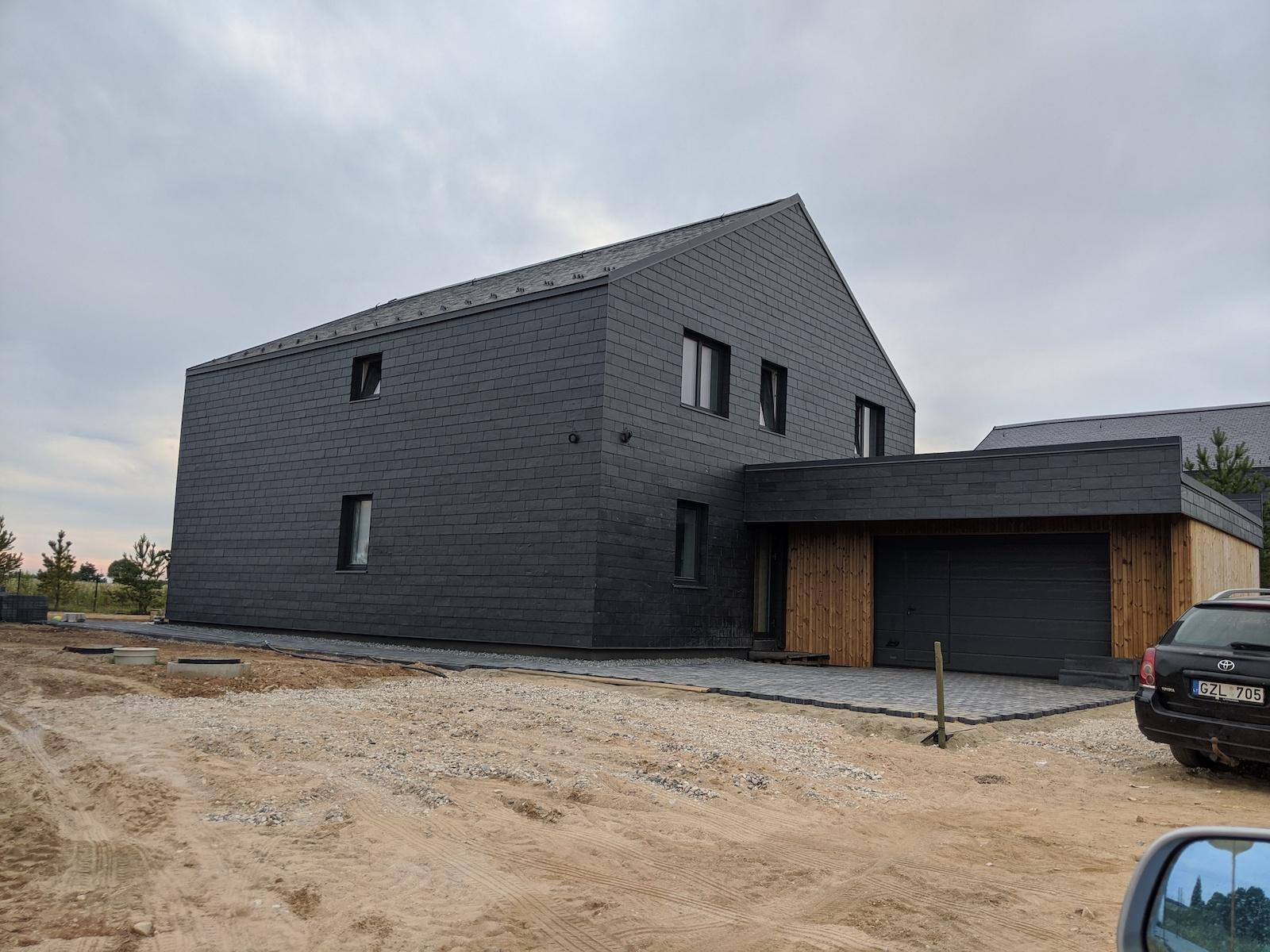

That first one looks like ~500 mm standing seam on a 9-10m long "1.5 storey" building (left side full height) to my eye - scale it from the velux windows? Slate example attached: -

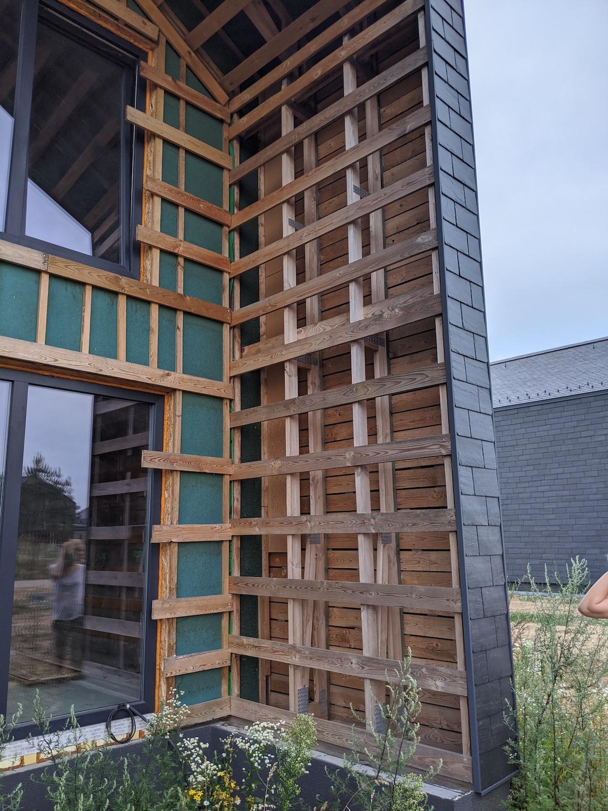

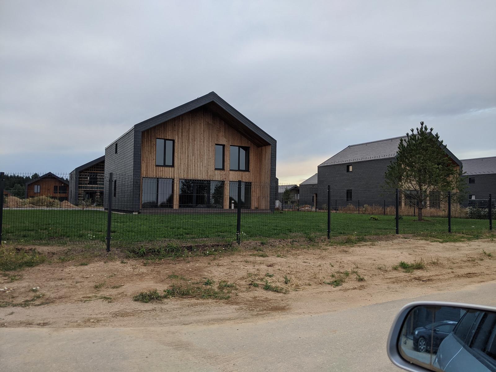

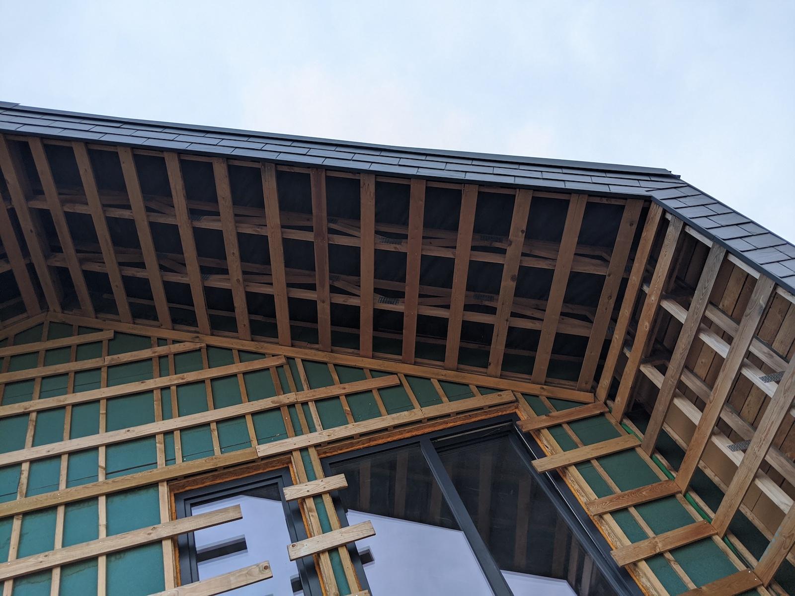

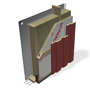

Cement boards are definitely a classic ? https://lemora.lt/stogo-danga-priedai/stogo-danga/siferis/3189-eternit-agrol Hardie plank is a safe option for a decorative open rain screen. It's heavy though. Not as pretty (looks plastic to my eye) but long lasting. The comments EPDM and not trapping moisture within the wall structure would still apply though. Standing seam - I suspect the first image that you attached looks messy because nothing lines up (roof vs walls) and the walls are covered in unnecessary seams. (that length can be made in one piece) Standing seam roofing can be premade zinc plated / powder coated steel too rather than made off the roll. Max off the shelf length on Rukki is 10 metres. It's ~€15/m2 in the baltics but how much it would be to import to the UK though. https://www.ruukki.com/roofing/products/roofing-sheets https://nordicroofing.co.uk/ "Architectural" panels have wider (~1m) spacing between seams if you want fewer of them: https://www.kingspan.com/gb/en-gb/products/insulated-panel-systems/insulated-wall-panels/quadcore-architectural-wall-panels-ks600-1000 You might want the opposite with MORE seams (or ridges) to make them less prominent rather than a hard seam every 500 / 1000 mm though? I think this looks clean because the seams between panels are much less visible, they're the same on the roof and the walls, and the gutter breaks any mismatch between roof and the wall: -
The devil is in the detail... of hidden rainwater drainage
markocosic replied to DKR's topic in Introduce Yourself

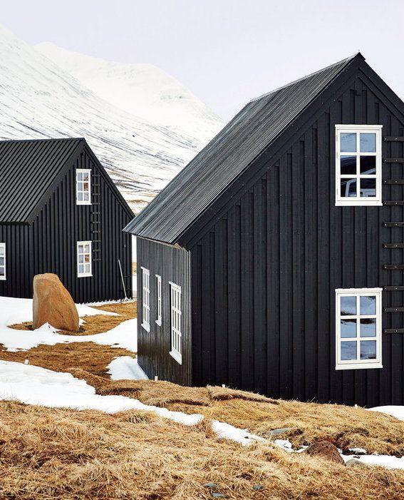

She she must be obeyed also liked that style. Monopoly house / plain barn in burned wood is very much in season at the moment I'm told. If you're prepared to do it in standing seam metal (e.g. Rukki roof) it's pretty easy. Water proof / air proof but vapour open membrane. Vertical then horizontal battens. Metal roof that turns into metal wall. No gutter. Lift the bottom of the house >0.5 metres off the floor to avoid backsplash. Ditto in slate or other doesn't really rot type material. In wood... You can have a decorative wooden cover over a metal roof. Use trapezoidal metal panels with horizontal battens fixed to the ridges. Attach your "open facade" to those. Expect the tops of your boards to rot quickly. You can have a decorative wooden cover on top of an EPDM roof. Drape the EPDM over the "vertical" battens so that you have the equivalent of trapezoidal metal panels but in EPDM. Attach horizontal battens to these ridges. Attach your "open facade" to those. Expect the tops of your boards to rot quickly. "Open facade" approach not ideal. Leaves and other debris will fill that drainage cavity over time (it isn't getting huge water flow or wind to clear it) then your battens start to rot...never mind the hidden gutter detail. Make the "vertical" battens enormous to avoid this. Vertical tongue and groove is closed...and great for trapping water and reducing your drying area / airflow. Putting a metal ridge on top helps. Sliding a metal strip in the roof-eaves jointline to deflect water off the top of the wall boards would help. An overhang helps. Closing the roof deck / facade helps. It's a disposable aesthetic cover on a building. Make the wood as resilient as possible and it'll take longer to fail. Less disposable is your timber frame. The EPDM should not enclose your wall/roof structure. (don't put a hard vapour barrier on the outside of your wall/roof and expect the wood not to rot - in a heating climate the hard vapour barrier is on the inside and the outside needs to be less vapour open; else you're doing the equivalent of putting a sheet of glass over grass in the sun and being surprised at all the warm condensation under it) Use breather membrane to close your wall/roof, then vertical battens as breathing (for the wall), then OSB and your EPDM. The second wall/roof detail is madness I think. After some research we're going to try this... Overlap boards. Very traditional with pine tar an 3-yearly re-treatment. Less traditional with alkyd/acrylate paints and 10-yearly re-treatment. But if detailed right / maintained is supposedly good for 30+ years. (the limit being how well it is maintained) - Timber frame w/mineral wool (fibreglass falls down cavities; rigid foams between studs hard to fit/detail) - Water and windproof but vapour open membrane that can be laid hard against insulation (not all can be) - 50x25 mm vertical battens / 50x50 mm horizontals (to give nail purchase) every 600 mm - Make from dried 150 x 25 mm boards - Impregnate the boards (rough cut stuff is usually just dipped rather than pressure treated) - Overlap by 25 mm (creates vertical ventilation grooves) - Rebate (10 x 8 mm) the centre of the overlap to create a drainage groove / ventilation groove for the overlap - Paint with good alkyd or acrylate paint... - ...and paint the tops and the areas of the boards that overlap... - ...but leave the backs that are exposed to the cavity and those 10x8 grooves unpainted to aid drying - 5+ cm overhang - Seal the walls to the eaves - Vent from the ground floor to the ridge - Cut the bottom of the wall boards at an angle to crate a drip edge - Make provision to avoid splashback UNDER the house No metal. No EPDM. Wind proof membrane underneath doesn't need to be UV stable. Can replace with metal or slate when you get bored with maintenance. Can decide that in 50 years time you'll be dead and not care. Maybe not the look that they're after. Depends how much fot eh future work they're going to do. -

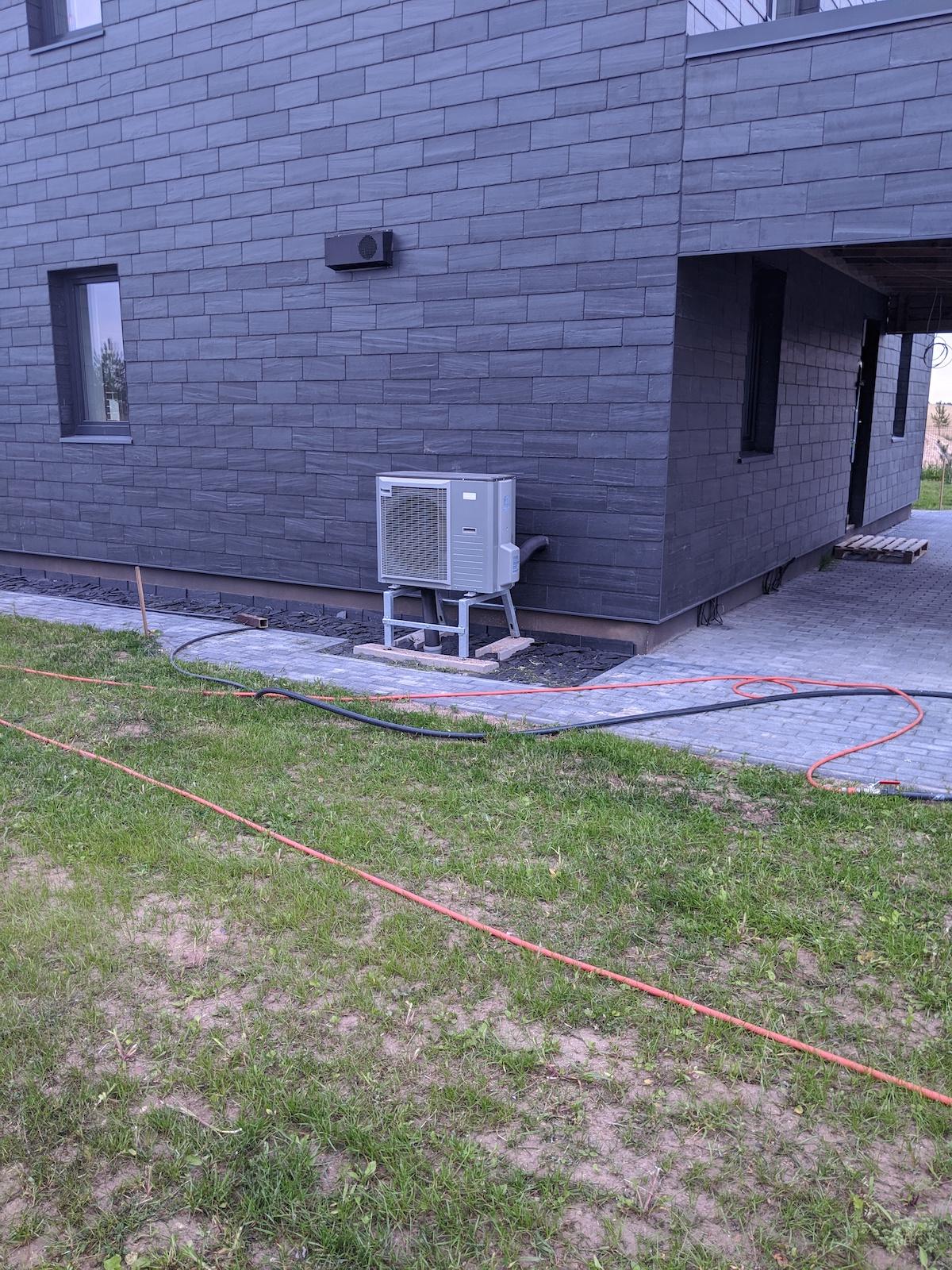

Brand new Panasonic Etherea inverter. Noisy AF before being dismantled and lousy insulation secured. Noisy afterwards. Not as noisy as children with windows open. But audible from about 3 doors down and the noisiest thing in the neighbourhood if operated at night. Fine in rural areas with screening / vegetation and no neighbours but I wouldn't want one on a city plot that you're trying to keep quiet. Bloody effective in heating mode during the shoulder season too (3.4 kW @ -7C but more like 5 kW+ >7C; soon reheats air in a modest building even if walls are cold...but you need higher setpoint for an equivalent thermal comfort due to all that air movement; say 23C on a mini split air handler equivalent to 20C on radiators). Absolute bliss when it's silly hot outside. ? 50 dB(A) is more offensive in person than on video. They high level wall mount then measuring the sound 0.8 metres below the unit for the brochure - real world will be noisier. https://www.saturnsales.co.uk/images/products/editor/CS-Z_Range.pdf That DHP-H 6 GSHP unit is nominal rated at 41 dB(A) and as a fixie (rather than inverter that varies its speed) I suspect it's easier to isolate the vibrations as they're at a set speed. Compressor sits on an isolating frame within the GSHP unit; 400 kg (full) GSHP unit sits on isolating feet (and that 200 kg of water as an integral part of the 100+ kg GSHP frame vs <20 kg compressor and frame helps with vibrations); flexible sold pipe connections withn GSHP unit from isolating frame to main body; flexis from main body to building pipework. We will probably enclose it. See what happens though - it's an experiment. My benchmark is an A+++ siemens fridge/freezer at 39 dB(A)...allegedly...when it's in the special "Volkswagen mode" for cheating the efficiency and no doubt noise tests rather than in regular operation and not counting door openings. Else definitely noisier. And a Vaillant Ecotec 824 combi at 46 dB(A)...which must be in some steady state mode rather than DHW production or the whirring it makes on startup / purging. Etherea noises (excuse unfinished mess background)

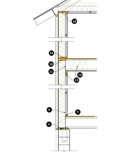

Sounds like a candidate for a solid ground floor to me. If going timber floor though...sit the walls on the footings; run the airtightness layer down the wall, then hang the joists off the wall or sit them on the footings? This is less of a cold bridge than running your joists through the wall. Ditto at first floor level with ledgers; flipping your airtightness layer over the top of the header plate (on the ground floor) and under the sole plate (on the first floor) to keep it contiguous. The platform framing approach (with joists sat on top of footings and wall sat on top of joists) was used before the days of structural screws / joist hangars / airtightness etc. http://blog.lamidesign.com/p/swedish-platform-framing-info.html
