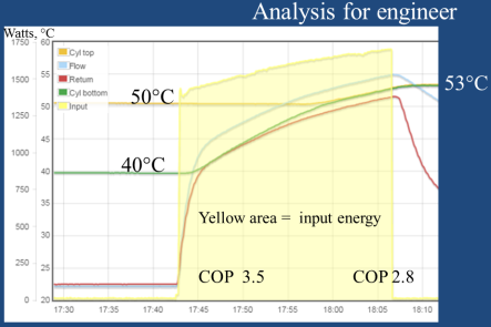

  2. So: Normal: no limit on compressor Balanced: limits max compressor to 50% for finish-heating Eco: limits max compressor to 50% The unit is choosing to run up to that 50% limit though; irrespective of cylinder temperature and the target differential. The latter is confusing. Perhaps it will behave differently charging a "25C" cylinder and a "40C" cylinder and a "50C" sylinder in ECO mode? Are you sure that it's reading the fake cylinder temperature correctly? Perhaps it assumes use of a 3 m2 coil (or equivalent) and it only really controls to the target differential when in normal mode?

  10. The ASHP can control: - Compressor speed - Circulator speed - Fan speed (ignore for now) It can control compressor speed and circulator speed to achieve the target operating temperatures. If these are infinitely variable then happy days the AHSP can do what it likes. Perhaps the heat pump attempts to reheat the cylinder at a set power (essentially a set compressor speed) but even on ECO mode (minimum compressor speed / longest reheat time) the available turndown is limited. Tech specs on Mixergy are difficult to find on their website. Via Google here's their external plate kit to make the cylinder compatible with heat pumps. With the plate heat exchanger it can support 4-7 kW input with an incoming flow temperature of 60C and the cylinder at 55C. The returns from will be somewhere between 55 and 60C. https://www.mixergy.co.uk/wp-content/uploads/2021/11/Mixergy-Heat-Pump-Kit-Installation-Guide.pdf I couldn't find an equivalent specification for the coil in a standard cylinder; but I would guess that it is materially lower than this. The effect of this would be that even at minimum turndown / minimum modulation you're seeing a deltaT (from coil:water) of 10 degC and this is in fact what's dictating flow and returns of 67/62C in ECO mode; not the flow temperatures that the heat pump would like to operate at. Bigger coil fixes this BUT in order to get that bigger coil you're probably reheating the entire cylinder at once. (or fitting the PHE that is effectively the same thing and supports a worst case scenario of 5 degC average primary water to potable water deltaT)
  11. Interesting pairing of equipment. I think these two issues: (1) The (shorter) Indirect coil at top of the tank means return temperatures are higher than with a standard HP coil lower down in the UVC. The higher return temperature pushes up flow temperature (which is not constrained) as the ASHP attempts to maintain a [flow temperature that tracks the gradually increasing cylinder temperature] (2) The ASHP doesn't see the UVC temperature increase over time (it's fixed due to resistor switch), so the ASHP [ratchets up the flow temperature to try heat this cylinder that is apparently being drained so fast that it cannot be reheated] You will achieve the highest COP by heating the entire cylinder from cold to hot "in one go" at as low an average temperature as possible, vs incrementally heating a cylinder from full cold to full hot "a bit at a time" at the maximum temperature. In a "standard" cylinder for heat pumps (with a ruddy great coil from top to bottom) the heat pump sees cool water that warms up as the cylinder warms. If it is DUMB them it runs at a fixed temperature. If it is a little smarter the heat pump can set flow temp = 10C above return temp (or some other number that achieves a reasonable power input / reheat time) and up the temperature gradient it runs until the cylinder is satisfied. If the heat pump is bit smarter again it can, if tsenses that he cylinder is already part heated, always run at a minimum of say 50C output in order to avoid cooling the top part (that's ready to use) whilst it's heating the bottom part. If it is REALLY clever it will have a desuperheater on it to top up the cylinder whilst providing space heating. The "mixergy" coil is configured for heating a cylinder "a bit at a time" from a heat source that doesn't much care about temperature. It's the total opposite of what you want for a heat pump. If you do everything that you can to minimise this stratification and heating in parts - i.e. defeat most of the purpose of the mixergy tank except for the inlet diffuser - then you will maximise heat pump performance. I don't think these are remotely appropriate for use with heat pumps myself. Your heat pump is going to do "whatever it wants to" in order to achieve a tank at the target setpoint - in your case 55C. It has two ways to see what the temperature is. (1) flow and return temps from cylinder primary (2) temperature probe on cylinder I would guess that is is kinda smart. If given a totally cold tank it would ramp the temperature up at return + X degC until setpoint achieved to maximise efficiency. If given a part warm tank it would ramp up at return + X degC, subject to a minimum of say 50 degC so that it doesn't discharge what's already at the top of the cylinder. It will use (2) to decide when to stop and (1) to decide what temperature to use. If the heat pump were DUMB then you can set it to X and rely on an external contact. X is 50C for slow reheat to 45 or 65C for faster reheat to 55C etc. The Arotherm is probably too smart for this application. Try heating a stone cold tank in ECO mode and watching the flow tempeatures? If that works then you know the issue. The Mixergy tank, unless the smarts are defeated, is going to cause problems. You're trying heat the cylinder from full cold to full hot "a bit at a time" as it were. This will result in fairly high return temperatures to the heat pump and the heat pump thinking that the cylinder is almost fully heated. It is logical for it to increase the setpoint in this scenario. You don't have any way to recreate the effect of a "top to bottom" coil. Running a destratification pump to try mimic the effect of a "top top bottom" coil will blend the tank temperature; improving heat pump performance; but killing the "hot top" that you get with a heat pump tank. Running the water through a plate is more flexible but ultimately has the same drawback. Low flow through the plate means "heating a bit of the tank from cold to hot in one go" whilst high flow through the plate mixes up the entire cylinder and loses your "hot top" again. Perhaps set to space heating mode to make the setpoint dumber and allow mixergy to control it? Swap the mixergy tank for one that's more suitable?

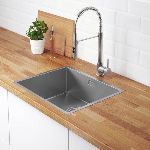

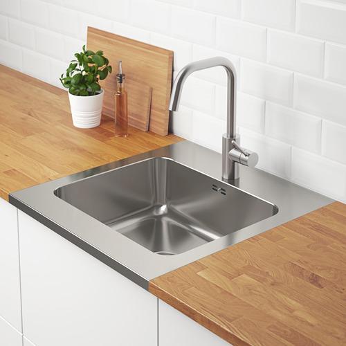

  14. Underslung is going to restrict worktop choices more - that might not be in my remit. The other option would be carefully (!) routing out a rebate in the [laminate] worktop to take a sink with a "flat" rim and bedding it on goop such that the top of the sink were flush with the worktop. Something like this: chosing IKEA because convenient for examples) https://www.ikea.lt/en/rooms/kitchen/kitchen-taps-sinks-and-sink-accessories/kitchen-sinks-and-sink-accessories/norrsjon-inset-sink-1-bowl-spr-49157909 Mask the worktop. Router the rebate to say 6 mm depth if the sink edge is 3 mm thick and make the rebate say 3 mm larger than the sink all round. Cut the hole for the main sink body. Attach something to the top of the sink so that it cannot fall too deep into the hole (i.e. so that gravity would hold it flush with the worktop). Goop the rebated edge thoroughly. Mask the edge of the sink. Drop the sink in hole, wiggle into alignment so that there's a consistent 3 mm border around the sink. Wipe, wait, unmask. Hopefully the sink is now flush with the worktop and sealed. Feels ambitious for a laminate worktop not turning to weetabix. Might work well for a wooden worktop? Is there anything special about CT1 vs other "MS Polymer" sealants/adhesives? (CT1 isn't sold here) http://www.soudal.eu/soudalweb/productDetail.aspx?w=9&p=231&ID=1905 https://www.toolstation.com/soudal-fix-all-crystal-adhesive-sealant/p61251 https://www.ermitazas.lt/Statybines-medziagos/Sandarinimo-montazines-priemones/Hermetika-montaziniai-klijai/Klijuojantis-hermetikas-SOUDAL-FIX-ALL-CRYSTAL-bespalvis-290-ml-131091.html

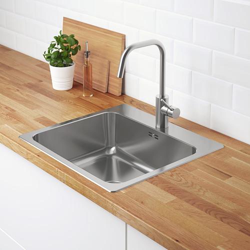

  15. This is standard sink: https://www.ikea.lt/en/products/kitchen/kitchen-taps-sinks-and-sink-accessories/kitchen-sinks-and-sink-accessories/langudden-inset-sink-1-bowl-spr-29157477 The edges are annoying if you like to sweep crumbs into the sink from the worktop. This is a sink that replaces a chunk of worktop: https://www.ikea.lt/en/products/kitchen/kitchen-taps-sinks-and-sink-accessories/kitchen-sinks-and-sink-accessories/ammeran-onset-sink-1-bowl-spr-59158164 Those edges could be flush with the worktop. Ordinarily you'd silicone that gap. Silicone is rubbish for longevity though. Scrub it unsympathetically and it will peel. Is there anything else that can be used? Might an epoxy grout do the trick?
