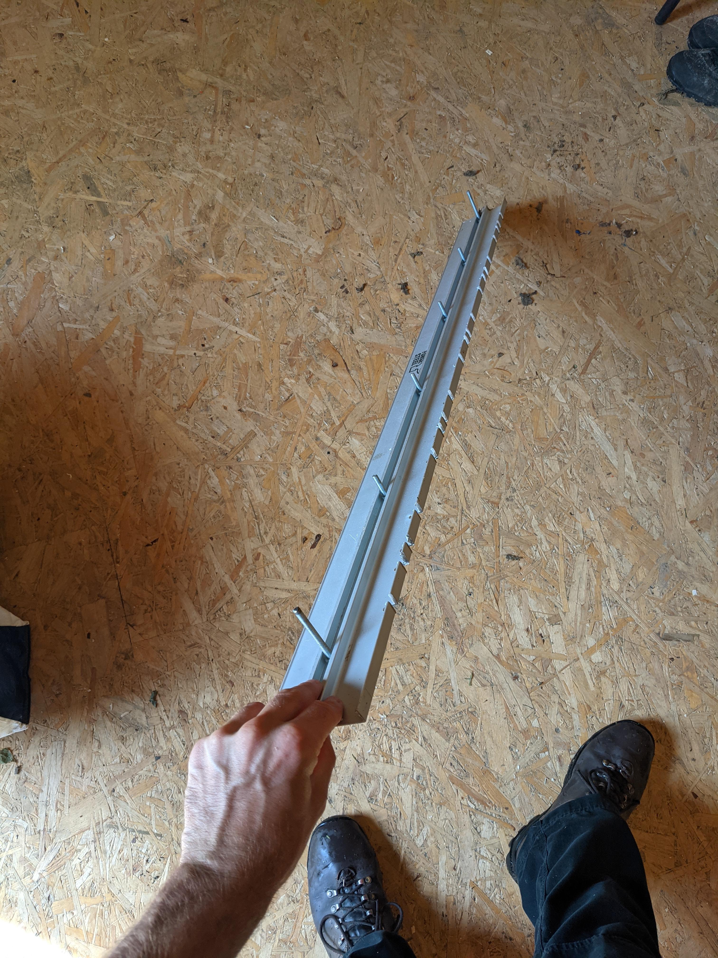

  2. M6 bolts through a piece of alloy channel spaced so that they pick up one edge of each board. Outer two long enough to sit on batten. Inners only touch boards. Drill holes for screws then slot to outer edge.

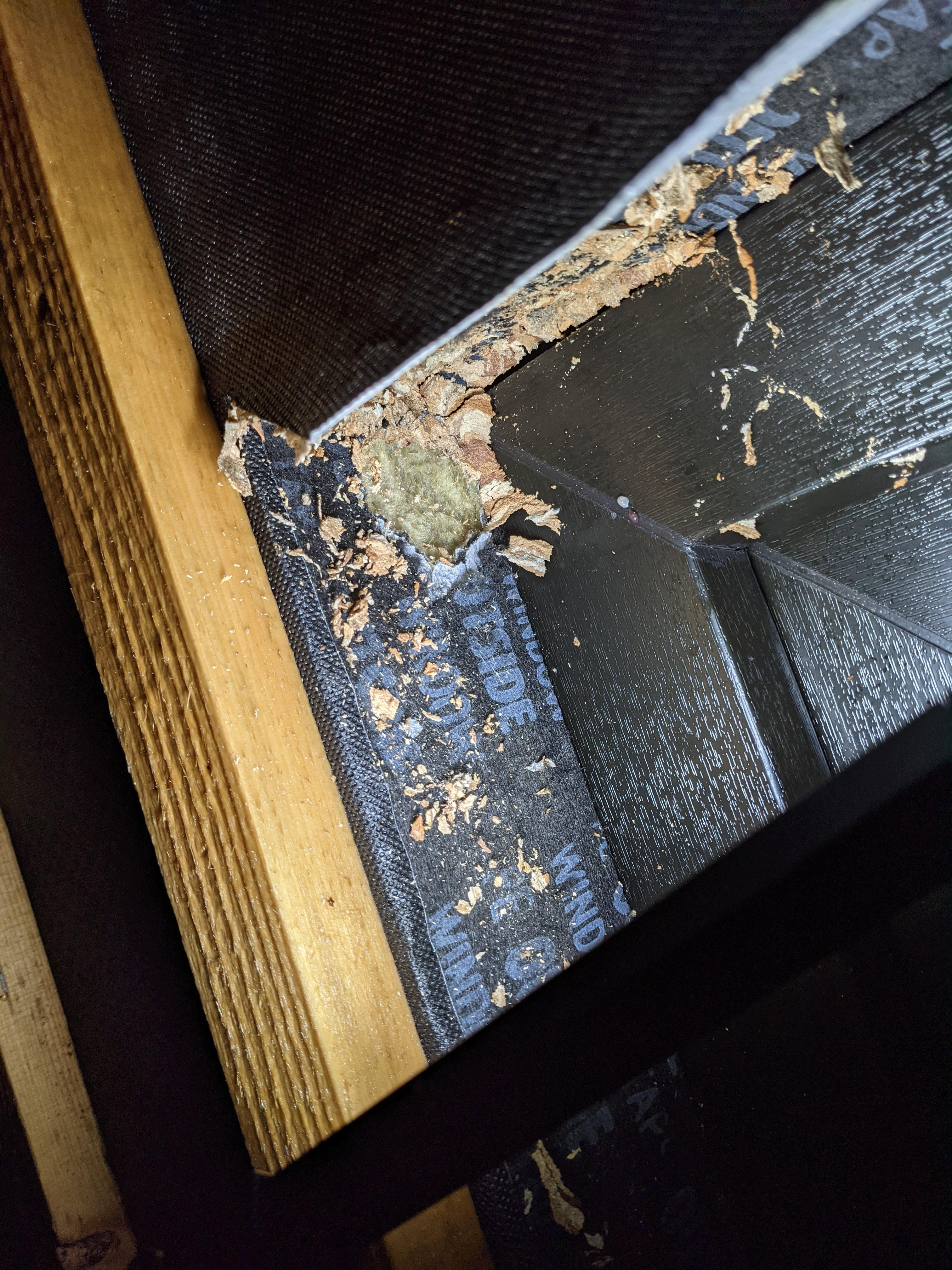

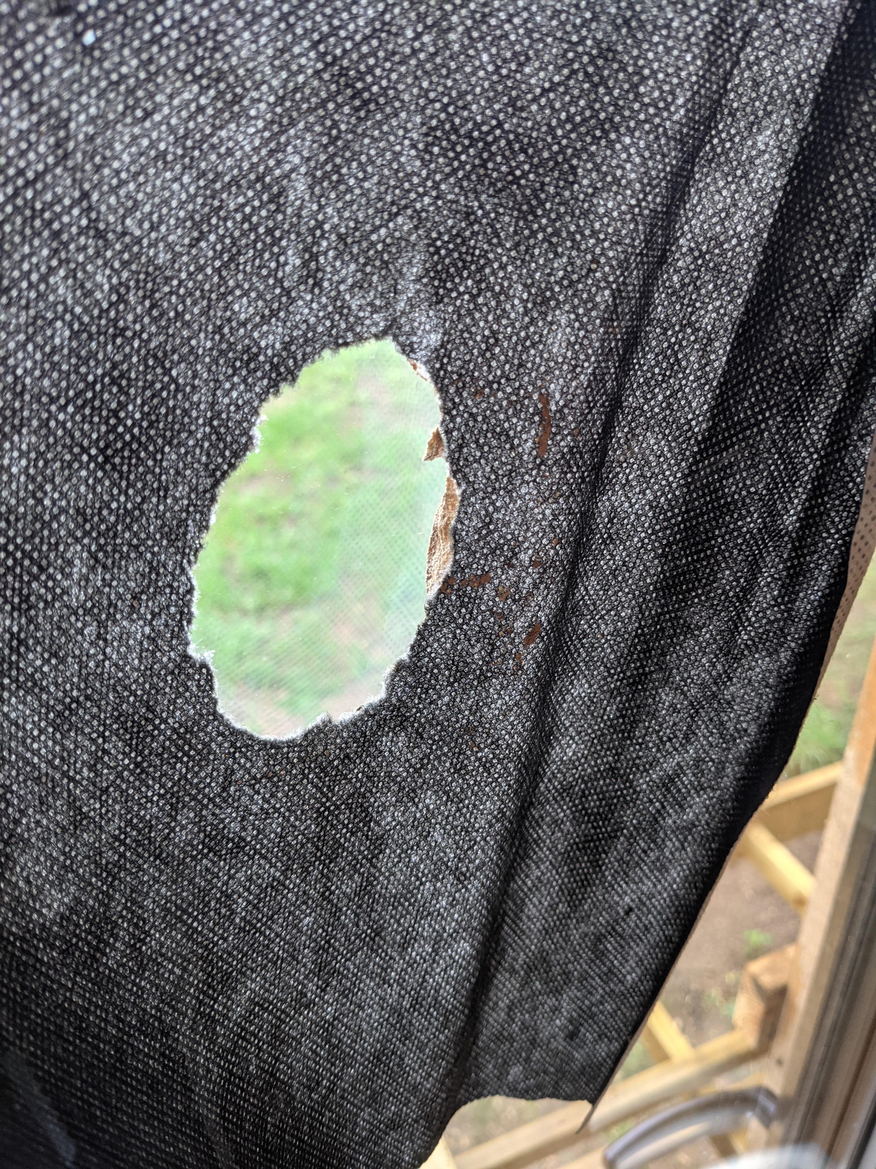

  3. These were hornets (yay) but wasps do the same
  4. If the bees do come you can say bye bye to the membrane...

  7. For what it's worth we found fixing one end then moving (hoiking) the free end about and fixing in every batten on the way helped to tame the banana boatds into straighter lines. Small gaps are a swine though! Jig to sit on the battens (hooking through gaps with small bolts) helped align screws where eyeballing through gaps isn't viable / borrowed helpers can't eyeball for toffee. Will try to find a pic!

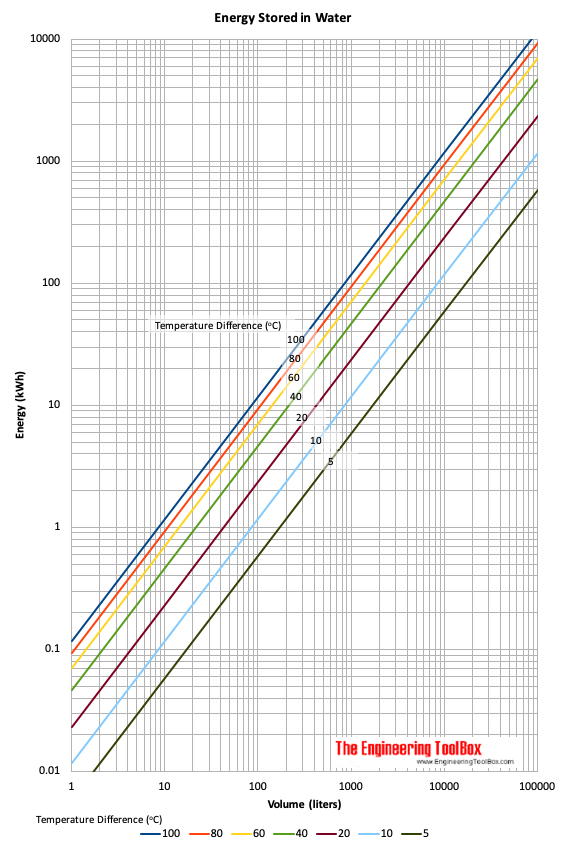

  11. Joules per kg per degree Kelvin. E = m (CP) dT https://en.wikipedia.org/wiki/Specific_heat_capacity Or: 100 litres gives ~2.5 kWh for a 20C temperature rise. Many heat pumps ask for a minimum (directly fed) system volume to use as thermal mass to minimise cycling. This can be substituted for screed to a degree. The thermal mass of radiators and pipework can be ignored here. (minimal compared with the water)
