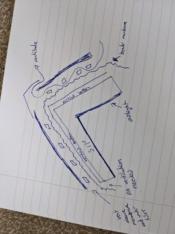

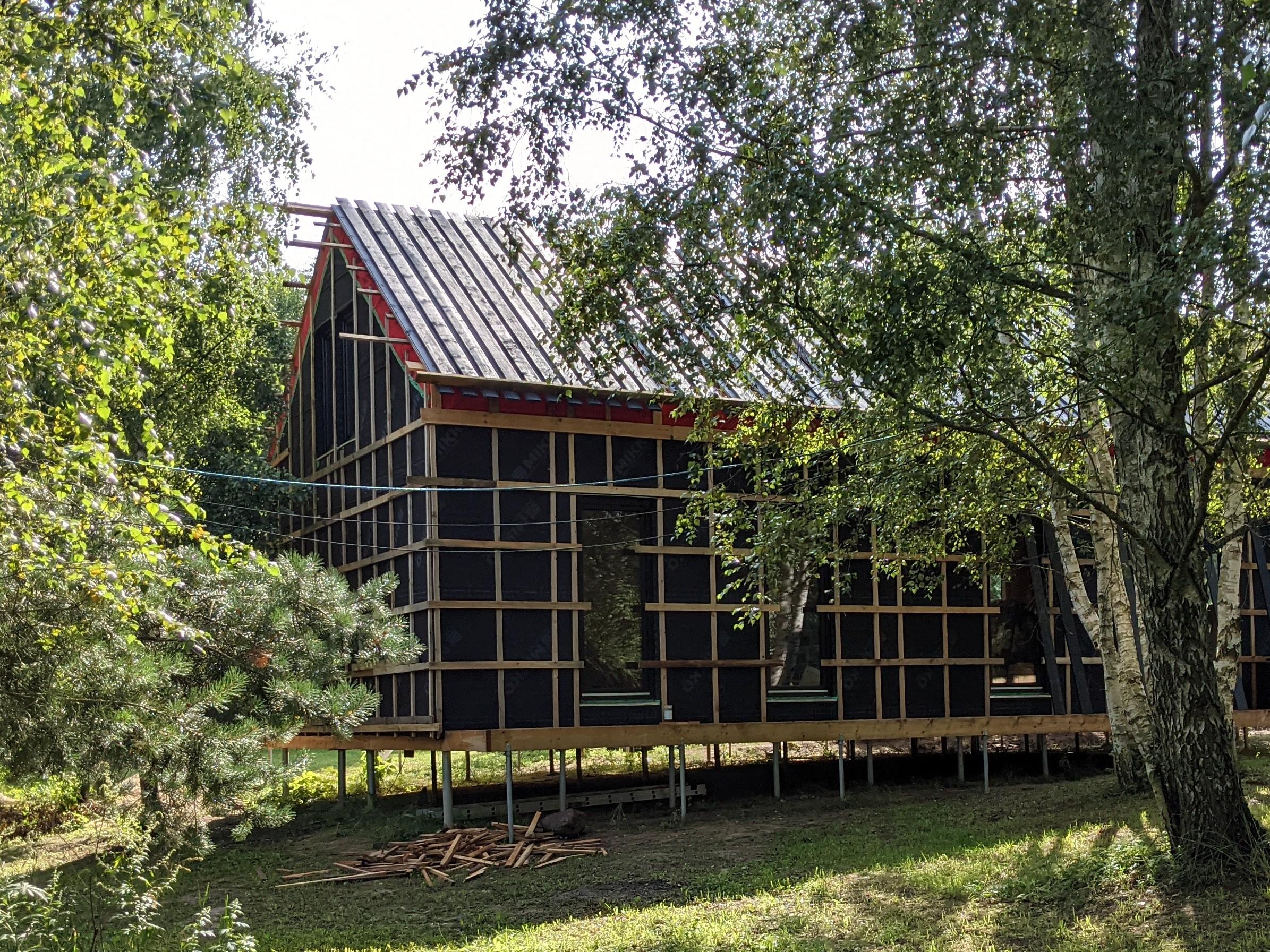

  1. This useful? https://www.wienerberger.co.uk/content/dam/wienerberger/united-kingdom/marketing/documents-magazines/technical/UK_MKT_DOC_TEC_ROF_SAN_Dr_John_notes_roof_space_vent_001.pdf You're a sip structure? Therefore it MUST be well sealed warm roof so that the SIP doesn't turn into wet Weetabix Therefore the breather membrane that you have already that's lapped over the top is sufficient. And in theory no ventilation whatsoever if the roof can breathe (e.g slates with gaps not a standing seam metal roof) unless you're trying to keep the roof cool enough to avoid ice dams (in which case steep roof and lots of breathing above membrane and out of the ridge, and try to avoid breathing in warm air from walls that are heated by the sun etc) If you propose having another membrane above sarking, then battens, the roof finish, with all ventilation above the second membrane, then it's fine to lap this second membrane over the ridge just above sarking. When we were looking at SIPs the detail requested was a breathable membrane over the sip (one suitable for direct contact) right over the ridge; then vertical battens; then either counterbattens and standing seam or counterbattens and tiles or OSB and asphalt shingles etc; with ventilation between membrane and the roof finish at eaves and ridge levels. No additional membrane above this. The SIP folks would provide said membrane held in place with the vertical battens. I don't see why you'd have a second membrane of this is effectively what you have. Tiles and ridge just go on. Sarking kinda overkill given that there's already OSB there for shear strength in the roof unless I'm missing something? PXL_20210822_114836179.jpg

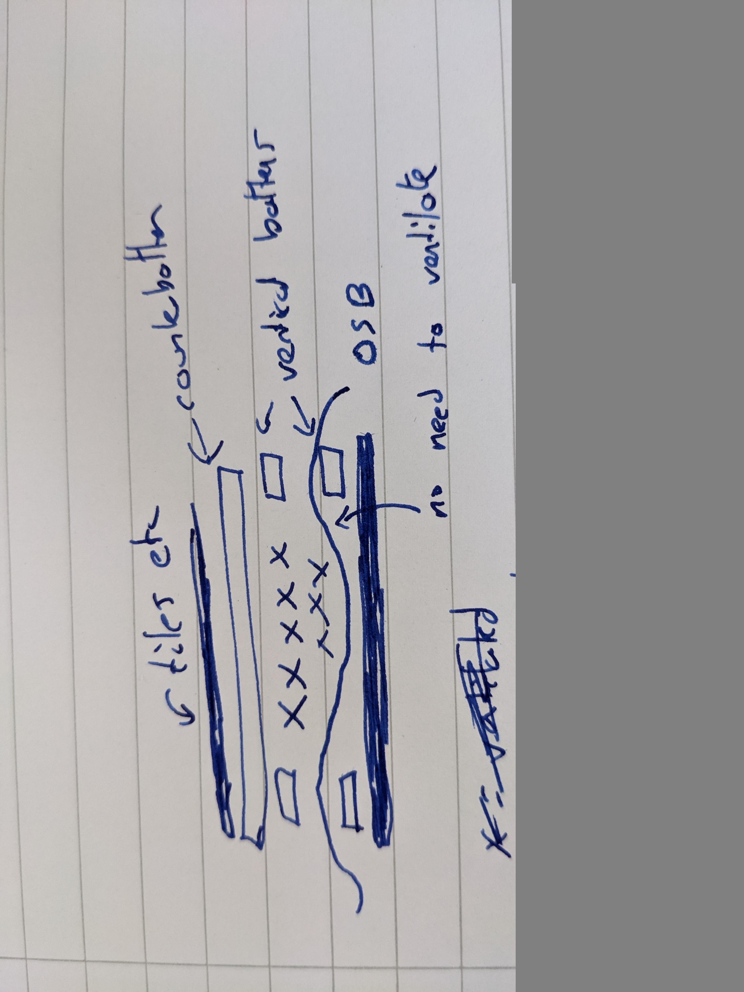

  2. sketch of what I had imagined the layup to be

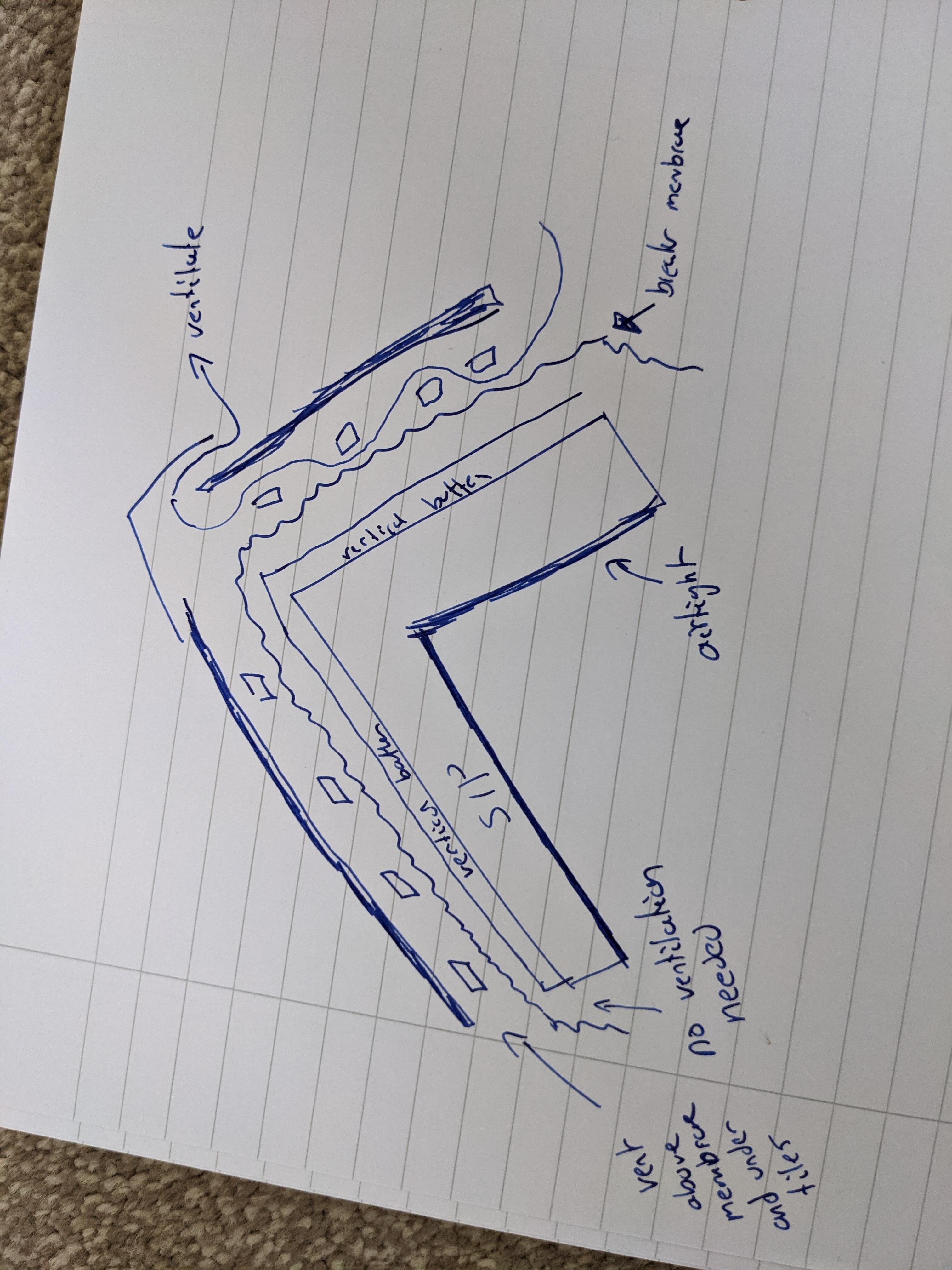

  3. Just looked at photos and see that my advice might be unhelpful. I imagined a membrane on the sip for water shedding purposes - draped between vertical battens so that water doesn't pool on your battens - then vertical battens on top of that plus horizontal counterbattens and a roof cover. You wouldn't vent under the membrane. (So no cut at the top) I think you *would* vent on top of the membrane (and out through ridge) though. Are you imagining a second membrane here? I can't see why you would be asking about cuts otherwise.
  4. You should not have lots of warm moist air coming through your sip. (if you do then you have a problem - sip needs to be airtight internally to not transport a bucket load of moisture into three OSB) Your structure should be less vapour permeable inside (vcl) than it is outside (membrane). So that it dries out much much faster than it gets wet. If moisture did get through the OSB then it should be allowed to escape more easily through the membrane than it is to get through the OSB (it will be, unless you're using plastic sheet as a membrane) If water comes through the roof covering it shouldn't get to the sip. (Which it won't as the membrane is breathable but waterproof) So I'd say: Don't worry about ventilation between sip and membrane. (so no cuts where I think you're asking about cuts - membrane is continuous from eave to eave and any moisture under it...breathes through it...non issue) Do worry about ventilation between roof covering and membrane. (so vented ridge) Answers world be different if the membrane wasn't breathable. Then I'd say good need to vent it with cuts at the to. Be thankful that you're not in ice damming areas: https://www.buildingscience.com/documents/insights/bsi-046-dam-ice-dam

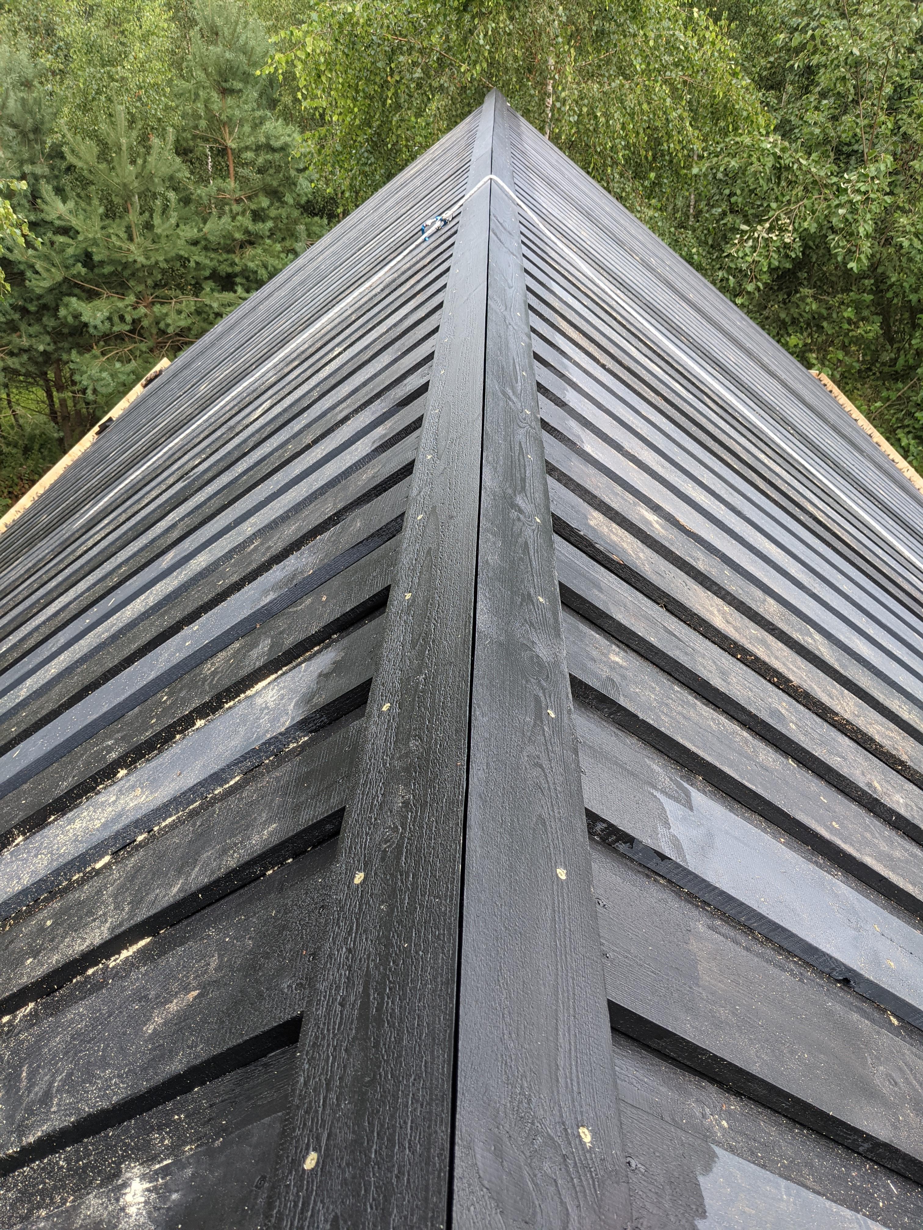

  9. Pleased with how the ridge turned out at the other end. I was dreading fitting "6 metre ridge tiles" but they lined up great in the end. ? Yes rope for getting up to the ridge. Harness too. (save for the no tools photo) Scaffolding that would be epic; ladders are dangerous; spider rig would be amazing but haven't seen them locally.
  10. Spider access platforms look awesome! (not seen those before) I've had a play at ground level and decided that I'm more afraid of the circular saw than the gravity. The difficultly in cutting these ends are: (1) there's nothing flat to run the saw shoe over so you're liable to tip the nose of the saw shoe into a valley or are trying to hold the saw in mid air...unless you add some hardboard "rails" to smooth out the gaps (2) there's some force in there from me strong-arming the banana wood where I want it that gets released as you cut and wants to throw the saw at you (3) you'r working backwards in that either the main body of the saw shoe is on the "keep" side but you're staring at the "discard" side of the saw when running it (reaching over the blade) or the main body of the saw shoe is on the "discard" side and you're again trying to hold the saw in mid air (running a narrow strip of the shoe against the keep side...unless you deliberately cut the roof in sections and have some sort of support to hold the saw Therefore: Circular saw...and a track to run it along that can span say a metre...so that you can run the main body of the saw shoe on the "discard" side without worrying about the saw wobbling left/right or the front of the saw shoe dipping into the "grooves" in the roof. Clamp some temporary 70x25 mm battens into the roof "grooves" to support the track. Cut the roof boards between the battens. Move on. And do this from the wall side rather than the roof side. I don't think scaffolding. Not worth the hassle of getting it to the forest vs making a quick "clip on balcony" from scrap and hanging it from the wall. There's a 150x25 mm "batten" at the top that's fixed to each stud with a 6 x 140 mm screws (for carrying the weight of the wall cladding - more than enough for a person) that runs the full length of the roof.

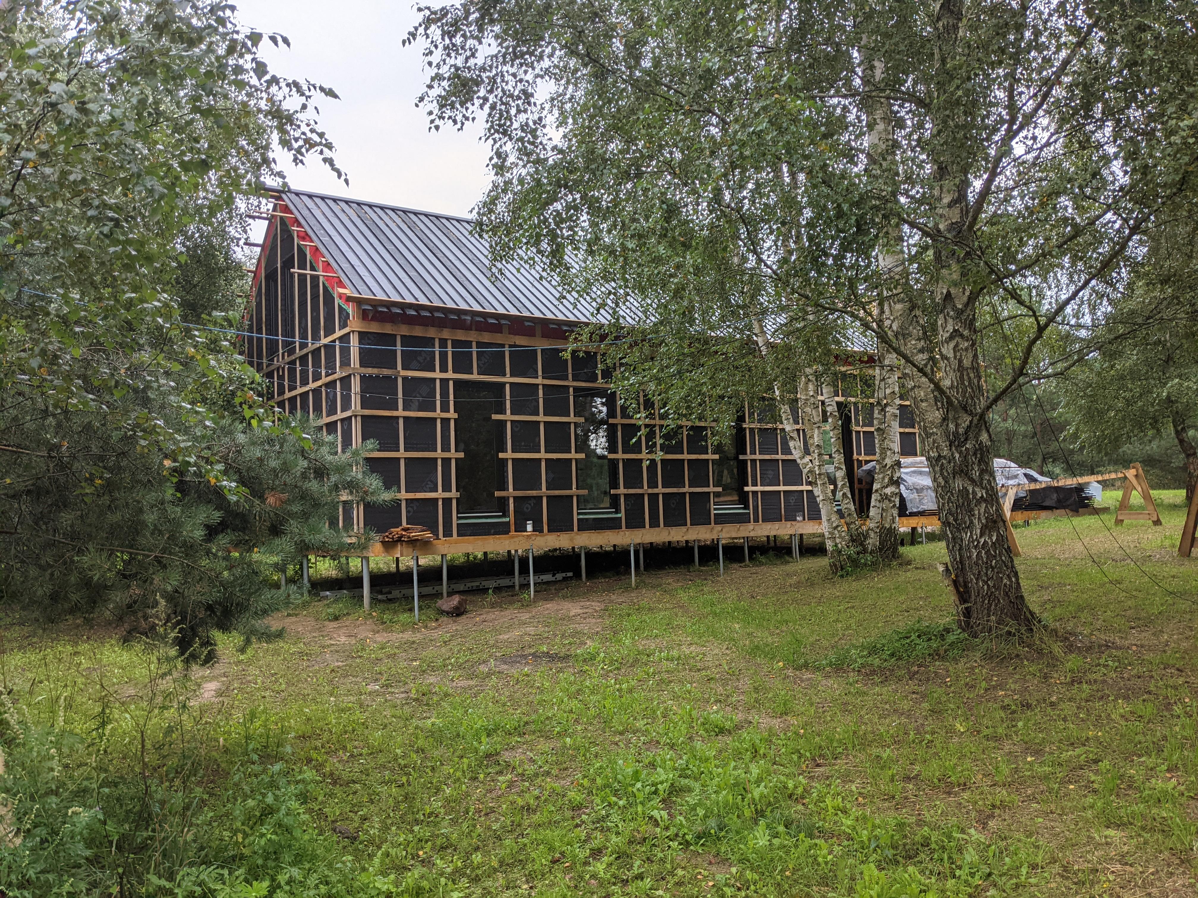

  11. It's been a tricky year to be building in wood! Especially if you'd planned timber frame with timber exterior wall cladding and timber roof covering and timber ceiling covering and timber floor covering and a timber deck ? We gave up and are leaving our deck / south wall / similar but less grand open gable unfinished until 2022. The sawmills (in Lithuania anyway) think they will have "satisfied all the silly priced futures contracts" by then. Prices won't go back to 2020 levels though. Maybe only +50% rather than +200%. Here's that miscellaneous teak from the shed FWIW - you should get a trade discount on top of that for tradepoint or visiting on OAP day with a borrowed granny etc. Go crazy bold and thin coat solid colour render onto the OSB? In all seriousness if you can wait I would wait. September futures in the US (which is where all the Euro wood went earlier this year) are down again https://www.bloomberg.com/news/articles/2021-08-11/lumber-falls-to-nine-month-low-extending-retreat-after-boom
  12. I wanted to draw a design, have it made accurately, then plonk it onto foundations with no mucking about on site. Call it a over reaction to having had to deal with badly built brick houses where nothing is square or level and you're forever mucking about making things fit well. The more I read on SIPs the less they made sense though. The vapour resistance of the outside is the same as the inside. (Both OSB) The weak paths are the joints. Any airflow or vapour movement through that structure is going to go through the joints. The worst place to have moisture in OSB. If you're VERY good on air tightness - assembling carefully and adding a membrane to the inside of the SIP that you're religious about protecting - and you build a secondary structure outside the SIP (battens, breathing membrane, battens, cladding of some kind) then they work. Price that up and you might as well panel build or even stick build though; and if you go for those routes then you ends up with a structure that's far more resilient to minor f**kups and viable to repair too. The better SIP vendors even said as much. "Our price is supply and erect and includes battens, membrane, and battens over the sip. In the early days we did supply only but people always screw up airtightness, the ridge always rotted first (highest driving pressure for moisture from inside/hardest to fit up tightly), and we got fed up of the warranty claims. If anybody says you can render the outside directly and bash some shingles on top then run a mile!" (or words to that effect) Advantage of the SIPs was speed. (up and watertight in days) We found some framers who were framed, insulated, and watertight in 5 weeks. (and built in snow season rather than rain season) If the choice was panel or sip then panel every time.

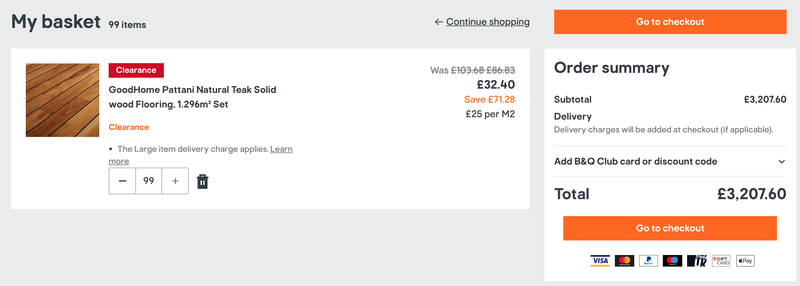

  13. One could still 'cheat' though? As in it doesn't need to be thermopine or similarly stable it just needs to be look good? Indoor grade flooring as soffit? Glue and tack to OSB? Speedboat style random length oiled teak 30 Inc VAT at one of the sheds. Long bits for the big gable short bits for the regular soffits?

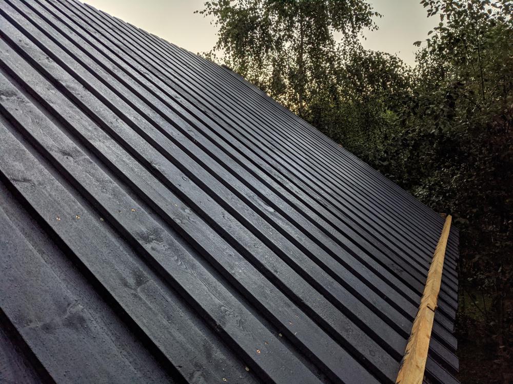

  15. Plain (ungrooved) decking boards? Light grey (white is never white) painted rough cut softwood? It's purely decorative and hanging off the underside of OSB, so you can use pretty much anything, no?

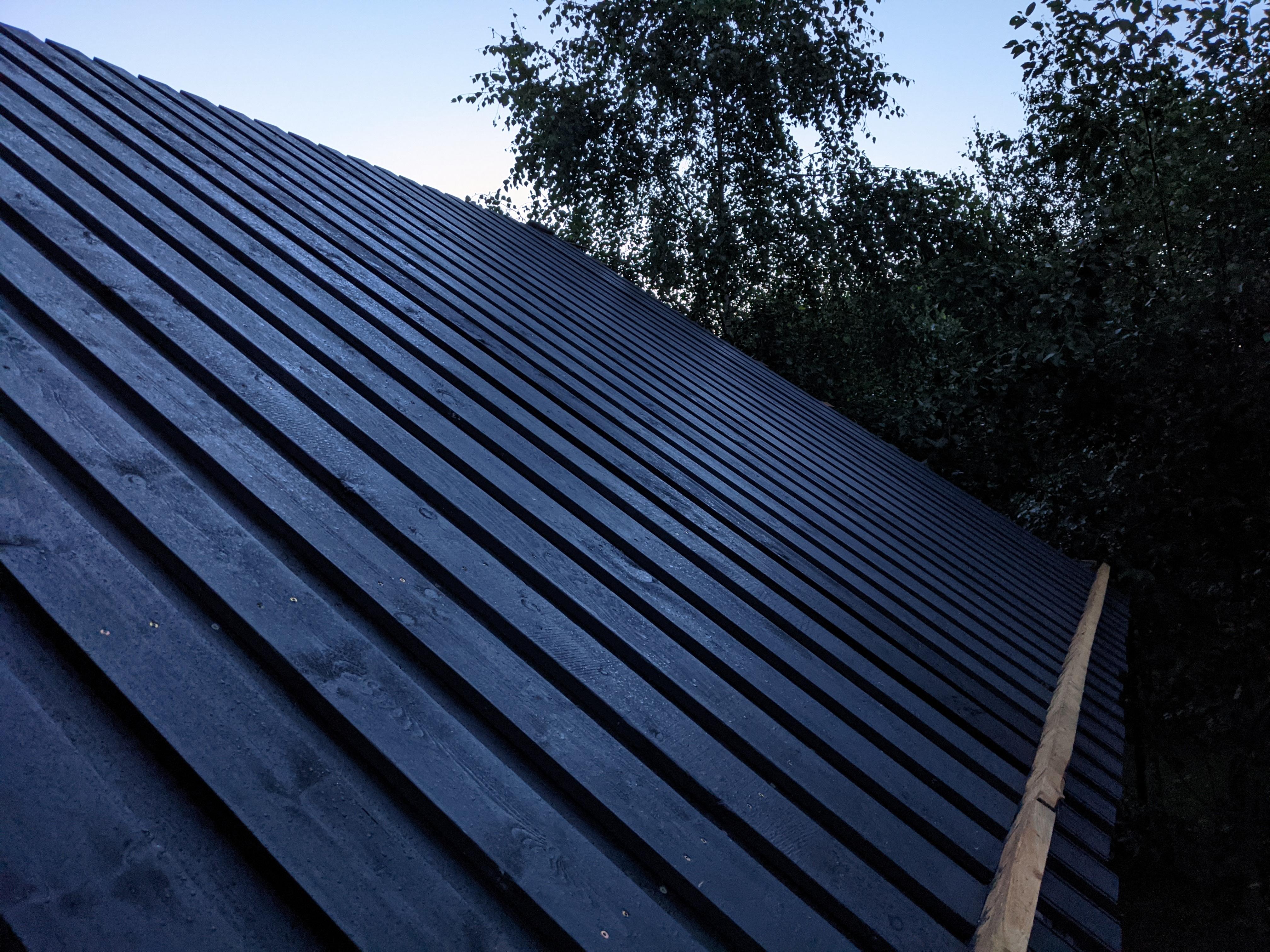

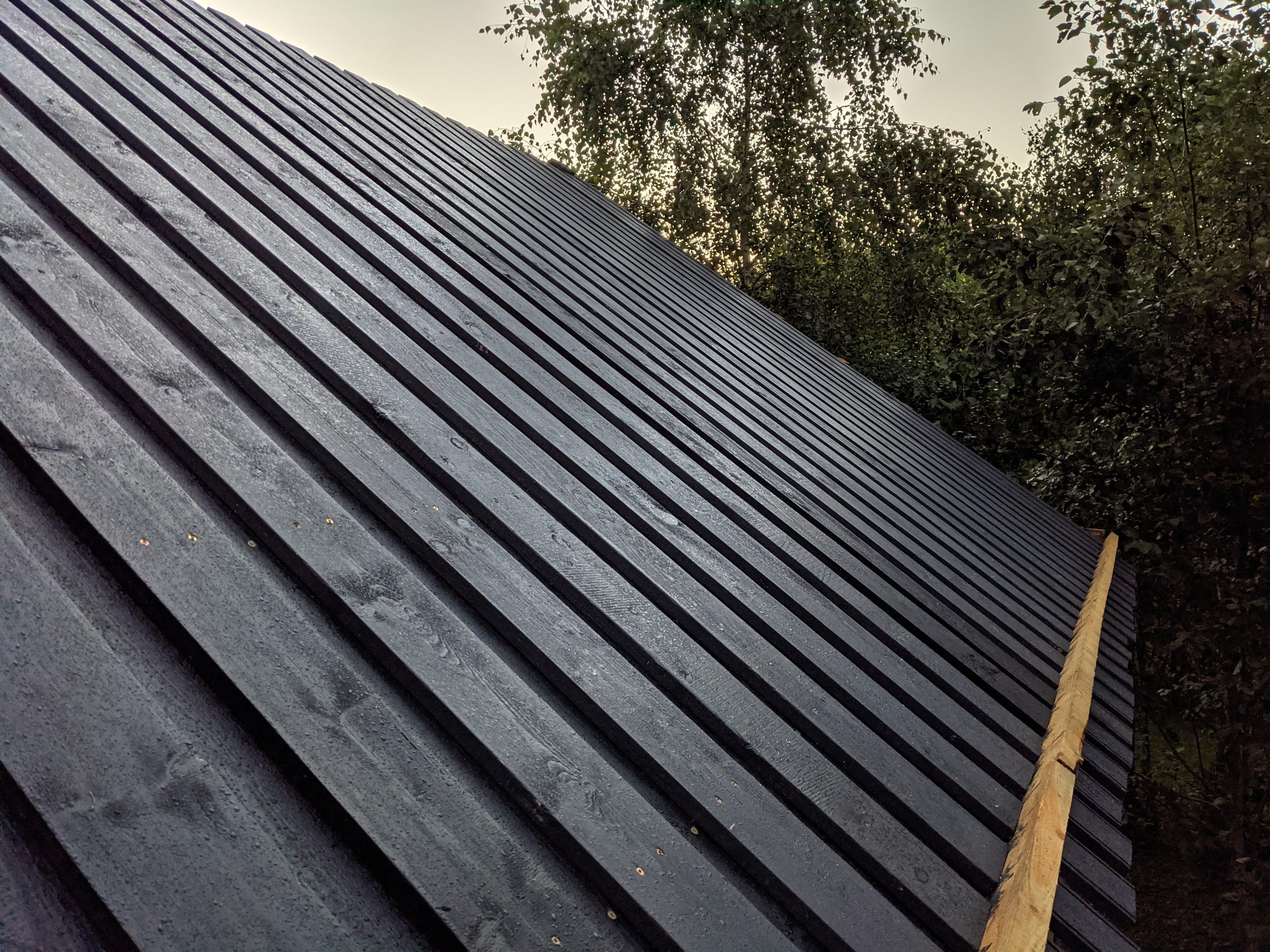

  24. It's a (board on board) roof. The timber does the same job as tiles. Back in the day there'd be nothing underneath. We've added a membrane just as you'd with tiles. Partly a quick way to get watertight. Partly to catch any wind driven rain or seepage through damage. The membrane isn't the primary waterproofing though. You've got to keep the timber dry (using pine tar in ye olde days, or acrylic paint these days) if you'd like it to last, so the coating on the timber is the primary waterproofing that you seek to maintain.
