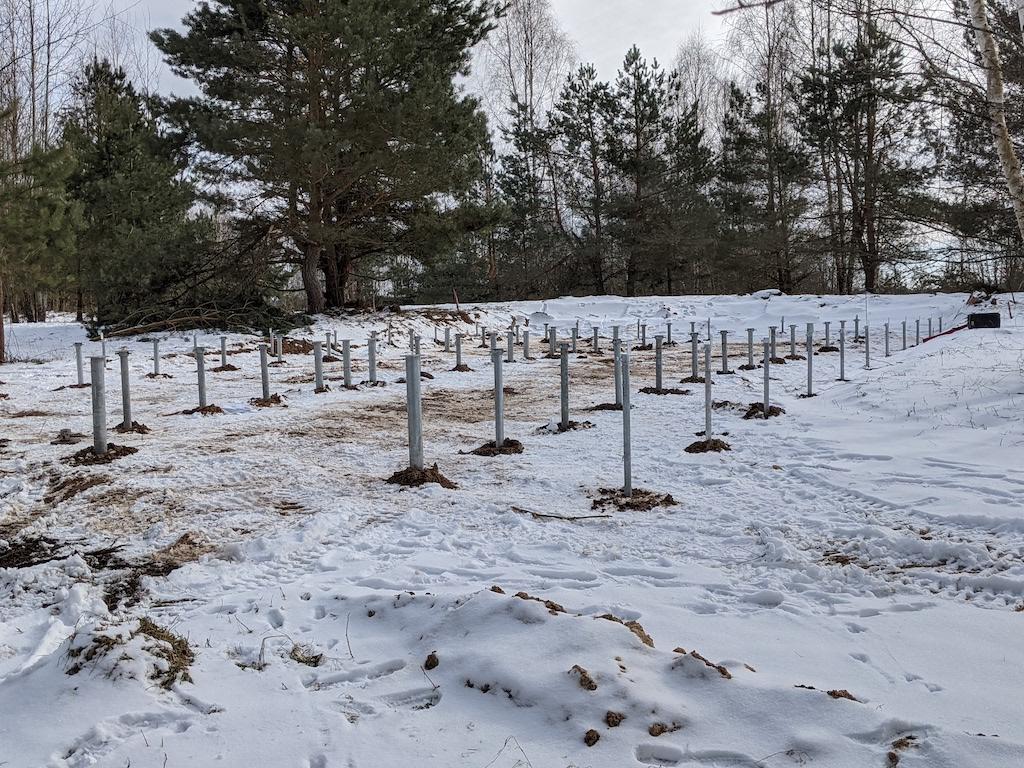

Concrete is reasonably idiot proof is why not; in the main part. And clay; clay is rubbish for bearing strength. And banks; banks want properties that remain saleable at any point during the loan period. Even if it's theoretically ok if they were worth zero once the loan was repaid... http://www.geotechdata.info/parameter/bearing-capacity 100 kPa means 10 tonnes per square metre. Or a 3.5 tonne transit van on a 60x60 cm paving slab. A few 60*60 holes rammed full of rocks happily carry 30m2. Spacing limit is probably how bendy your floor beams are.

I don't think you need strip foundations. Dig hole. Ram with rocks. Move over. 6-10 feet probably works best. Dig hole. Ram with rocks. Big rock or a block on top to finish. Build your frame up off of these piers. For single storey 30m2 it's very unlikely to blow away unless in an exposed area and made of nothing. Sand between joists for ufh would help see to that too. One could probably also use mud even. Nice clay bake! I don't think it needs ufh in a UK climate if the insulation is good though. Is it internal for area that counts for the 30m2 rule? So no incentive for thin walls where space allows?
